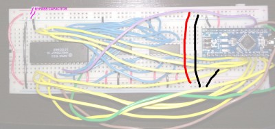

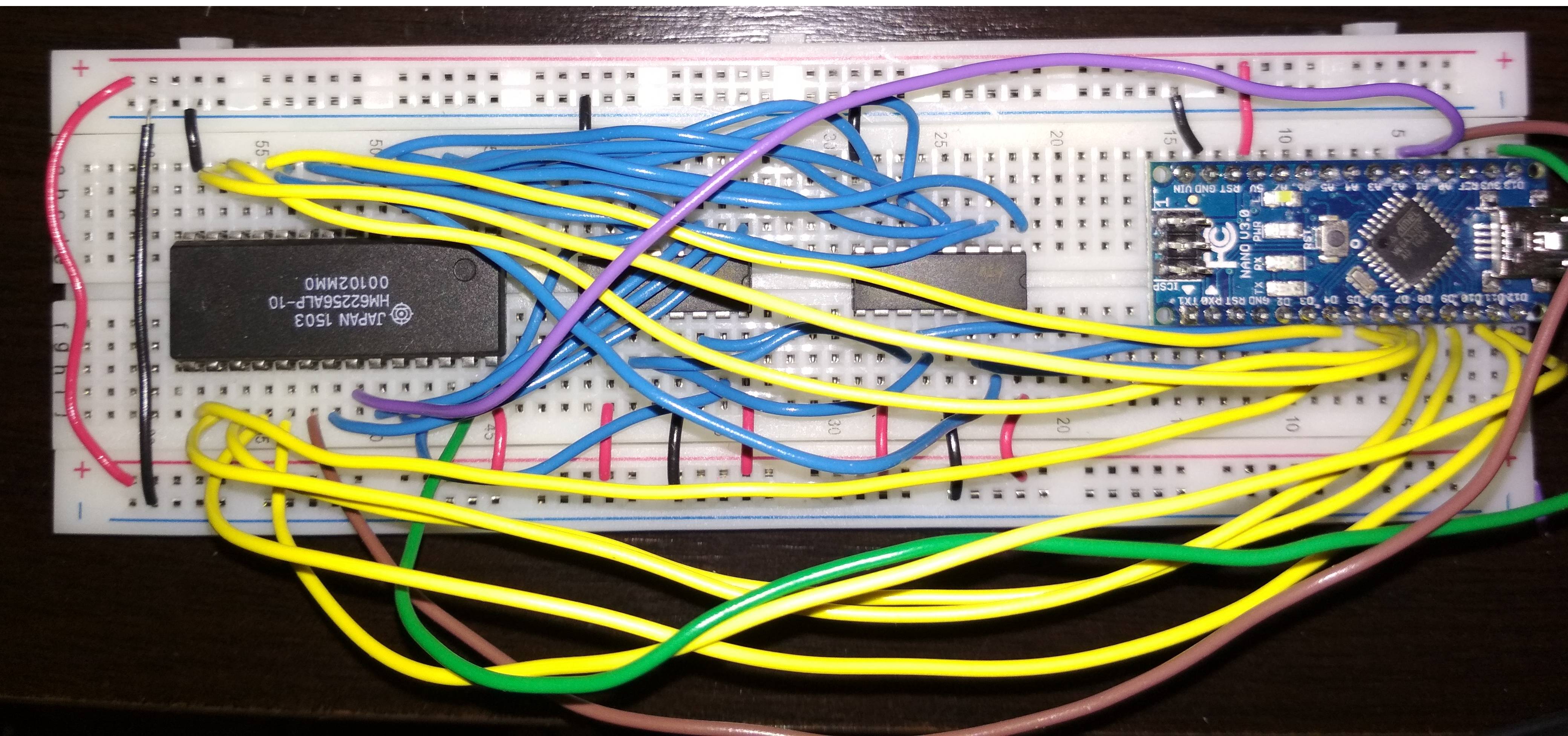

Greetings,
I am 19 years old and I have been interested in hardware for a long time, and for that reason I am now trying to learn more about digital electronics. I have a very strong interest in old computers(I even programmed a Pong clone in assembler for the C64), and for that reason I have decided that I wanted to make a 6502 computer.
As my first step, I decided I needed an EEPROM programmer. Since commercial ones are expensive I decided to make one with a couple of shift registers and an arduino.
After facing many difficulties with trying to write to a 28c256(and reading that it was very hard to disable the software write protection), I decided to first try to read and write to an HM62256(https://hardtofind.com.mx/pdfs/textos/H/HM62256A.PDF).
Even though this is supposed to be much simpler, I still was unable to write much of anything. After a few hours of debugging, I discovered that whatever input I gave to the OE pin, was mirrored in the A10 (If I gave a High signal to OE, A10 would output High, and if I gave OE a low signal, A10 would output low). At first I thought that the breadboard was perhaps shorted over these two rows, but when I removed the 62256, both signals were independent. I even tried a 28c256, and it also behaved normally.
I am also nearly 100% certain that I put the IC in the right orientation. This sram module does not have a notch at the top, but instead a small hole in the top left, which i understand should be at the top.
What could be causing this issue? Could the SRAM module be defective?
Here is a picture of my circuit, if it is of any help:

Can you tell us more about how you are using the shift registers? I assume they supply the address bits to the RAM, is that correct? Do they also supply the OE signal?

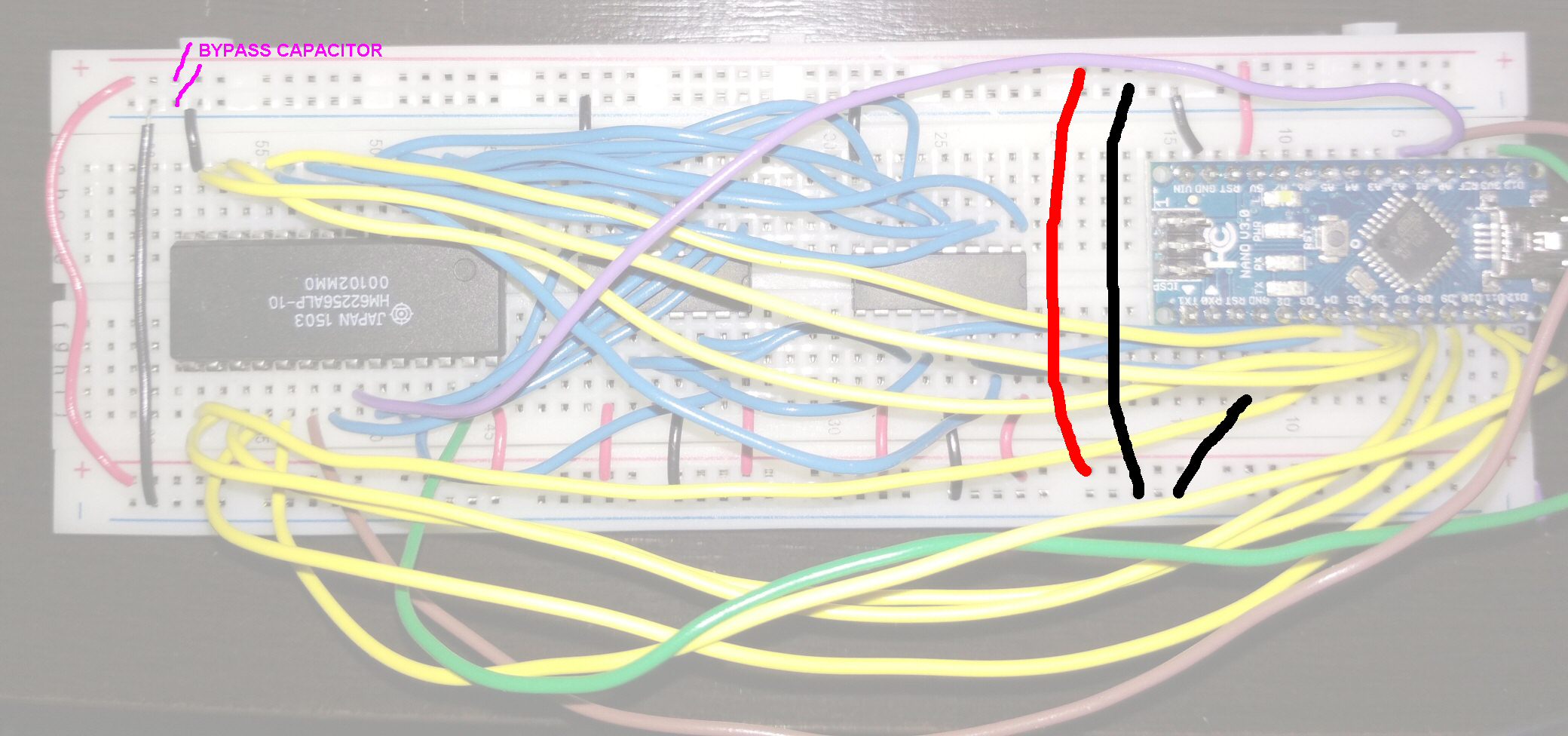

Also: although I doubt this directly affects the problem, your power supply wiring is poor, and could be improved (see image). I suggest you add extra conductors as shown to connect the upper and lower power rails together. Yes, they are already connected at the far left, but for IC's connecting to the bottom rails the path back to the Arduno is quite long, and wiring for digital circuits is best kept short. It's OK to have redundant power and ground connections. I notice the Arduino has a ground pin along the lower edge, so I tapped into that, too! :) Also you have no bypass capacitors installed. I've marked one of many possible capacitor locations.
Please answer regarding the shift registers. Better yet, can you provide a schematic?

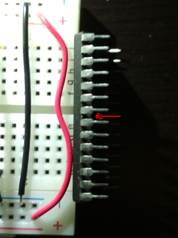

Those are pins 21 and 22, ie, right next to each other. If you look under the IC, do you see any solder splashes or anything else that could short them together? With the IC not in the circuit, does a DMM confirm they're shorted? If there were internal static damage, I suspect a pin would be shorted to VDD or ground, not a neighboring signal pin. There seems to be a growing problem of counterfeit, mislabeled ICs coming out of China, where shops pull ICs out of boards that are either used or for some reason did not pass production test, and they clean them up, sand the labels off and they print new labels on them to make them appear like they're something they're not, in order to make them more attractive.
Hello Garth, thank you for your response.
I've tested the resistance of the pins with a multimeter and I do get a reading, so it looks as though they are directly connected. I have also examined the IC, and I can't see any solder splashes. However, I can see a small metallic spot on the side exactly in between the two offending pins.
Do you think that this is a counterfeit? I could probably go to the store and complain.
This is a picture of the metallic spot I talk about for reference:

The shift registers only supply the 15 address bits, so that the last bit of the second register is unused. The OE signal comes from the A1 port on the arduino (the purple wire on the image).
Thanks for the advice! I will modify my circuit as you recommend. At one point i did have a bypass capacitor across the 62256 IC's ground and 5v. Do you think that is of any use, or should I just put my capacitor(s) on the power rails, given that I am using a breadboard?
My schematic is very similar to this one, the only difference being that I have direct lines to the arduino for the CE and OE signals:
https://github.com/beneater/eeprom-programmer
I didn't use the same code however, I wrote my own to stick as closely to the timings in the datasheet as possible (or as well as I could understand the timing diagrams).

I could be wrong, but I'd say the metallic spot has no significance. I suspect it results from the way the lead frame of the chip is manufactured, and is normal. But of course the chip still could be counterfeit, or damaged perhaps.

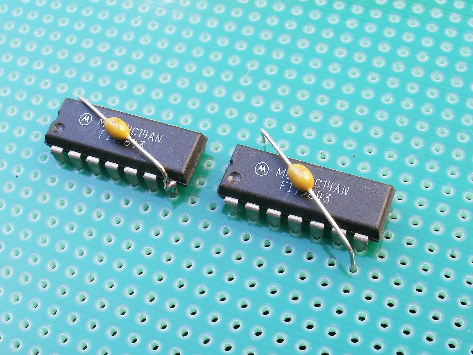

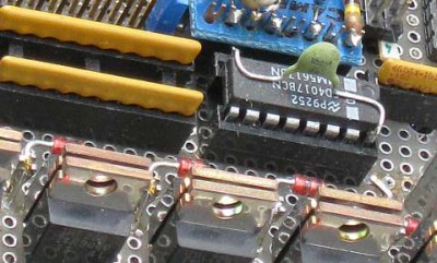

Probably it's most effective if the cap goes directly from ground to 5v -- diagonally across the chip, I mean. If you're careful you can solder the cap directly to the chip, and that's what will result in the shortest connections. But you could put a cap(s) on the rails instead, or as well. TBH, it's hard to know what will be "good enough." Some situations are quite forgiving; others are more critical. Caps are cheap, and fairly easy to put in, so it's silly not to have at least a few. One for each chip is nice.

Just as a sanity check, how does the reading from OE to A10 compare with the reading from OE to A11, say, or OE to any other address input? Can we say that the reading from OE to A10 is conspicuously different?
I've tested quite a few other pin combinations (though not all of them), and I don't get a reading at all, not even with 5v to ground. With A10 to OE, I get around 1.4 ohms.
Is it okay to solder directly onto the legs of the IC? Won't the heat damage it?
PostPosted: Mon Mar 25, 2019 2:46 am
Solater wrote:
Won't the heat damage [ the IC ]?
No, not unless you take a LONG time to do the soldering. A fine tip on the iron is helpful. And you want it to be fairly hot so the job can be done quickly. If you have any extra/worthless IC's around you can practice soldering on them.
Edit: I found a photo.

Edit 2: And here's a better photo. The leads have less unnecessary length (and this is assisted by the choice of axial-lead rather than radial-lead caps). In addition to the soldered version on the left, on the right we see an alternative arrangement intended specifically for wireless breadboard. It's easier, of course, though not quite as good as direct attachment to the chip.
Well, we don't know how it got that way, but that's certainly not right.
If you feel like fooling around, you might be able to permanently ground those pins and still test the circuit using only 16K of the 32K RAM. This will be a little tricky, but by observing the Truth Table for the RAM you could modify your program so that OE can be permanently low. But only if that seems like a fun challenge for you! And it might not work anyway if the chip is utterly dead -- or not even a RAM at all. If so, it's time to find a new chip. :|

I just went ahead and tied the OE and A10 pins to low, and now it works perfectly well! Looks like the chip isn't completely fake, it's just defective. I'll go ahead and let the people at my local electronics store know, and I'll get a new one afterwards.
