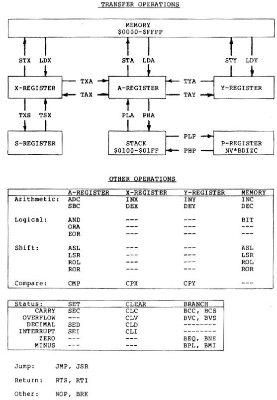

An interesting first-hand report! You only get once chance to come across something for the first time, so it's good to have some insight into how it comes together. I hadn't previously heard anyone say that about the status register, but it makes sense. It can be surprising how a skilled 6502 programmer can perform a calculation or comparison and then quite some time later, perhaps some distant part of code, perform a test which uses one of the flags that were set. The carry bit is sometimes used explicitly as a one-bit register.
I think many people - especially on this forum - would say the 6502 is especially straightforward to pick up. There are not many registers, not too many addressing modes, not much machine state to track.
There's a neat diagram by Bob Sander-Cederlof which I like a lot:
