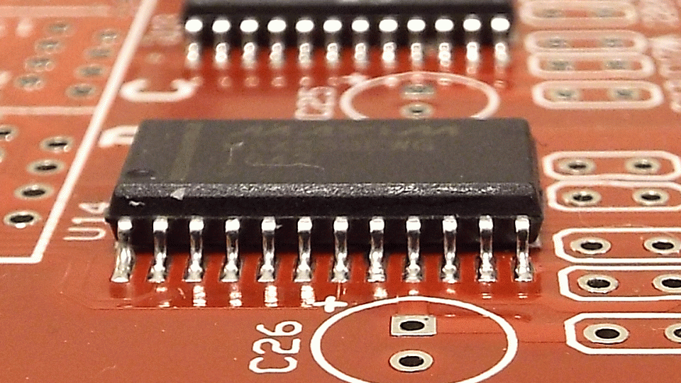

As I earlier said, PDIP is slowly but surely on its way out. Hardly any commercial products use them anymore, mostly because SMT parts are more economical in terms of materials and labor, especially labor. As the demand for PDIP diminishes manufacturers will discontinue them and it will be all SMT.
Anyone with reasonably good close-up eyesight and a reasonably steady hand can solder SMT devices. My POC units have some SOIC and SOJ parts, all of which were manually soldered. Here's a close-up of a MAX238 in a SOIC24 package on my POC V1.2 unit. SOIC is 50 mil pitch and as can be seen, is easily soldered.
File comment: MAX238 SOIC24 Manually Soldered

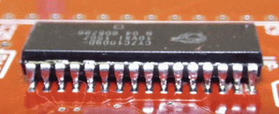

SOJ packages are similar. Here's a close-up of the SRAM on my POC V1.2 unit. It's in an SOJ32 package, which is also 50 mil pitch.
File comment: SRAM SOJ32 Manually Soldered
The really fine pitch stuff, such as TSOP, is more challenging, but hobbyists have manually soldered them.
