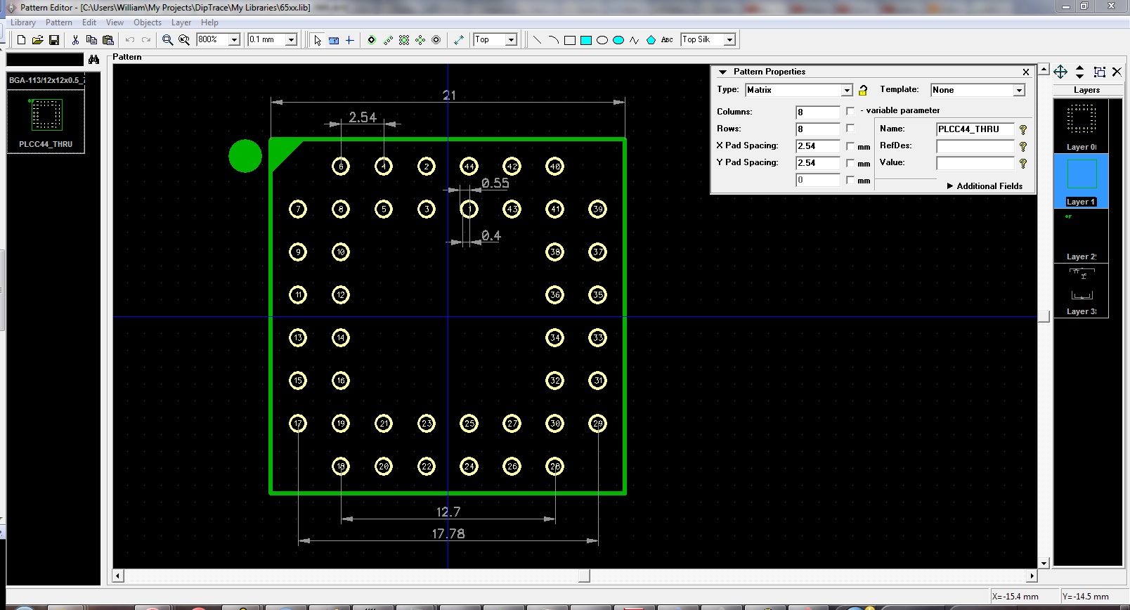

Alright, we're making progress... I've made a PLCC44 part anyway (in DipTrace), and I would like a second pair of eyes to look over the part and see whether I've made any mistakes... all units are in millimeters, and the only issue I can think of is that the PLCC socket will completely cover the solder mask (this is me being nitpicky :P)... ahh well!
DipTrace views parts from the top, and so this pattern is also viewed from the top. The measurements surrounding pad #1 are the hole and pad radii respectively.
Thanks for any feedback :D! Adapting the design to a 28-pin PLCC is trivial once I've got this version down. I will submit the libraries to this forum one they're done.
P.S. Sorry about the image size... Idk how to scale it down :(.

I measured some PLCC-44 sockets I have here and came up with an average width of about 23.4mm. The official JEDEC dimension is 0.925 inches.
Your holes should have an ID of no more than 0.74mm and a pad diameter of 1.42mm, except for number 1, which should be a 1.42mm square pad with a .74mm hole. The pad diameter/size you've used leaves too little copper and will be susceptible to coming loose from the PCB when you go to solder it.
Not sure I understand your concern about the socket covering the solder mask. Unless you design otherwise, the solder mask will be covering everything except pads and via.

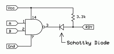

cr1901 wrote:
I noticed RDY is a bidirectional signal... is there a canonical way to make sure that a device and the CPU won't try to control the RDY line simultaneously?
The MPU will only pull RDY low if a WAI instruction is executed. So all you gotta do is connect RDY to the other device's output through a Schottky diode, with the anode connected to RDY. Be sure there is a pullup on RDY. 3.3K is a good value.

But then does that arrangement allow external devices to control RDY? Is it that when the cathode of the diode is at low voltage, most voltage will be lost through the pullup, and when the cathode of the diode is at high voltage, little current flows from anode to cathode and the resistor pulls up the voltage at RDY to logic high?
This must be one of those setups where all I/O and peripherals connect to the RDY pin using pull-up resistors and any one of them can pull the line low- just like the IRQ pin.
They can pull it down if they're not ready to move on, as in the case of slow memory that still needs more time to get the data.
A Shottky diode's forward voltage drop is only around a quarter of a volt; so if the cathode is pulled nearly to ground, the anode will still be in solid "0" territory. The pull-up resistor will have about 4.4 volts on it (5V minus .25 minus I'm going with .15V at the cathode for a CMOS output that's driving 1.3mA), which will drive about 1.3mA through a 3.3K. When the cathode of the diode is higher than the anode, no current will flow through it, so the processor is not pulling RDY down against something that's trying to pull it up at the same time; ie, there's no contention. The diode will isolate them when it's biased in that direction.

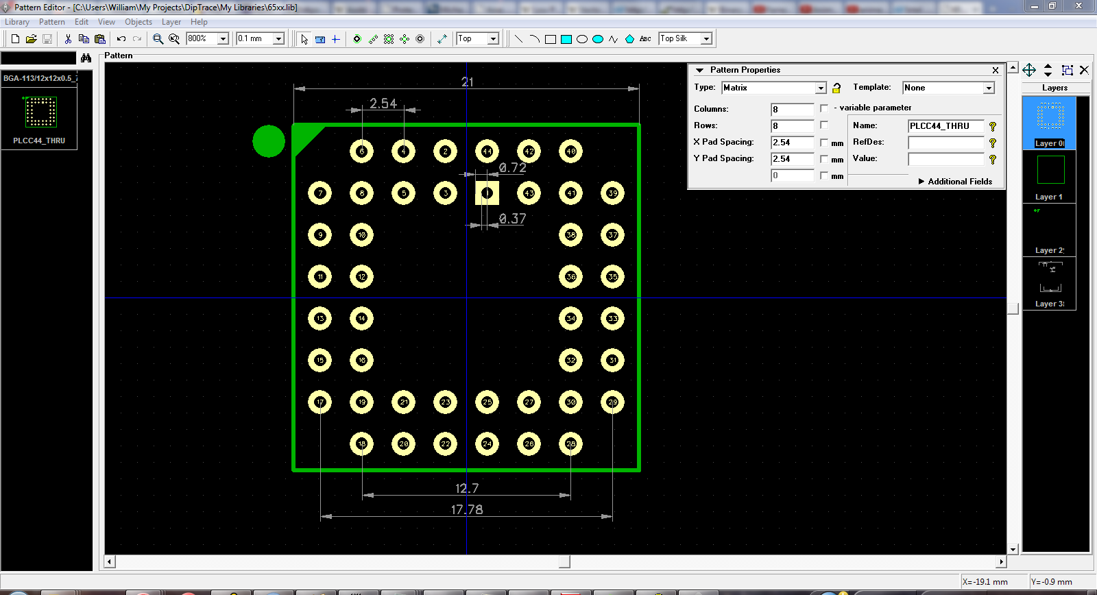

In the meantime... is this better? Measurements are measuring the same thing as last time (the fact that pin 1's pad is a different shape is insignificant)... also, are the holes numbered correctly, looking top-down at the PCB pattern?
See following.
File comment: Driving RDY From Other Logic
Unless both inputs on the NAND gate are high, the output of the gate will be high and RDY will not be affected in any way. If the MPU executes WAI during this time, the diode will be reverse biased and RDY will go low. If both NAND inputs go high, the gate's output will go low and pull RDY low, regardless of what the MPU is doing. That's all there is to it.
As Garth noted above, the worst-case current flow will be about 1.4 MA through the 3.3K resistor, so size the diode accordingly.

Would it not be appropriate to use a logic gate with an open-collector output?
The pad and hole sizes look to be okay. The square pad denoting pin 1 is useful during the "wiring up" phase of PCB layout.
The 21mm width and height of the socket body is incorrect. The JEDEC standard for a PLCC-44 through-hole socket is 0.925 inches or 23.48mm. Take a look at this drawing for socket details.
Incidentally, in PCB production, hole and pad sizes are expressed in diameter, not radius.
Sure, if one is available for the application. It would be easy in a PLD to tri-state the output when not wait-stating.
However, if the wait-state circuit is being implemented in discrete logic, it may be that RDY will be driven from the Q output of a flip-flop. So the diode would become de rigueur.
