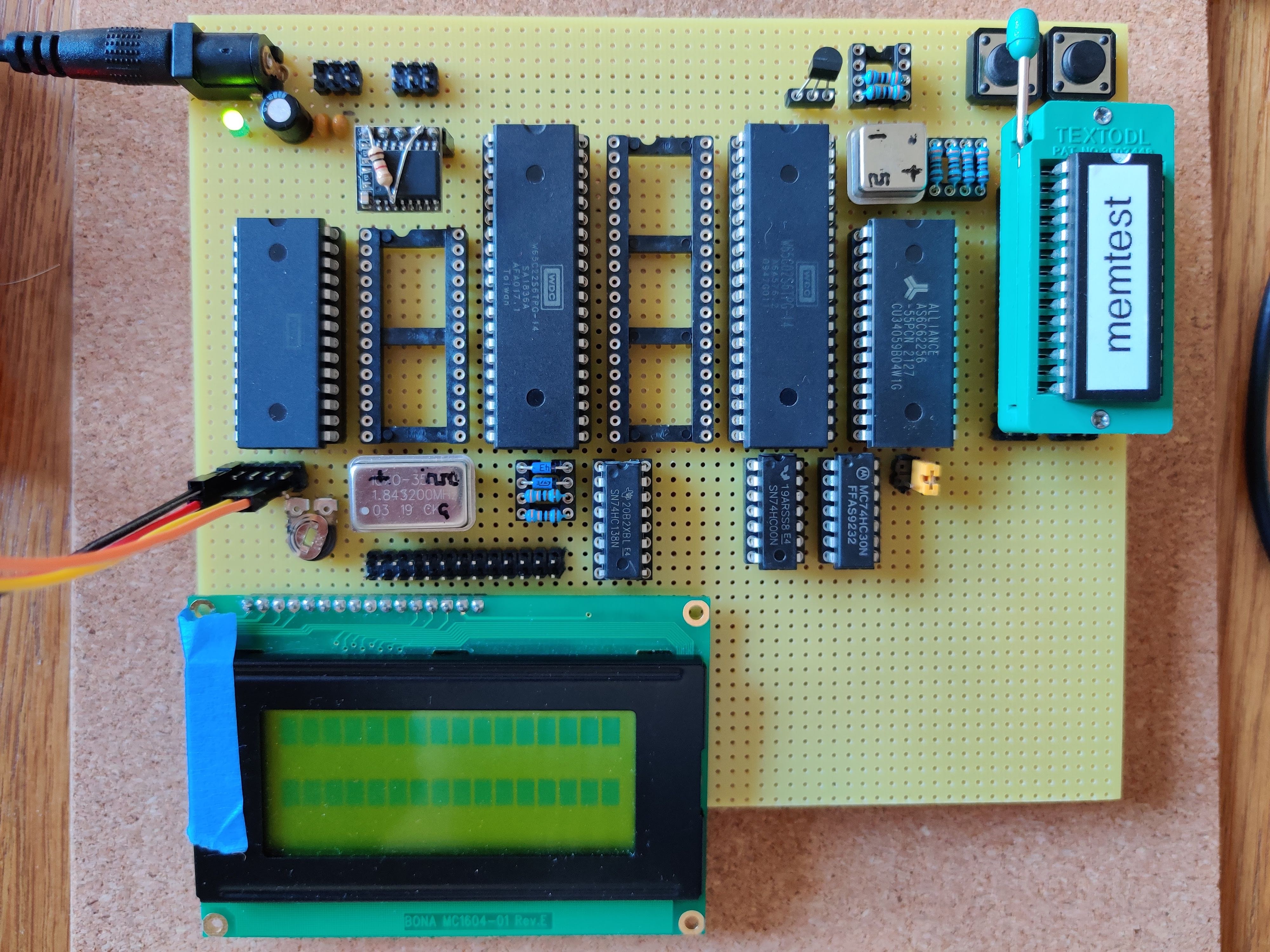

The part list for this experiment are W65C02, KM62256, AT28C256, W65C51, 2x1.8432MHz can oscillators, 7430, 74ACT138, and 74AHC00.
I can test whether TTL/CMOS of RAM is a problem by replacing KM62256 with AS6C1008 which is quite similar to AS6C62256. I'll let you know.
Thanks for all your testing. I think we are converging on noise (or levels) (or both!).
Replacing KM62256 with AS6C1008 (pull up A15 and A16 inputs) and verify it still passes memory diagnostic at 2.6V (it should, AS6C1008 is rated 2.7V-5.5V, same as AS6C62256); then raise voltage slowly while running memory diagnostic to 5.5V. Memory test passes from 2.6V to 5.5V. Attached is the memory diagnostic program which resides in AT28C256 EPROM.
I'm just nonplussed then.

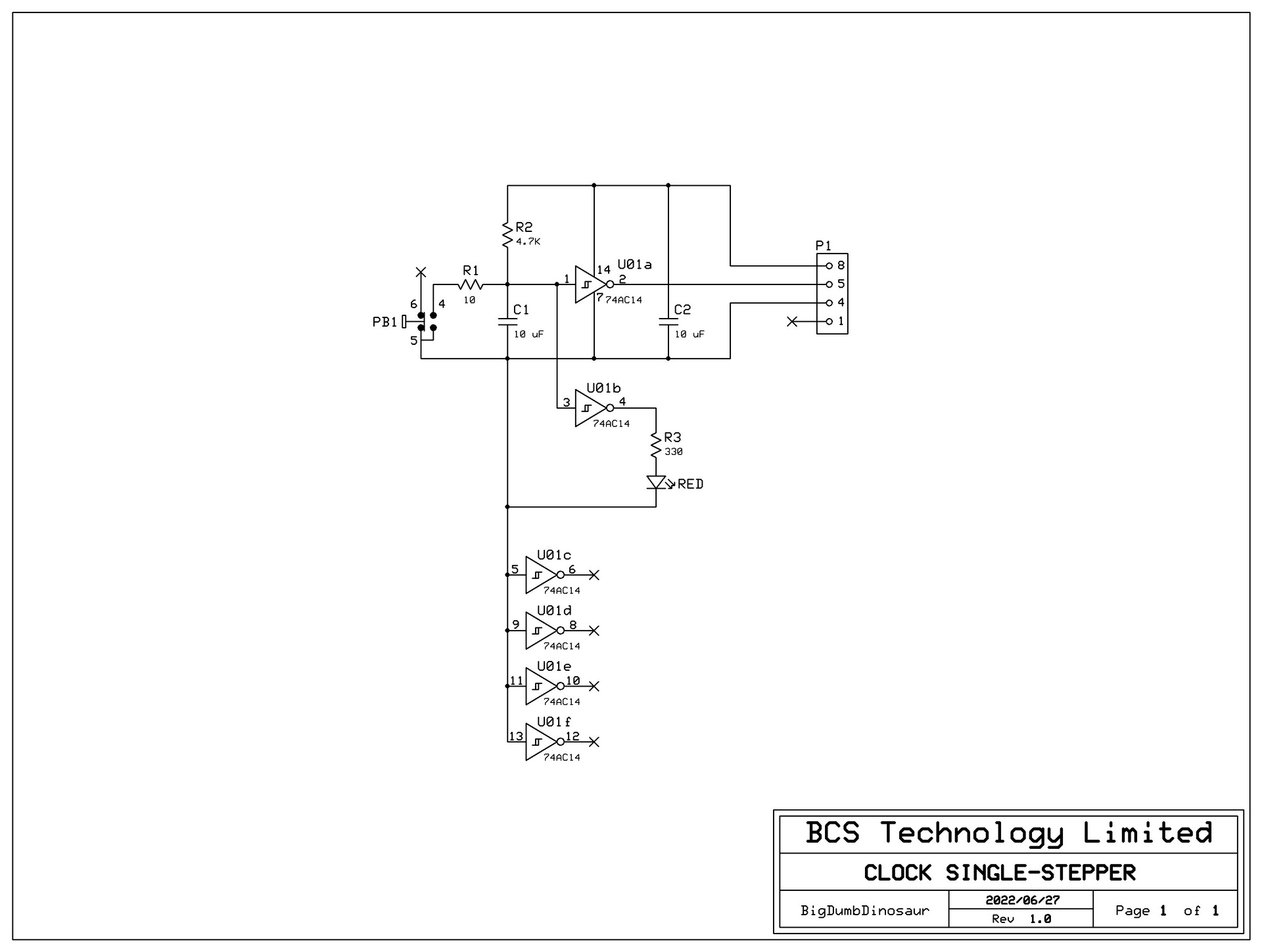

I do have a simple oscilloscope. I assume you are suggesting single stepping because you are not aware of that or is it for some other reason?
The idea of single-stepping the clock is to be able to hold bus conditions so you can take accurate measurements using a DVM. As the WDC 65C02 may be stopped with the clock held in either phase, this is a convenient method of testing something that is elusive during normal operation.
While a scope can illustrate what your buses are doing, you aren't likely to see subtleties that may be sufficient to interfere with stable operation. Being able to stop the MPU with the clock in the low or high phase gives you all the time you need to precisely measure the voltage on each bus line.
To summarise, perhaps, and to explain the causation: it's desirable for the RAM to be able to pull the output adequately high. So don't load it too much. In this case, don't load it with original type TTL chips...
Okay. I don't think I am overloading. I am using all HC glue chips and all WDC CMOS parts.
Indeed, the use of 74HC logic should assure very light loading, as well as outputs that swing rail-to-rail. Obvious exceptions to the rail-to-rail output swing are the RAM and ROM, both of which output at TTL levels, not CMOS.
In the case of the MPU driving the RAM (write operation), the former’s high level output is very close to VCC, well above the TTL logic 1 threshold of ~2.0 volts, so things are good. However, during a read operation, it’s the RAM driving the MPU.
The RAM you have is guaranteed to output 2.4 volts with 1 mA current draw, however, Bill Mensch stated in a conversation I had with him that the 65C02’s logic transition point is approximately VCC × 0.5. Empirical testing by Jeff demonstrated that the transition point appears to be slightly higher than that, 2.6 volts for the 65C02.
So it gets back to whether that 1 mA output of your SRAM is able to push the data bus high enough to make the 65C02 see a valid logic 1.
File comment: MPU Clock Single-Stepper

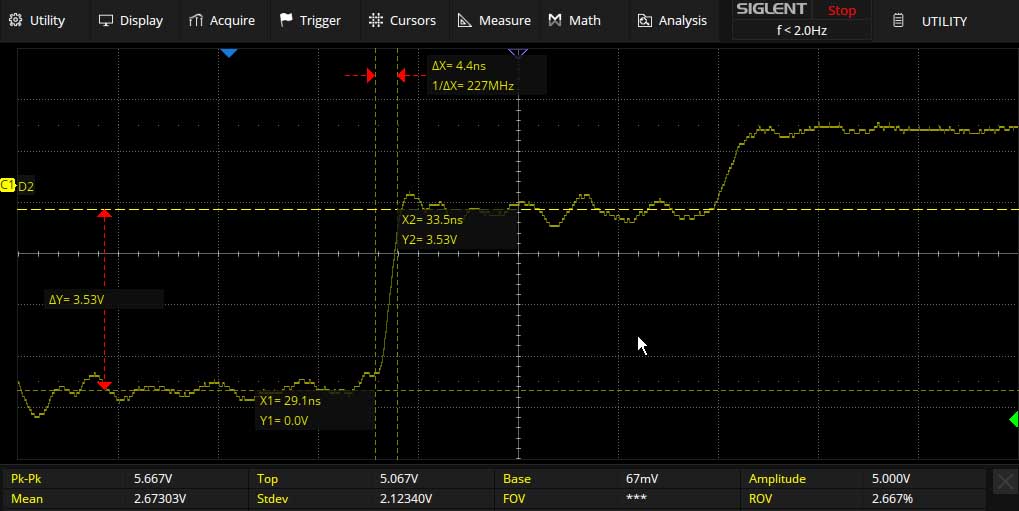

On the subject of RAM chips and which are/are not appropriate I went through my inventory of 32Kx8 SRAMs and tried them out in a working design and scoped the data bus for Voh when they were writing.
The system in question is very small, on a 4 layer PCB and running at 14MHz. The components on the data bus are: W65C02, SST 27SF256 EEPROM, an Intersil CDP65C51, the memory in question and a scope probe with a scope attached to it. The capacitance of the data line with the scope attached measured at 62pF.
From best to worst:
Samsung KM68257BP - 4.84V average from 4 samples
Winbond W24257AK - 4.24V average from 10 samples
Cypress CY7C199 - 4.12V from 3 samples
Toshiba TC55328P - 3.53V from 4 samples
The interesting thing is all of these are spec'd the same: Voh=2.4V @ 4ma. Clearly they are not the same.
BTW, they all work in that board with no issues.
Another thing of interest. Given the stray capacitance of 63 pF, you'd expect, according to the spec sheet and the calculation done by Garth earlier in this thread, that these chips would have a 3V rise time of in the order of t ~ (3V*62pF)/4mA ~ 42.6nS.
The worst of them, the Toshiba, was measured at ~4.4nS! 10 times better!
Well, the situation is as clear as mud and in my estimation we can't take any of the data sheet information seriously. From my perspective, I will stick to the Samsung and Winbond chips going forward.

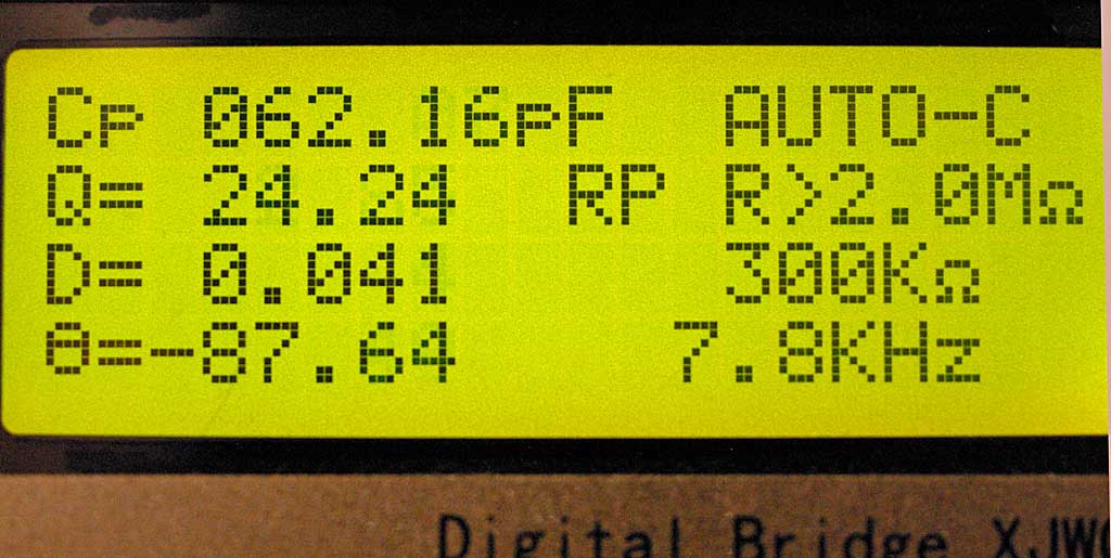

BTW, here is the measurement of the data line capacitance with the scope attached.

Thank you BDD. And thank you for the single stepper schematic

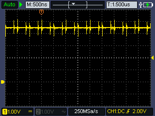

Here are some recent shots from my (ahem) oscilloscope:
This is phi2 at the 'C02 pin37 with the probe GND lead removed and a GND spring to the oscillator can (its that close)
This is A0 at the CPU. You can see the clock noise
Here is +5V at the oscillator pin
I have the pullup resistors still attached on the data lines, so I disconnected the resistor on D0 and here is a trace of D0 at the RAM chip pin
Here is D1 (with its pullup attached) at the RAM chip pin
Clock noise is everywhere and what are those curved - really slow rise lines on D1 (with pullup) (they are also on D2-7)?
Sorry about the really rubbish scope folks - I know the John Ruskin quote ( https://www.nthong.co.uk/ruskin.htm ) but I regularly ignore it, much to my disadvantage!

Those 5V voltages you are showing on the data lines are likely from the CPU. I do see a runt pulse in one of the data line shots. However, it's difficult to know where that is coming from.
You need to look at the data line when both the RAM /CS and /OE lines are low at the same time. That is when the RAM is driving the data buss.
But that runt pulse is a little weird. It could be a timing problem (two devices trying to drive the bus in opposite directions at the same time), a short to another data line or even a weak device trying to drive the bus high.
PostPosted: Wed Nov 09, 2022 1:15 am
Posts: 1117
I don't see anything unusual. Clock noise is normal, some is instrumentation induced. Data lines are generally chaotic; they only need to be stable around the falling edge of the clock. With pull up resistors on data lines you'll see slow rising waveform because of the pull-up resistor overcoming the data bus capacitance. The waveform you need to watch out in any signals (data/address/control) is mid-value steps in the range of 1-2V with sharp rise and fall before/after the steps. That's strong indication of contention. Generally there is a supply voltage spikes coincide with the steps because of large current draw at the time of contention.

When you say the oscillator might not be "properly specified". I didn't go to a lot of trouble I will admit. It is marked ECS-2100 and the datasheet says "The ECS-2100X Series clock oscillator offers low current drain and is compatible with HCMOS/TTL logic".
OK, good. And I've just checked one other detail, which is the rise/fall time. At 5ns max, it satisfies the WDC 'C02 spec. So, that's good... but, to be honest, part of me was hoping to reveal a clue regarding the trouble! :|
adrianhudson wrote:
Regarding the clock. The oscillator can is right next to the 'C02 phi2 input pin. [...] The wire is about 3/10th inch. I have a capacitor across the power/gnd of the oscillator. Is there anything else I can do to improve things from the point of the oscillator spewing unwanted rubbish out into the rest of the lines?
Well, it's not just the signal line; you also want a fairly direct return path between the oscillator and the CPU. I hope and assume the power/gnd pins of the oscillator connect reasonably well to the power/gnd pins of the CPU... ?
BTW, upthread I mentioned (pursuant to hoglet's remark) that a fast logic family can contribute to the generation of a glitch, due to a regenerative effect from the drivers turning on. I'm not convinced your project suffers from this, but as an illustration of the effect you might be interested in the final few posts of this thread. In your case, a fast CPU misbehaves, plausibly because of inductance causing the Gnd and/or Vcc lines to bounce, resulting in a glitch. In the linked thread it's a bad connection that causes the ground bounce, but still it illustrates one of the various ways a glitch can manifest. Spoiler alert:
