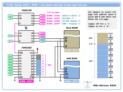

I also wanted to post an updated 74HC682 decoder concept drawing (below). I discovered that the '682 has internal pull-ups on the Q inputs so I had to revise my jumper scheme. Note that while the '682 is rather expensive compared to the '688, I received a handful from China for about $1.29 each (including shipping). If it works, I think the 2-chip 74HC682 decoder method might be a simple, clever, and elegant decoder solution for entry-level 65C02 SBC designs.

Michael wrote:
May I recommend Quinn Dunki's 'Veronica 65C02 Computer' project on her 'Blondihacks' website? It was a fun, educational, and entertaining series of posts.
I saw a couple of posts on that last week, it was entertaining!
Michael, I gotta ask: How did/do you find out about these internal pull-ups? I have a datasheet for the 74HC688 and see nothing about that on there. I mean, nothing explicitly saying "these pins have internal pull-ups". Do I have a bad datasheet? Is this a common thing for 74' IC's that I have just passed over? Is there some other wording they use that I'm not familiar with? Would me adding some pull-up's *damage* something if it does or does not already have pull-ups internally?
Thank you. Just a surprise to me. Always learning!
Chad
PostPosted: Mon Oct 25, 2021 3:44 pm
Posts: 588
Chad, the '688 doesn't have pull-ups on the Q inputs. On the other hand, the '682 datasheet does describe the internal pull-ups on its Q inputs. There's also a '684 which is the same as the '682 but without the internal pull-ups.

Michael wrote:
Chad, the '688 doesn't have pull-ups on the Q inputs. The '682 datasheet describes the internal pull-ups on its Q inputs. There's also a '684 which is the same as the '682 but without the pull-ups.
Sure enough, when I pull up the '682 datasheet, it's right on the front page! Ok, so if they say they have pull-up's then they have pull-up's. If they don't say anything, they don't have anything.
Easy enough, thank you Michael. I will consider this. Right now I'm only using a 74HC688 and a 74HC00, and I have one spare NAND gate left over. So, 2 chips vs 2 chips. But I'll go back over it just to look it over more closely. Thank you again!
