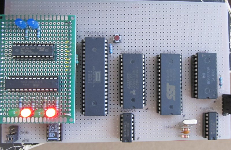

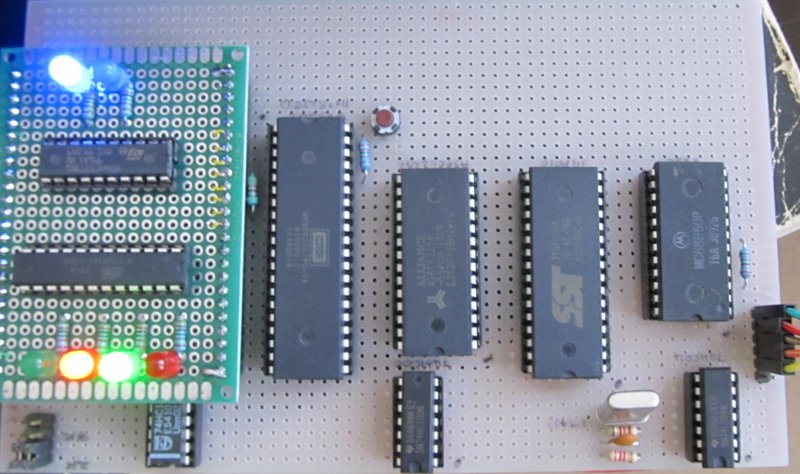

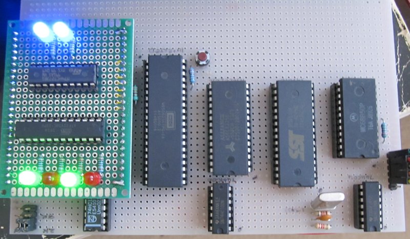

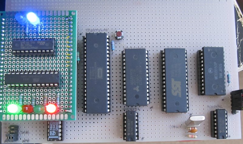

I've access to the VP-290 programmer, and I've built a quick and dirty test board to check the output file from WinCUPL.
It appears to work as expected using a stock ATF22V10C-15.
The 2 Blue LEDs are connected to the A and B inputs on pins 13 and 14. The green ones to the regular outputs, and the red ones to the inverse, fed from pins 20 to 23.
The CPU board is a Grant Searle 7 chip 6502 design with an extra chip select decodes so that I can POKE 32768,x to set the LEDs. The LED's are configured to sink current so they're on when the output is low .
File comment: POKE 32768,3
File comment: POKE 32768,2
File comment: POKE 32768,1
File comment: POKE 32768,0
