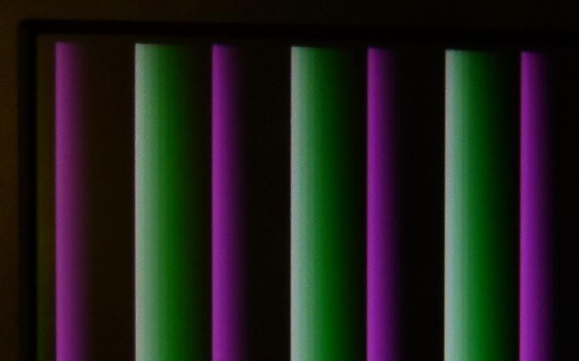

OK Finally got it working! Closeup of the upperleft portion of the monitor. This is ramping RGB from high to low. Noise issue is gone as well.

External control of the PROM select and FPGA /Program works as expected. 2 different patterns were programmed and selected successfully. Good news is PROM 1 & 2 designations on the board matches up with ISE. When ISE initiates the JTAG scan it shows the leftmost PROM (1), the middle PROM (2) and the FPGA on the right.
I think it's time to solder in the SyncRAM and try to come up with some simple HDL to try reading from it.
Looks like designer vertical window blinds. :D Good job!
Posts: 11464
Re: HDL Implementation of Video Generator Test for 16-bit PV
Well done!

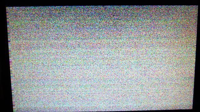

Guys, thanks! Very excited here. I soldered in the .65mm SyncRAM. Overdid it with the solder and used braid to get excess off. I like this technique! Will use it from now on. PVB powers up and runs still and no smoke...
Now I've been busy with some code and cannot use a testbench since there's no way to simulate the RAM. But I have made a successsful symbol with all the I/O's present, so the ISE tool must think it knows what I want to do. I've tried to approach it logically. Here goes:

Last post with code passed syntax check and was able to make a symbol, but it did not synthesize. SRA was a reserved name, so had to change it, also SRCS was wrong value. I did not have the SyncRAM address outputs registered like I did with the databus outputs and got a multiple driver error. So I fixed it, and it passes sythesis. I tried it out. Getting totally random pixels all the time. Timing not right. But it's something!

Are the pixels stable, or are they flickering ?
ElEctric_EyE
Posts: 3260
Joined: 02 Mar 2009
Location: OH, USA
Post by ElEctric_EyE »
Always changing, like my address counter is not being reset.
EDIT: I will go back to the simulator and see how your HVSync module works.

Thanks for looking that up. I'm sure i will need that in time, but now I know my problem is that the RAM counter is not being reset. My logic for resetting it using hstart and vstart is wrong. I must determine how to tell it the last pixel has been displayed. Maybe I could generate this signal from within your vga.v HVSynv module?
Arlet
Joined: 16 Nov 2010
Post by Arlet »
Here's a problem:
   if ( hstart & vstart )   //reset address counter at top left of screen
The hstart and vstart pulses don't happen at the same time. Try resetting the address counter just based on vstart. The vstart signal comes early, so you can prepare the data path. At hstart, you start incrementing.
You'll still have artifacts because the code doesn't compensate for all the pipeline delays, but at least you should have a stable picture.

I'm aiming for a stable pixel generation (i.e. data from a fast read-only memory (in my initial test), non-FPGA Block Memory, but similar) and should be able to achieve it at such a low pixel clock (25 MHz, 40ns access time) without even looking at timing diag's. Hopefully this pass-thru synchronous RAM has a 6.5ns delay, not pipelined like the other versions of this Synchronous RAM.

That does help. pclk and SRCLK need to be the same. I will just rename 1 and adjust the ucf accordingly. But I think what's happening presently is that with a 2MB RAM and 640x480=311040 pixels, the data being written to the videoDACs is overlapping on the display, since my address counter does not have the correct logic to reset to 0 at the end of the last pixel. That's enough memory for 6.7 displays.
