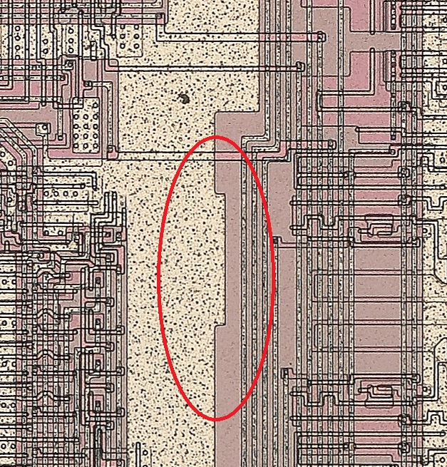

Some days ago I created an overlay of my (admittedly bad quality) die shot of the
8500R4 (aka 6510) and 8501R4.
I'm quite sure that the 6510 was developed BEFORE the 8501... but
the layout of the later 8500R4 seems to be derived from the 8501R4
or maybe they created them with having the variants already in their minds?!
But better see yourself (please be patient while it loads):
https://is.gd/rgcifA
Please note the metal lines at the right part of the chip:
Doesn't really make sense for the 8500... that's why I think the 8501 came first!
Does someone have shots of the MOS8502? I'd bet it's the same except the I/O port section.

Interesting finding and an interesting tool for comparisons...
I wonder when CSG got computer aided design? It's possible to copy and paste once your layout is vectors in a computer - but the original 6502 was a ruby-lith layout done with sharp knives. So, at some point, I'd suppose, MOS/CSG would have digitised that layout and started on a journey of making derived designs.
Is it possible that the 6510 was its own thing at the time but the 8500 was a later recreation? It's surprising (to me) that the 8500 has 8 bits of I/O port logic, with 8 pads, but only 6 pads bonded. Was there a chip which used all 8 bits of the port? Or a plan for such a chip?

The 8502 used more bits of the port (7 bits)!

Here's a comparison of the 6510 and 8500:
https://is.gd/ad5OyB
Please note that the main core in the middle is the same size (proportionally) but the outer
perimeter (i.e. drivers, ports etc.) are stretched vertically - a little bit.
PLA/Decode rom is also perfectly aligned!
