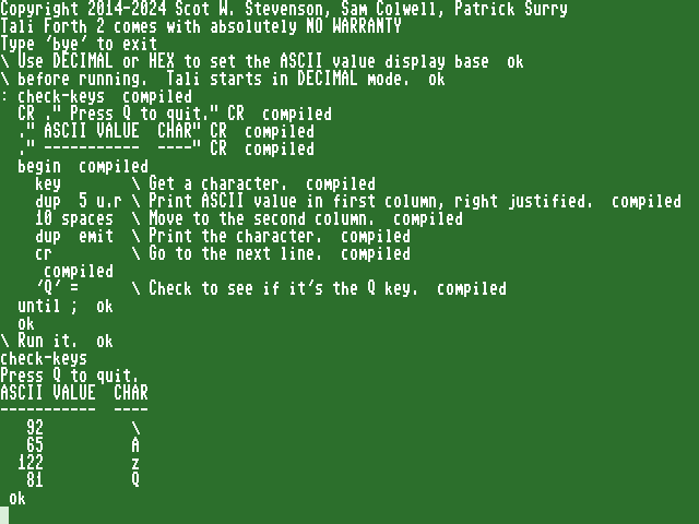

Re: 6502 TaliForth2 Implementation Questions
Finally! Just hacked the backslash glyph too.. If only I had more time right now to look at that editor!
- Wed Mar 05, 2025 10:25 pm
- Forum: Forth
- Topic: 6502 TaliForth2 Implementation Questions
- Replies: 31
It sounds like you are on a reasonable path that has a good chance of success.
I had a bit of spare time.. I tried a few things but ultimately I replaced the Fake6502 with the Fake65 C 02 version from C65 and here's the result:
(It works!)
The first keypress checking program ...
(It works!)
To help with your screen editor approach, you have several options.
Your options include (but are not limited to):
A: Modify ACCEPT to use your screen editor and copy the line where ENTER was pressed into the given buffer location (will have to handle the case where the line has more characters ...
Can you verify that the Forth code you are trying to compile works in either c65 or py65mon? If so, that would point to an issue with your simulator. I will double-check today and verify the version you are using works on real hardware.
Yes, it definitely works fine with C65 and that's using the ...
The last one is you, but it's a simple fix - you just need to put the 42 on the stack before calling EMIT.
That doesn't surprise me. I thought I'd copied directly from my Starting Forth book but it was at the end of the day. Thanks for that one :)
The underflow_1 routine will complain and give ...
