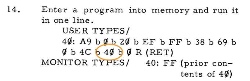

Ah, we're looking at different programs. The one I was talking about, and the one that is used in both videos linked above, is two pages earlier in the section titled "TEST PROGRAM."
Ah, I'm learning something new every day. I agree that the 2012 video must be an anomaly. Anyway, the lower case ...

Re: Looking for Baum's tiny assembler on Apple-1
mvk wrote:
they're showing a variation of the test program from the Apple-1 User manual (which was broken BTW).
cjs wrote:
Regarding that test program (which I use myself), what's broken about it?
