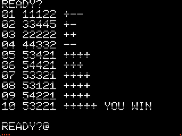

Testing works. The game's try counter wraps from $09 to $10:
