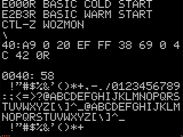

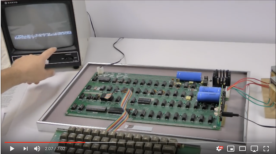

I also want to get such details right. I found that this original machine seems to treat a range of chars (presumably 0..$1F) all as CR.
Video: https://youtu.be/4l8i_xOBTPg?t=105
It is a bit hard to read, but they're showing a variation of the test program from the Apple-1 User manual (which was broken BTW).
0000 LDA #0
     TAX
     JSR $FFEF
     INX
     TXA
     JMP $0002
Fascinating! That's clearly different from the Apple 1 in the video I referenced in my notes: https://youtu.be/wTgyll6IqJY?t=33 .
Fortunately the Apple-1 Operation Manual includes schematics for the board. I won't claim to understand the video circuitry well (or much at all, really :-P) but I do notice that at the right-hand side there is pretty clearly a set of gates that detects a CR ($0D, 0001101) on the character input lines RD1 through RD7. The output of this goes into an OR gate the other input of which is the AND of a couple of flip-flop outputs that I would bet good money is the end-of-line detection.
So I think I'm going to (somewhat tentatively) assume that the Apple 1 in that video you found is broken. The way to confirm this would be to properly confirm the operation described by the schematic and, ideally, confirm that several other real Apple 1s have the "only CR generates a new line" behaviour.
Regarding that test program (which I use myself), what's broken about it? I see that it could certainly JMP $0003 instead of $0002, but that's an optimization that would make no difference in speed anyway, since the limit there is the wait for the video circuitry to be ready for a new character (done in the $FFEF ECHO routine).

Ah, I'm learning something new every day. I agree that the 2012 video must be an anomaly. Anyway, the lower case chars in the $60-$7F block are now properly squashed as well:

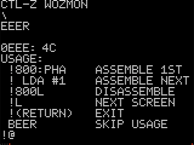

I added a usage text when starting the mini-assembler with EEER. This makes the program a tiny bit larger than 1K, stretching from $BE5 to $FFF now.
But the good thing is that now there's a second entry point that skips the usage text. This extra help code and text runs from $BE5 to $CA7. The mini-assembler itself from $CA8 to $FFF. Not a single byte got wasted, and we have two really nice entry points: EEER and ... BEER!
Just perfect.
