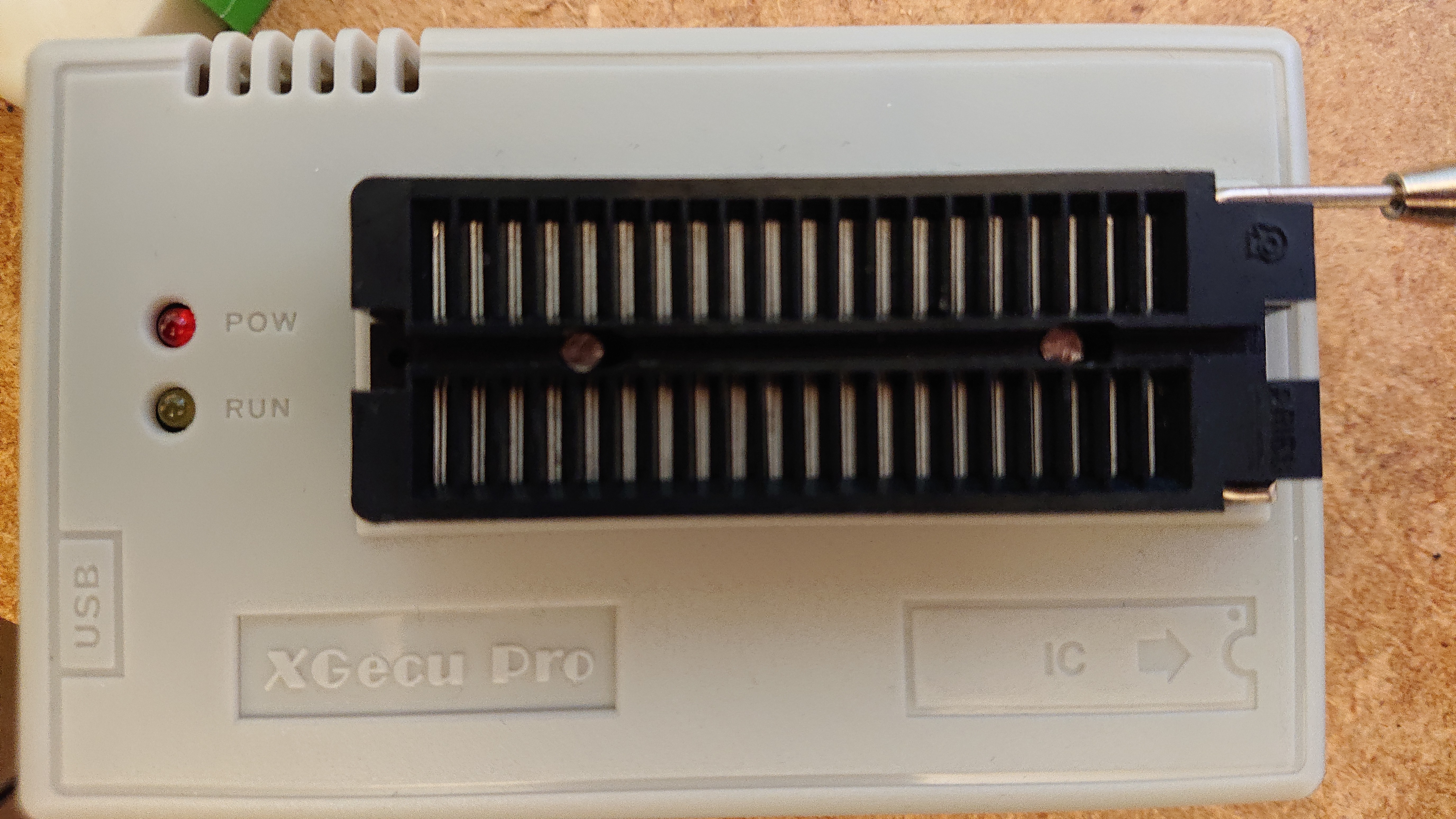

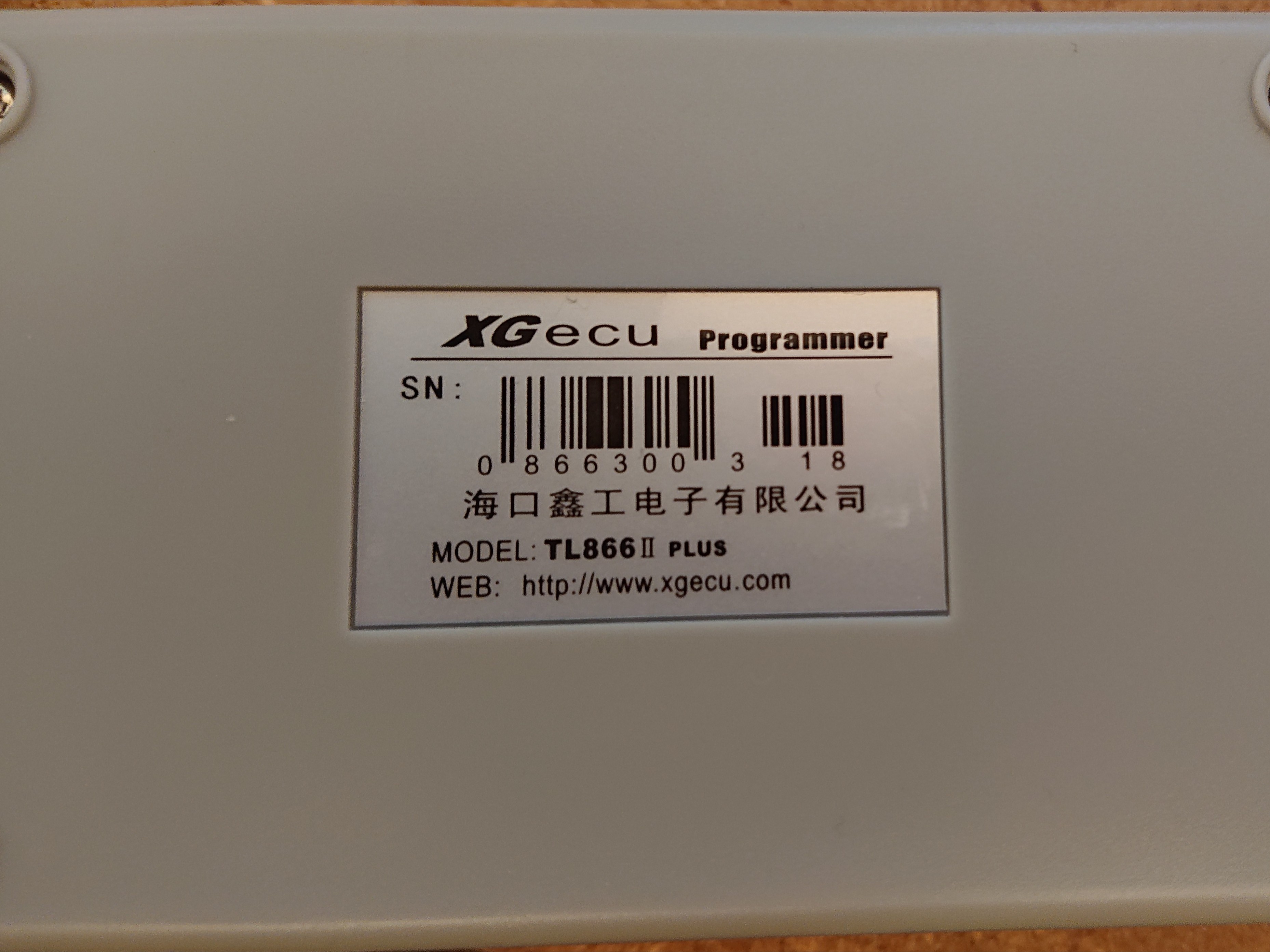

So moved on replacing the 74XX00 with an ATF22V10 GAL...
What did you use to program the ATF22V10?
I used an XGecu PRO TL866II plus, that is the original programmer and not a clone.
