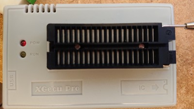

Posts: 8415
jgroth wrote:
So moved on replacing the 74XX00 with an ATF22V10 GAL...
What did you use to program the ATF22V10?
PostPosted: Sun Sep 01, 2019 9:31 pm
Joined: Thu Sep 15, 2016 1:52 pm
Posts: 60
Location: UK
I used an XGecu PRO TL866II plus, that is the original programmer and not a clone.
