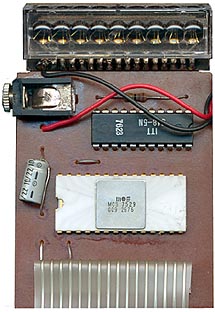

The chip in the 1974 advert is the 2529. Now if that chip has the same bug I found in the 7561, then its likely to be the same CPU/code. So if anyone has a calculator based on that chip, type:
[1] [EE] [1] [0] [-] [1] [=] displays 1 exp 00!
If that bug is not there, the chips *may* have different CPUs, or at least a rewritten ROM.
One thing, if you do get an SR4912 and decap the 7561, the rest if the calc would be good for a little portable 6502 conversion project! It has a keyboard, LED, 9v compartment, etc.. :-)
Edit: It seems the CBM SR7919 may be using the MOS 2529 (?) so if anyone has one and can try the "bug" above..
