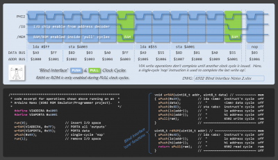

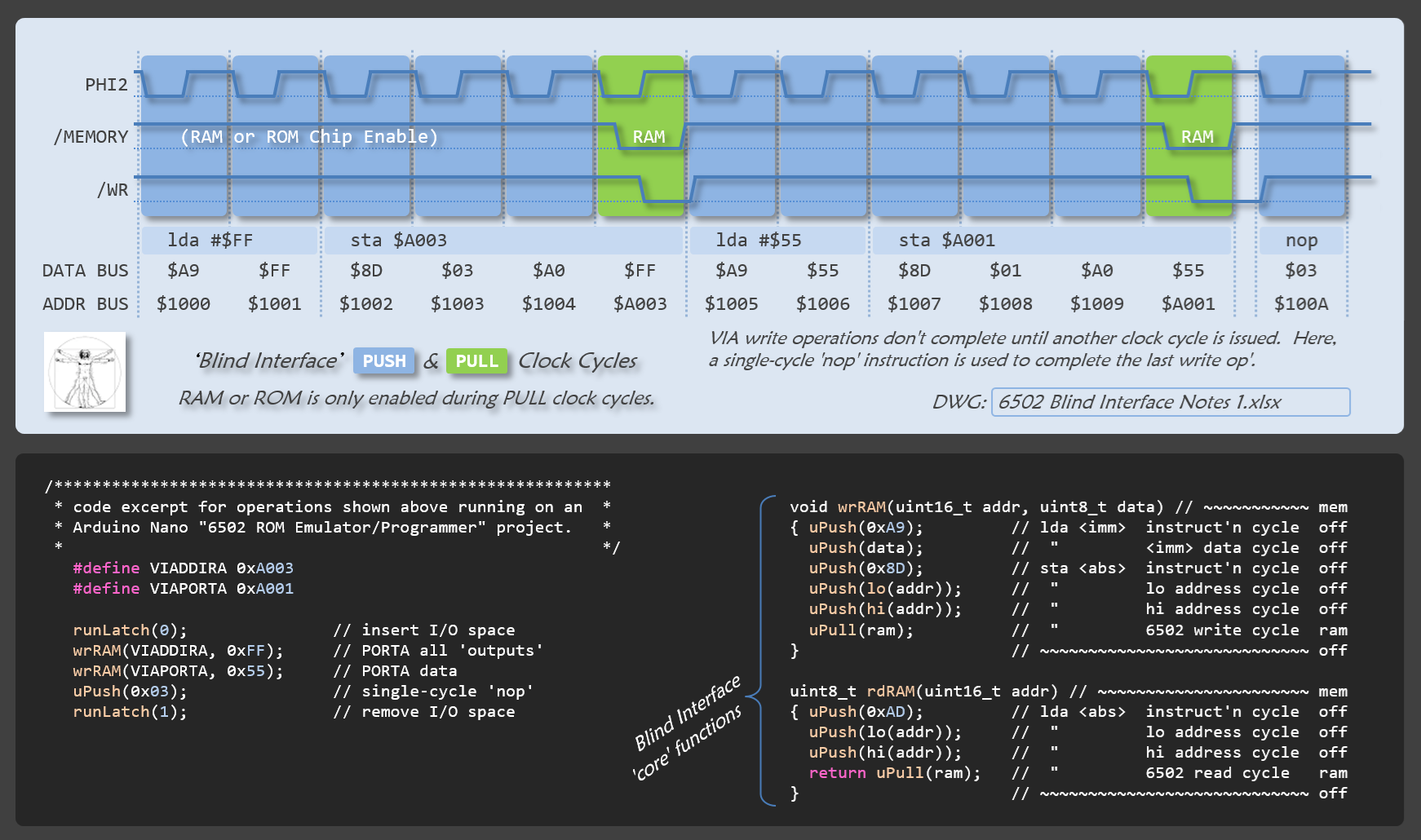

I use a microcontroller to access RAM and ROM a single clock cycle at a time on my ROM Emulator project and I noticed a problem accessing the VIA chip that way. I issue clock cycles that start and end in the high state to keep non-WDC CPUs static, which also leaves the CPU address and r/w lines active until the next clock cycle comes along. During memory read/write clock cycles the chip enable line goes low and high within the clock cycle which works fine for RAM and ROM but a read/write VIA clock cycle doesn't complete until I send another clock cycle of some sort.

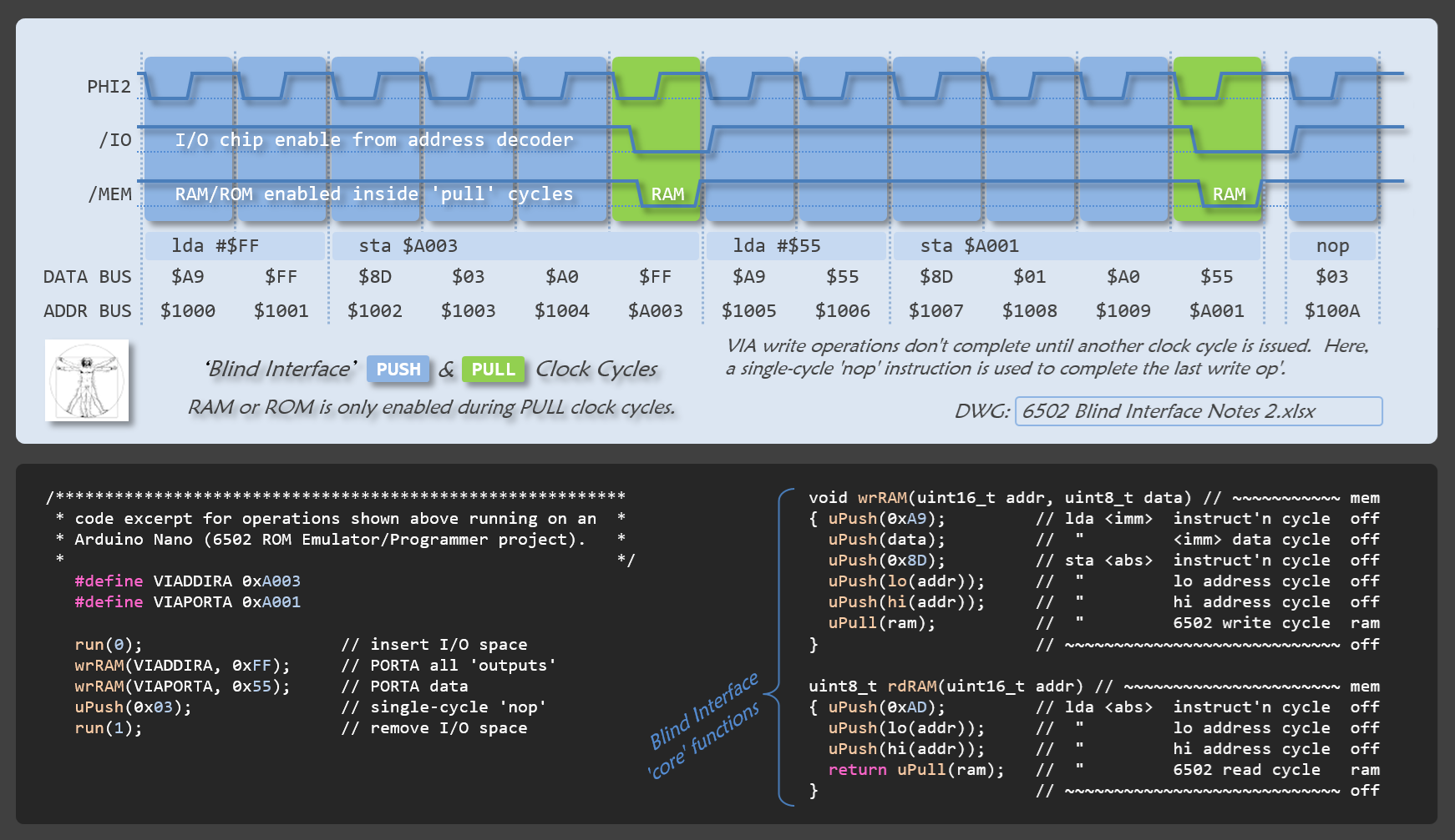

So, the VIA clock cycle takes the clock lo. The CPU sets the address and r/w lines. The memory enable (RAM, ROM, or I/O) line goes low. The clock line goes high. The CPU puts data on the bus for a write cycle or reads the bus for a read cycle. The memory enable line (RAM, ROM, or I/O) goes high. The clock line remains high and the CPU address and r/w lines are still active.
Does the 65C22 VIA complete read/write transactions when the clock goes low rather than when the chip enable line is disabled?

You should review the timing diagrams on page 46 of WDC's w65c22 datasheet (the values for the timings are in the preceding pages). The address, chip select, and R/W* should be set BEFORE the rising edge of PHI2 and the data will be captured on the falling edge of PHI2. I think your NOP is just creating the falling edge the 65C22 is waiting for.
I think what you are doing is not a standard bus cycle the 65C22 understands, so the expected behavior is undefined. When you have PHI2 high, you are in the middle of a cycle, not between cycles.

If you mean the VIA's chip enable line goes low and high within the time Phi2 is high, then that's a problem. The address decoder which drives a VIA's CS mustn't be qualified by Phi2. (Edit: hmm, your diagrams show it's NOT qualified by Phi2.
Re: VIA anomaly ~ single-clock single-step (blind interface)
Thank you for helping me think through this, guys. Turns out the VIA chip enable is available past the end of a 'pull' clock sequence when ϕ2 remains high and the address lines remain active because the I/O chip enable comes from the address decoder and not from the low-level 'pull' function. So I just need to generate a single-cycle 'nop' at the end of a series of I/O operations. My test ROM Emulator LCD driver code (below) contains a strategically placed 'nop' instruction and now I can write to the LCD display from the uC in ROM Emulator mode as well as from the 6502 in normal 6502 RUN mode.

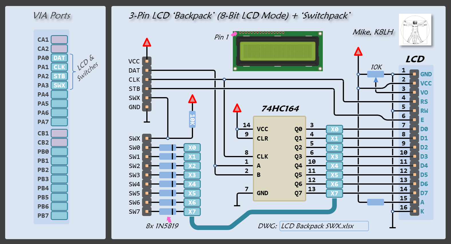

#define line1 (0x80+0x00) // set DDRAM command + line 1 address
#define line2 (0x80+0x40) // set DDRAM command + line 2 address
#define line3 (0x80+0x14) // set DDRAM command + line 3 address
#define line4 (0x80+0x54) // set DDRAM command + line 4 address
LCD lcd; // create 'lcd' instance of 'LCD' class
lcd.init(); // 8-bit mode, cursor inc & off
_delay_ms(1000); // wait 1-second
lcd.print("3P8B Backpack v1"); // splash screen
lcd.cmd(line2+2); // line 2, tab 2
lcd.print(F("8-MHz 65C02")); // a "flash string helper" ROM string
* test LCD class - ROM Emulator mode - writing to LCD serial backpack. * ;~~~ 6502 low level 3P8B LCD backpack drivers ~ M.McLaren ~~~
#define VIAPORTB 0xA000 // ;~~~ X XXXXX XXXXX ~~~
#define VIAPORTA 0xA001 // ;~~~ X X X X X (C) 2026 ~~~
#define VIADDIRB 0xA002 // ;~~~ X X X X Mike McLaren ~~~
#define VIADDIRA 0xA003 // ;~~~ X X X X K8LH ~~~
;~~~ X X X X ~~~
#define clk 4 // index for VIA PA4 ;~~~ X X X X X CA65 v2.13.3 ~~~
#define stb 2 // index for VIA PA2 ;~~~ XXXXXXX XXXXX XXXXX ~~~
#define dat 0 // index for VIA PA0
.define dat 0 ; PA0 bit index
class LCD : public Print // use 'Print' features ******************* .define clk 1 ; PA1 bit index
{ public: // * .define stb 2 ; PA2 bit index
void init(); // * .define swx 3 ; PA3 bit index
void cmd(uint8_t); // *
