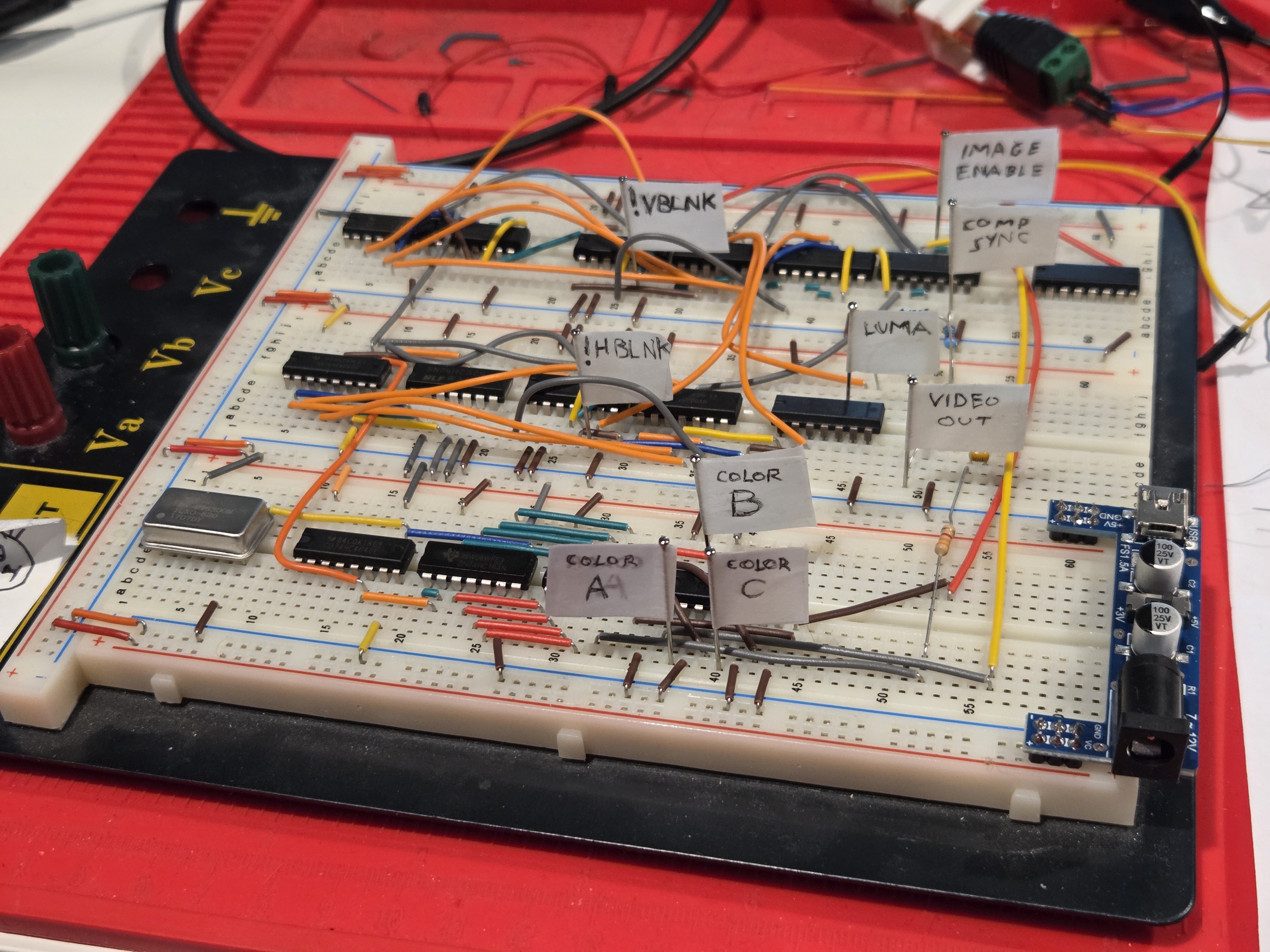

A while ago I posted about my approach to generating color composite video here. I built one again this week so I could record the process and explain while I put it together.
https://youtu.be/DYYeoiDy5Es
It stops short of displaying video data from memory, which I plan to do as a companion video later.
(Though connecting the color control signals and pixel clock to a memory device will be pretty trivial)
I'll also draw up a proper schematic this weekend hopefully, I just finished rendering and uploading this morning after recording yesterday. Then I had to catch my flight to VCF SoCal.

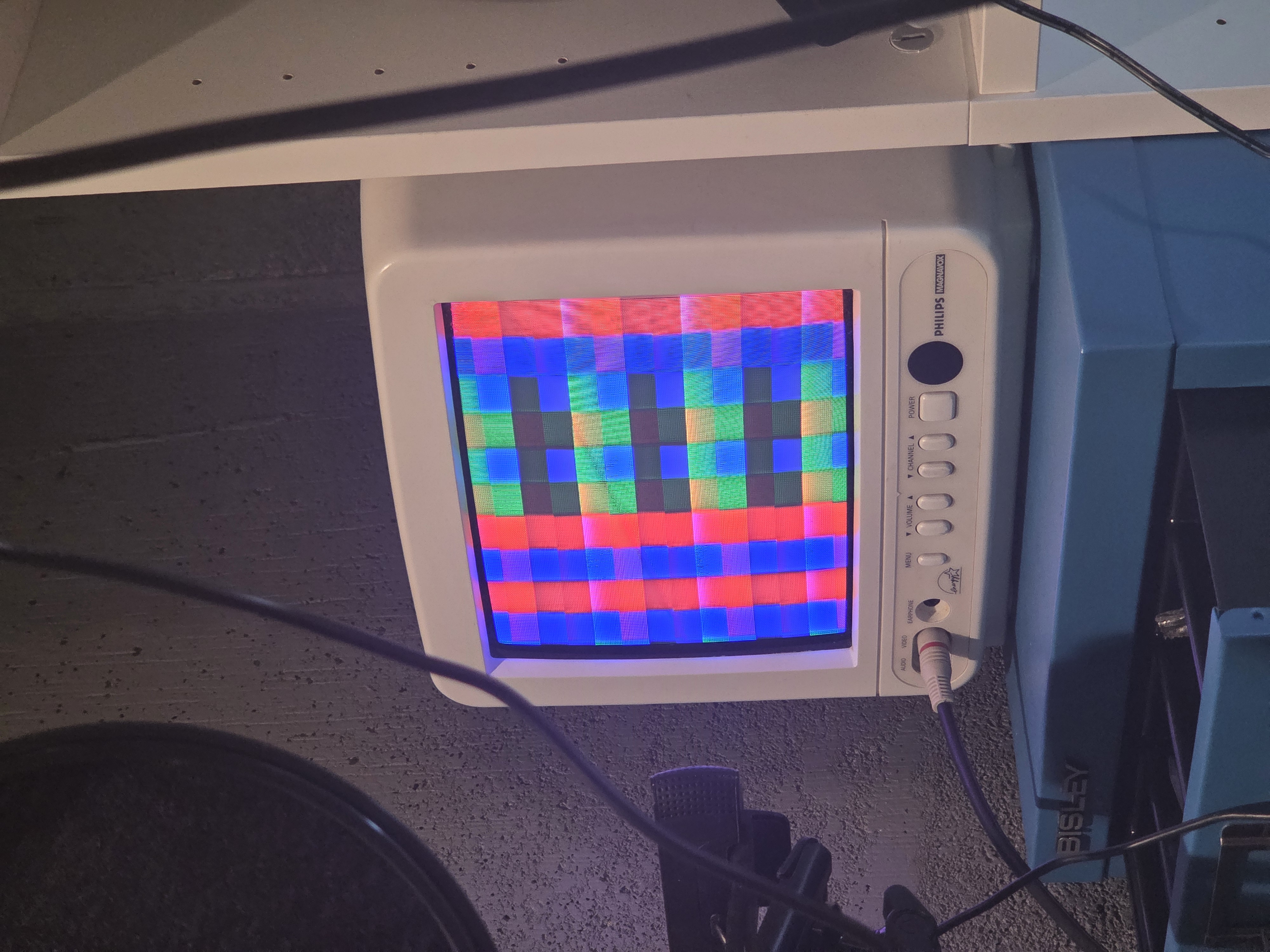

Here's a pic of the circuit and an example of its output. (Made separate post because shaky internet connection)
