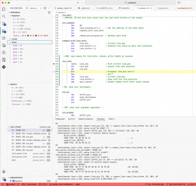

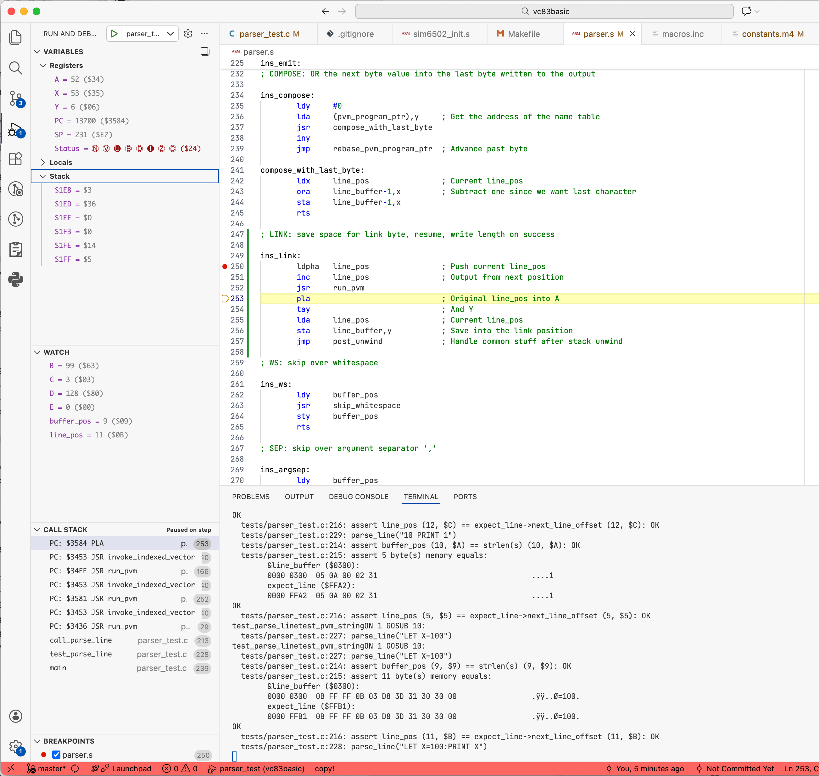

Now that I'm (temporarily?) done hacking on the debugger, I've gone back to my original project. And guess what, the debugger is actually really useful for my purpose, debugging my own assembly language code. Here you can see it's showing me the registers and flags, some zero page values (in watches), the call stack (mixed C/assembly), and stuff on the 6502 stack that's not one of the call stack return addresses.
