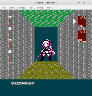

Hello everyone!
I've been working on a new NES game! I'm calling it "Card Chasm". The concept is that you are in linear dungeon fighting enemies along the way. To move, you use cards from a deck you have made. The same cards are used to attack, heal, and perform other abilities in combat. Defeating enemies gives you more cards to add to your deck. I'm modeling from an Android game I played some years ago, but taking a lot of personal freedom to make it my own.
The main challenge so far has been re-learning how the PPU works. It has been almost a week of engineering to get that 'walking' effect you see in the GIF. I'm using two nametables that have tiles slightly shifted, then switching between them as I scroll the camera slightly. I'm also using Sprite 0 Hit to get a HUD at the bottom, and cycle counting to disable the background rendering to remove left-over ugliness at the bottom of the screen.
For the enemies, I'm actually starting with some AI generated images from Perchance, scaling them to 64x64 and using only 3 colors (4 colors if you include the transparent background), then cleaning it up in GIMP. I'm getting pretty good at it by now, and I have made over a dozen enemies that look similar but have a different 'feel' to them.
There you have it. Lots of work ahead, but I'm having fun in 6502-land some more. By the way, local labels are a *game changer*! I'm writing everything in 6502 assembly and quite enjoying it because I can just label things like @loop1 or something and it's not a big deal anymore. Yay!

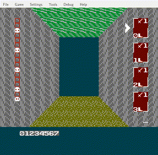

The game is certainly coming along. See attached!
On the right side, I can now select which card to use. The other ones slide to their new position, and more cards get put into the hand when you only have one card left.
On the left side, it indicates which places have enemies, and which are empty. If you land on an enemy place, they portrait comes up. Walk away and it goes away. In the future you would battle once you see an enemy.
For the tunnel, I tried *really* hard to make it look even better, but I ended up abandoning the complexity to go with what is simple. There are two palettes: ceiling and floor. The wall color comes from either one, and they all need to share the same accent color (here it is light grey). Not the best, but it will do for now. I think I can make some better textures that will really pop later.

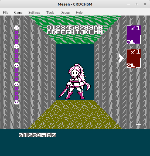

Hahaha! The original game I'm basing this off of used 'monster girls'. I'm intending on using more generic 'adventurers' in a way. When I was testing out processes and toolkit using the AI generated images, my specific prompt was "samurai girl with white hair and long sword" and so I have a lot of those right now :)
I tried doing it all by hand, like from scratch, but it just isn't as flavorful as when I do touch ups from the AI generated version. See attached.
Hard disagree - even clumsy personal art is much more interesting to look at than generic machine output, and I much prefer your DIY example.

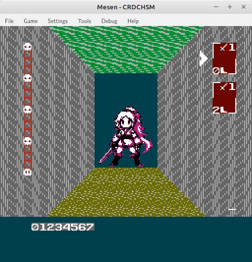

Alright, you guys got me curious. So what I did was look at the original image, then I set up a grid in GIMP and drew the black outline pixels wherever I personally wanted. Then I scaled, contrast, etc, to get basically want I wanted on a 64x64 grid. I then started colorizing it and adjusting pixels by hand. See attached!
I really want to be consistent, so I'm trying to find a fairly easy and, uh, consistent way to get similar results going forward. I don't want some of the art to seem "different". Gosh, on the last game I had only a 16x16 grid to work with, and that was infinitely easier to do! Now that I have more space to work with, it is SO much harder! :)

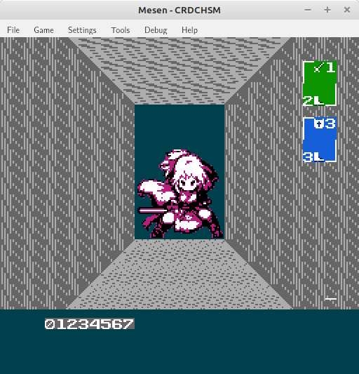

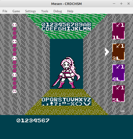

Updates (besides artwork):
1) I did a lot of wasting time trying to get that enemy portrait drawn without disabling rendering for a full frame. After three non-working solutions, I finally just went with something simple and it works fine. Essentially you can only draw stuff during the V-Blank portion of the screen, so I just drew the portrait information little by little spanning multiple frames. Easy (eventually).
2) I added titles while in battle. They will contain enemy name, health/status, and even some phrases they will say during battle. The original game has a pattern for each enemy, and they often say something to indicate what will is coming next.
3) I added attack and damage animations. There is a 'slash' that moves across the screen when attacking with a card. Then the enemy hits you, shaking the screen. I don't think it's perfect just yet, but you can see the basics of how it will work at this point.
4) I adjusted the font. I softened the edges using some unused palette color values to do this. I'm not entirely sure if I like this better yet, but I'm just experimenting at this point.
