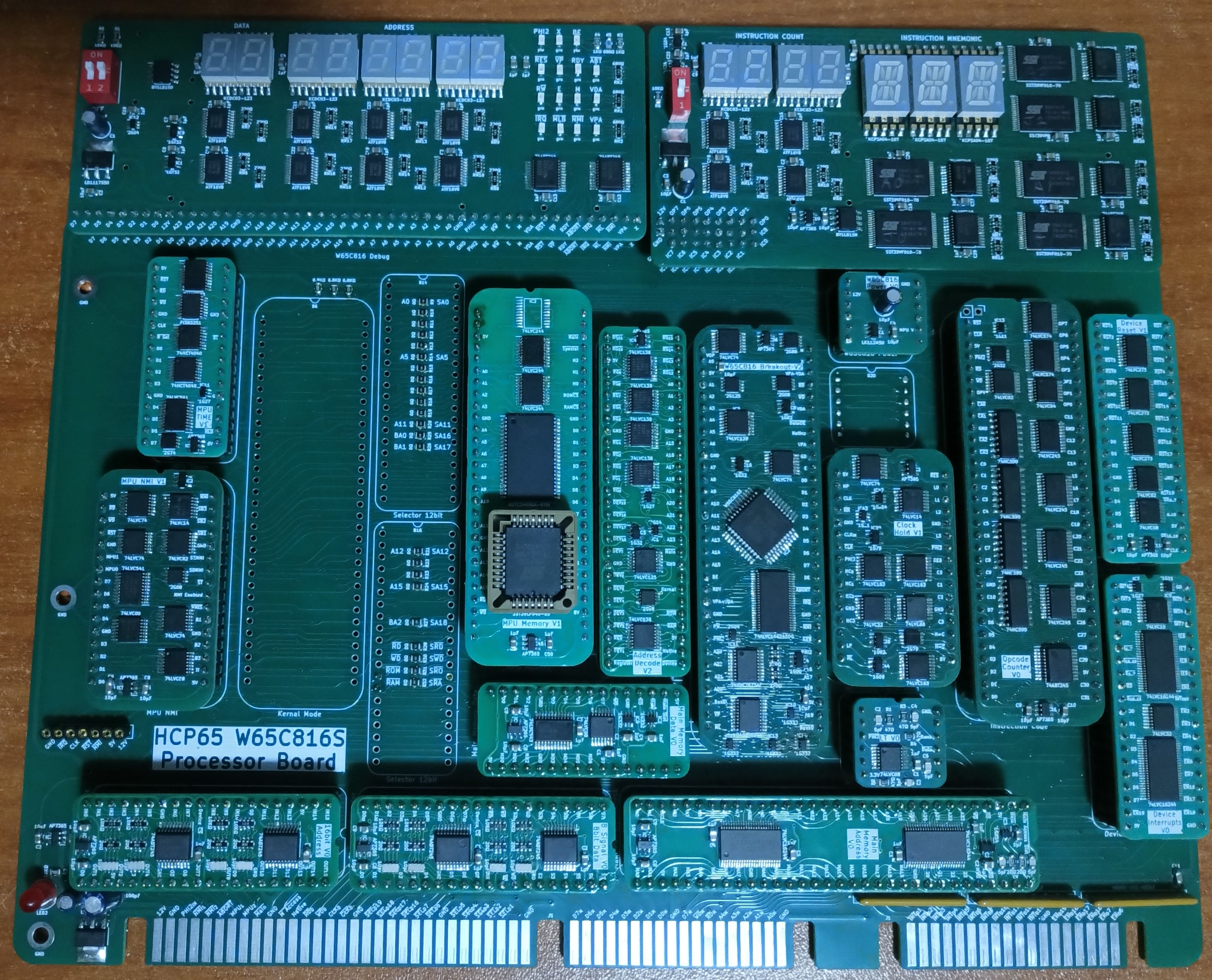

Does it work? Nope. That's next years problem. And as you can probably see by some of the board revision numbers I'm collecting a bit of a graveyard of failed attempts.

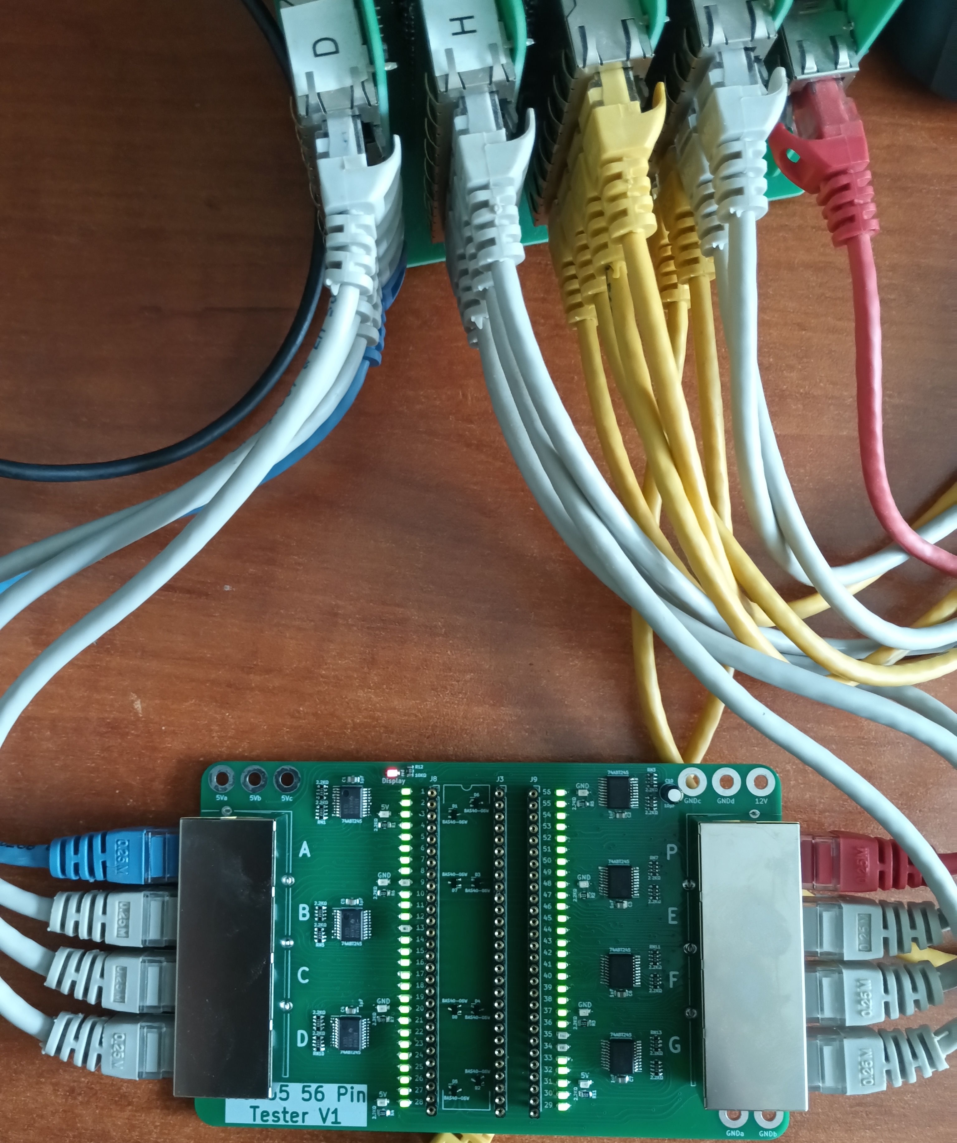

... and the thing I use to test each of the "DIP" boards; it's basically just a boatload of GPIO. I'm using network cables and sockets because they're cheap and make pretty good mechanical connections. It only tests for correctness, not performance.
