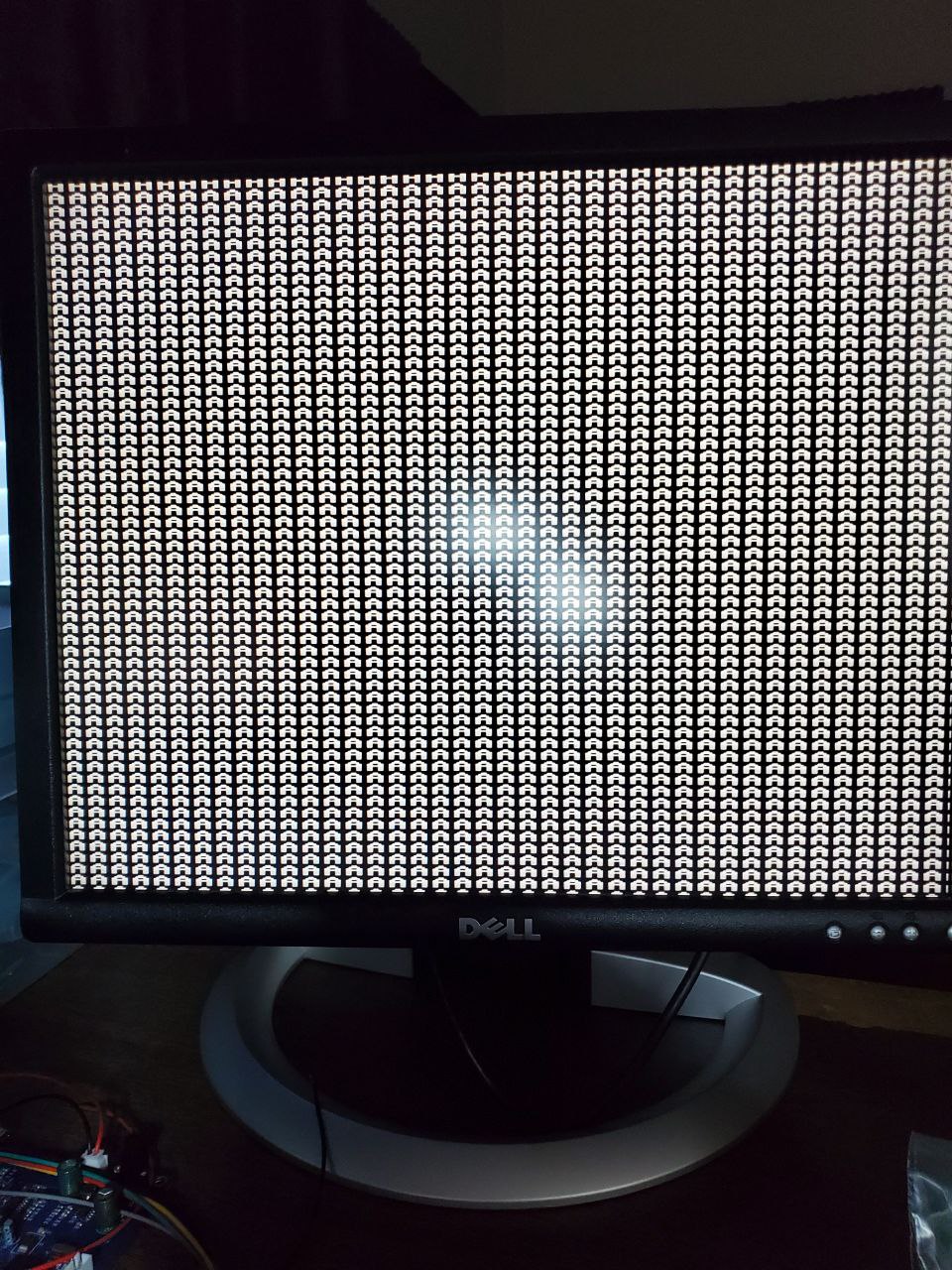

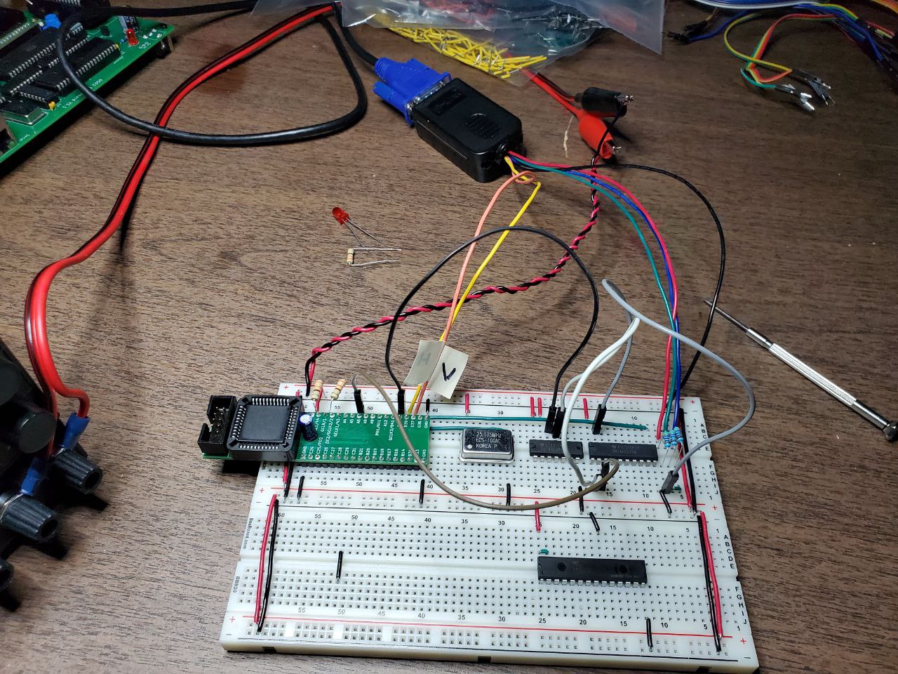

Been trying to get VGA working and thought I'd share some photos.
Right now I have a ATF1502 generating the horizontal and vertical counts and sync pulses, and this seems to be working reasonably well enough, though periodically the picture blanks out, however the monitor doesn't indicate it has lost signal. I suspect right now the OE# of my 74HC574 is slightly off from the blanking signals causing the monitor to see some output from the picture before the '574 releases the circuit.
Here's some photos:

Yuri wrote:
Been trying to get VGA working...a ATF1502 generating the horizontal and vertical counts and sync pulses...I suspect right now the OE# of my 74HC574 is slightly off from the blanking signals causing the monitor to see some output from the picture before the '574 releases the circuit.
Two things you might want to investigate.  First one is the 74HC574 might not be fast enough for this application.  Second one is a possible logic level mismatch.
Atmel PLDs output TTL levels, not CMOS.  While observation in actual circuit conditions indicates that a logic 1 from an Atmel device will climb near 4 volts (VCC = 5) when unloaded, that is not guaranteed.  The guaranteed VOH is 2.4 volts.  Any increase beyond that will not have the rise time that occurs when the output goes to the rated VOH.  That in itself may be affecting your timing.
My suggestion for ruling out the logic level possibility is to replaced the 74HC574 with an AHCT equivalent.
That could be an issue, however I've never had such problems with the ATF15xx parts with my CMOS logic before. VGA uses TTL logic for the vertical and horizontal sync levels, so that should be fine.
I'll look into finding an AHCT part; however, I think I was spot on. The signal I was generating to enable the output of the '574 was being inverted by a 74HC86, but the sync pulses were not being delayed; by placing both on the '86, that seems to have cleared up that issue for now.

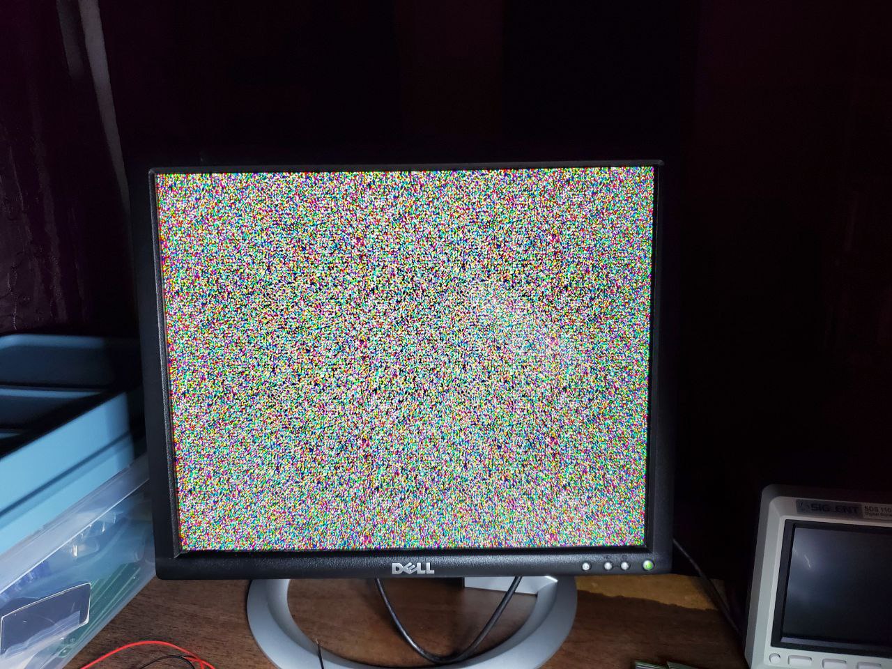

Here I was able to get it to dump the contents of uninitialized SRAM in an 8-color mode:

Yuri wrote:
Here I was able to get it to dump the contents of uninitialized SRAM in an 8-color mode...
Looks like the video equivalent of a hangover.  :D

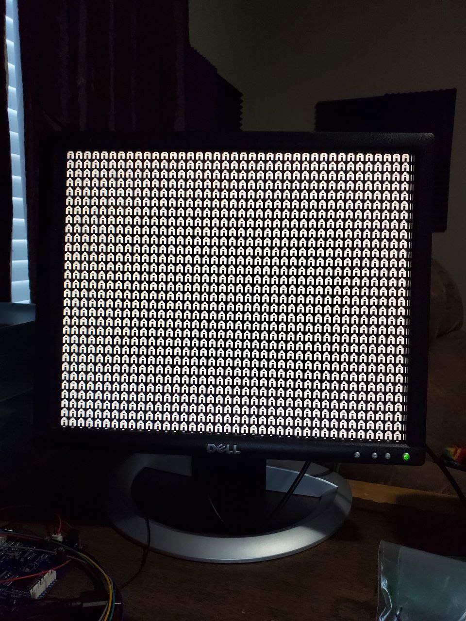

I've hooked up a ROM (AT28C64B) as a character font and got that displaying some characters:
As you can see the characters are slightly offset, and I'm again having some syncing issues now that I've changed out the D-flip flop for a parallel to serial register; and once again I'm having some syncing issues. I'm sure a lot of this is due to timing issues that I need to figure out, but other than dropping out periodically the image is very stable, much more so than I had expected.
Current circuit below (be warned, this is very much a work in progress, so a lot of stuff isn't connected correctly or might not even make sense):
DerpVGA.pdf
(199.08 KiB) Downloaded 72 times
And this is what happens when you feed your ICs a steady diet of free electrons. :mrgreen:

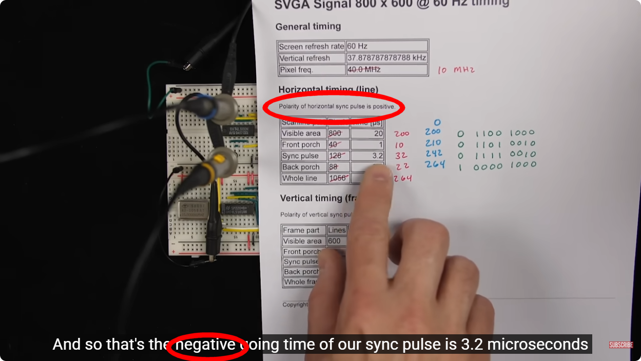

What polarity do you have for your hSync and vSync?
I have seen people swear by Ben Eater a being the perfect source in his video, but even he made a few errors in his “Worlds worst GPU” video. The big one being the incorrect polarity of the sync pulses, even though he has the sheet right in front of him when he makes the error.
This is often the source of the issue where people often say “it works perfect on this screen but not on that one”. Some screens are more tolerant than others.

Figured out that I wasn't properly blanking the signal as well as added those 47 ohm resistors. The image is now very stable, I also corrected the vertical scaling:
No more squished letters! \o/

I'll keep that in mind. Right now I'm pretty sure that I have the following issue:
The top line appears to be half the size of what it should be, implying that I'm I'm somehow moving to the next line before I should be. I think this is likely because I'm incrementing the vertical count on a rising edge instead of a falling one.
The left most character seems to be completely missing, I'm convinced this is because I'm trying to load that character right on the zero horizontal count, causing me miss the first one as the very slow ROM tries to settle out.
I'm also getting what looks like a couple of pixels shifted over to the left, causing one or two extra columns to appear on the right side of the monitor.
The binary pattern will definitely help with identifying the exact count.

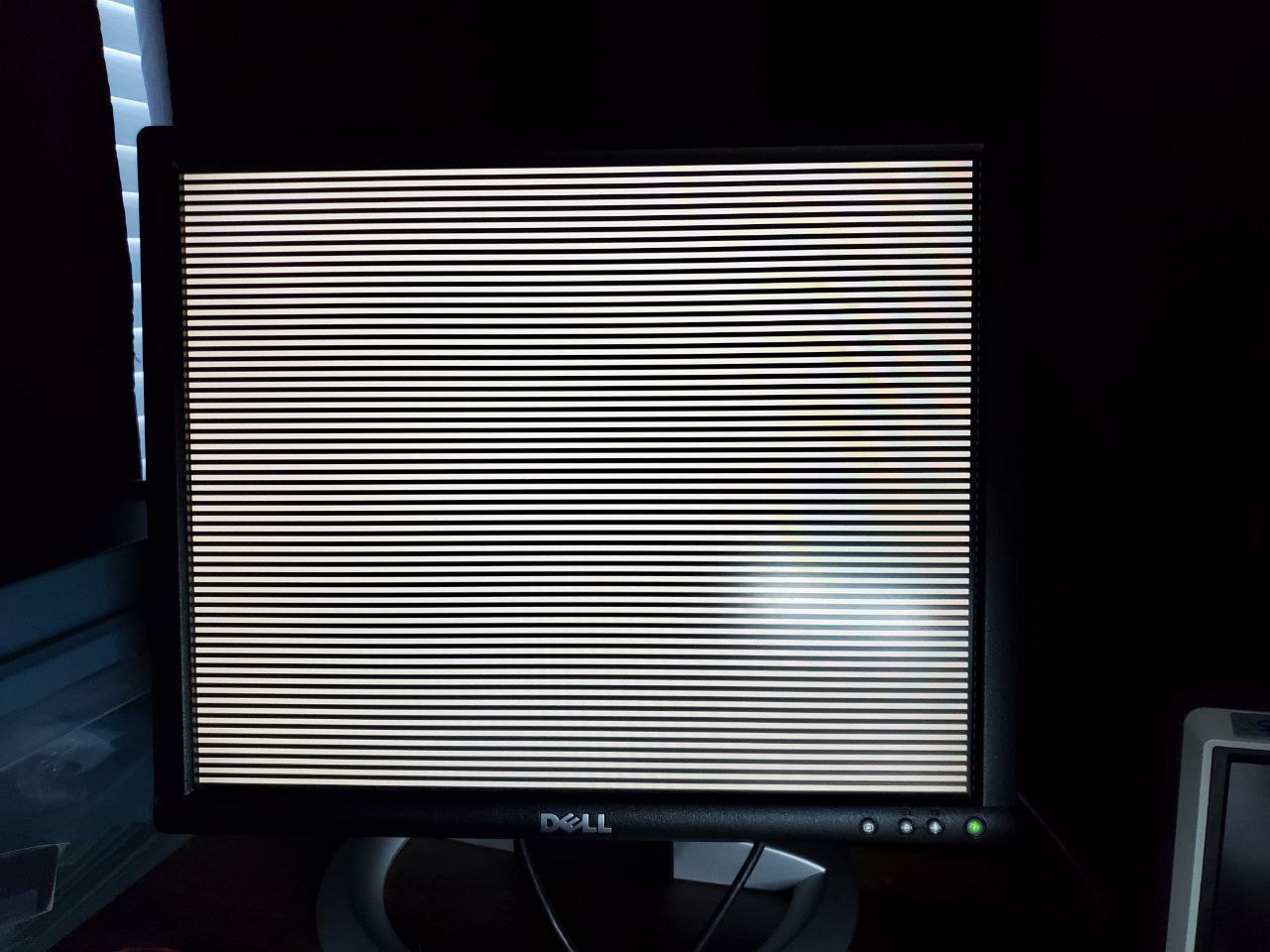

For the flickering though, maybe you could post a video that shows it, so we can see it? I do think that what J64C and BDD were saying is probably true if you're seeing flickering - something is wrong with the sync signals, maybe not all of the time. In my experience modern monitors are more fussy about the consistency than the specific timing. I always try carefully to get the official timing but it doesn't seem to matter much in practice - but if you get a random spike on one of the sync signals mid-frame then it can cause a lot of glitching.
I can, though at the moment it's pretty stable. (Also have to see if I can figure out how to record a decent video of any sort, that's not something I have any kind of setup for.)
There's the flickering and the drops.
I'm guessing the flickering I mentioned, is mostly due to the fact that the signal is getting trashed by going through that really terrible breakout cable I made, having fairly long unshielded wires, plus being loosely connected into a breadboard. Like I said, it's REALLY minor, it might not even show up very well on any video I take, and my suspicion is that it will get cleaned up if/when I move to a proper PCB for this.
As for the drops, I'm fairly sure a lot of that is more due to me sending pixel data in the blanking period than the quality of my signals. The 47 ohm resistor that J64C recommended helped a lot; but also I'm currently relying on the idea that the CPLD will stop telling the '299 to load character data at the right times, thus it will start shifting in 0s from the ground pin as the shift clock continues to run; if that gets off the shift register will continue to send pixels that are on, thus upsetting the monitor's circuitry that tries to workout what level "black" is. If it happens to do this when there's a white pixel being transmitted, then the screen goes dark for a frame or two. This can be exacerbated by selecting a different character to display.

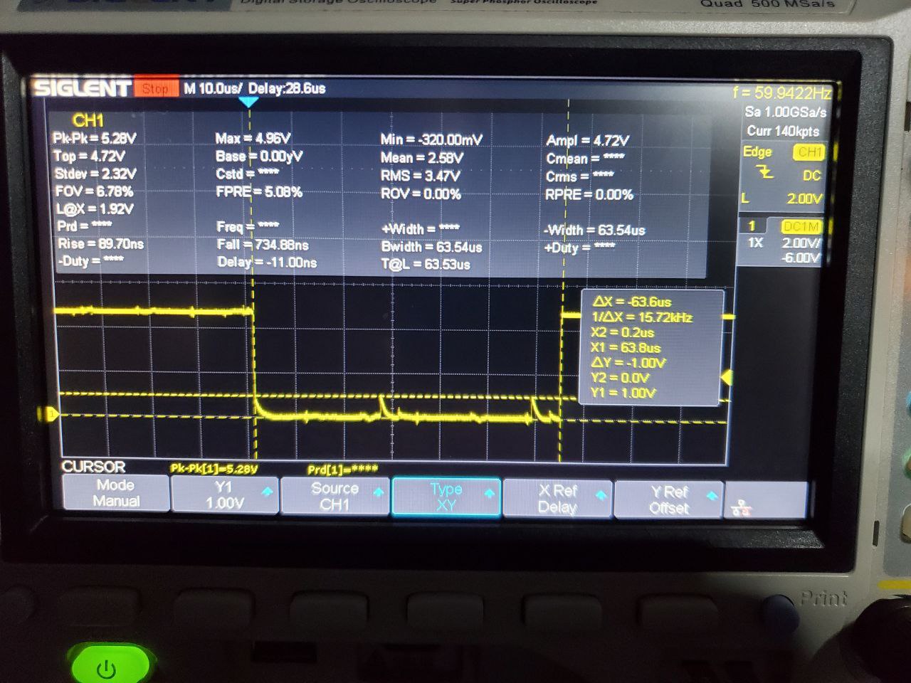

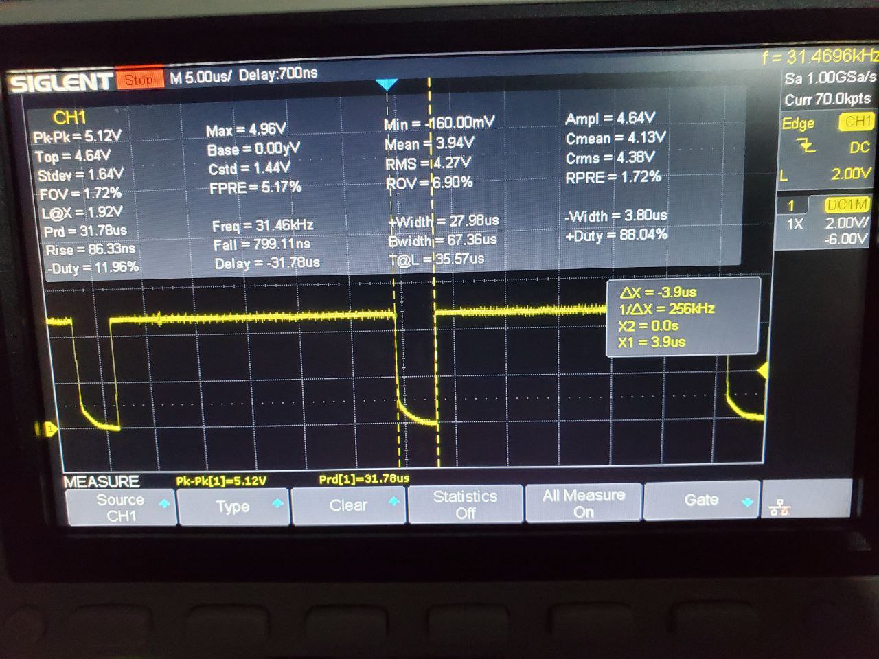

Horizontal Blank:
Vertical Blank:
It does appear there's a consistant 1V spike in the vertical blank there; less than TTL's 1.5 cross over point, but still in that grey area.... Hrm..... :?
Obviously he's not a perfect source; he's going for ease of explanation/understanding than being perfectly correct.* He does talk about the pulses being negative level logic, so I'm getting the impression that by polarity you mean something other than that.

What I'm seeing is the picture will drop for a couple of seconds.
* The number of time's I've tried to explain a programming topic to someone only for them to get confused by, or hung up on, the error checks in the example code..... x_x
Don't get me wrong. He's the reason I got back in to electronics, back in 2019. He's a fantastic source of information. But, I have found along the way that a couple of things, like the aforementioned sync polarity, would cause locking issues etc on some of my screens until I worked out what was going on. Was just checking that you aren't chasing your tail by replicating the same boo boo's. :lol:
You still haven't told us what your sync pulses are yet or what VGA mode you are running for that matter (unless I missed that somewhere).
I'm guessing that it is one of the 640 x 480 modes. Even though it is displaying ~626 pixels on the horizontal axis. The vertical looks correct at 480 pixels.
What clock frequency are you using? is it 25.175 MHz? Or are you rounding down to 25?
If you are using 25 MHZ, you will lose 8 pixels on the horizontal, which would account for why we are only seeing 39 characters.

As for the sync pulse timings, see my photos of my scope. :)
Horizontal is showing right around 3.9 usec (VGA Timing says it should be 3.81 usec)
Vertical is getting around 63.8 usec (VGA Timing says 63.5 usec)
Okay, so it is what I thought it was. I'm using negative sync pulses (I.e. normally high until sync, then goes low, see scope); this is what I see listed on the VGA Signal Timing website for 640x480 @ 60Hz
(Looks like positive going signals are for when you're doing 800x600 @ 40Hz)
However this did bite me, but for all of maybe 2 seconds when I was like, "is it negative to trigger sync or positive" and then looked it up.
Also helps that they are being fed through a 74HC86. I can very quickly switch them just by flipping the other input on the XOR.
That's what threw me as you labelled them as being horizontal and vertical "blanking period".
