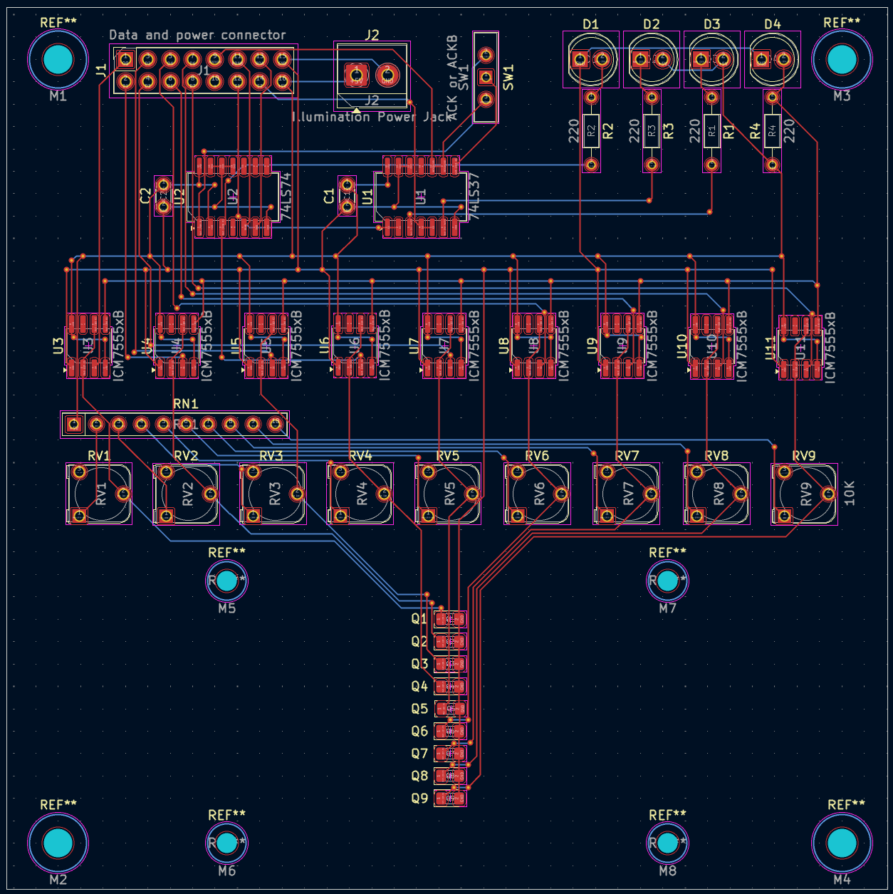

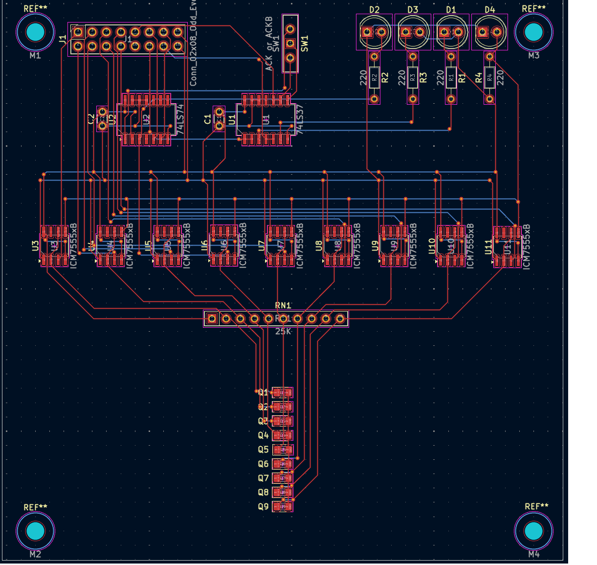

Designing my first PCB was an unexpected amount of fun, so I'm designing another one based on the obsolete OP-80a. It was a paper tape reader used by Altair users in the 70's. I don't know if paper tape was used by 6502 or 6800 users, because the Apple I and SWTPC 6800 used ROM monitors and keyboards for input. So, forum users might not be familiar with it.
My first step was reading through the OP-80a's schematics and documentation available online, reproducing the schematic in KiCad, and then doing a board layout. That way I understood how it works. Essentially it uses phototransistors to sense the tape holes, nine 555 timers configured as Schmitt triggers, with pin 5 supplying the reference voltage via an LED and 220-ohm resistor voltage divider. Eight of the phototransistors are for data lines with the ninth using the sprocket hole as the clock pulse.
The schematics state that all the IC's and phototransistors are sensitivity matched, so do not substitute any of them. I've used phototransistors as line sensors and wheel encoders for robots, and they do vary in their sensitivity. In my robots I use a trim pot somewhere in the circuit to compensate, which I think this design should have used. The question is where? Should the pullup network be replaced by nine trim pots, or the reference voltage to the 555 timers?
There's also the nagging question about using a 555 timer as a Schmitt trigger. Shouldn't a real Schmitt trigger IC have been used instead?
I hear you asking where do you get a paper tape in the year 2025? That's super easy, barely an inconvenience.
https://github.com/colemanjw2/ASCII2Pap ... me-ov-file
Also, my work so far is on my Github: https://github.com/Martin-H1/KiCad/tree/main/OP-80A

I might have been tempted to look for opto-sensors with a TTL output, and avoid the whole Schmitt trigger thing; control the trigger voltage with an LED per channel perhaps. But your motivation may differ.

I've updated the schematic and board layout with the following changes:
* After reviewing other schematics, the best course of action was adding trim pots to the phototransistors. I calculated the required resistance using the data sheet and came up with 25K. So, the resistor network is 20K and the trim resistors are 10K. That should allow fine tuning each data channel to equal sensitivity.
* Added a power jack to connect an IR illumination assembly above the phototransistors.
* Added four M2 mounting holes to allow connecting a paper tape guide above the phototransistors.
Changes were pushed to GitHub. I have enough parts in inventory to build a prototype, but I have enough on my plate, so I will back burner this for now. However, I like that no microcontroller was used in this design as I feel like that's overkill.
