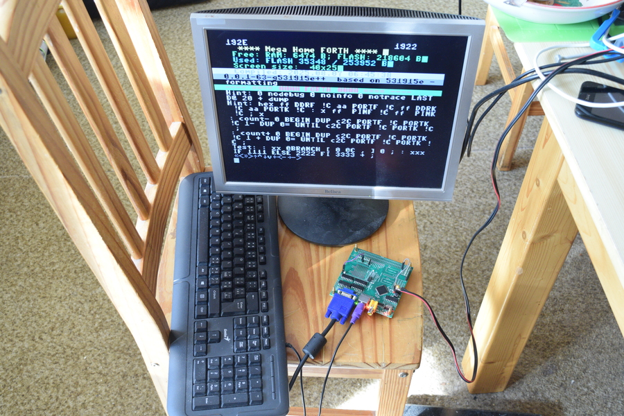

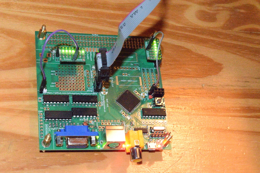

More background:
I am building my own 8bit computer around HD6309 (and maybe more varinants with 65*02 and Z80 too) and I want it to be able use VGA+keyboard, so I am building extra graphic card with ATmega2560 to provide this as simplified IO. I am developing the HW for this "graphic card" mainly here https://github.com/githubgilhad/MegaHomeFORTH
Graphic card in developement/testing
and it can also work as SBC on its own
Works also as SBC
Works also as SBC
and I found extremly usefull to use FORTH for interactive testing and "poking legs" / manipulating IO pins.
I first implemented something inspired by JonesForth but implemented in mix of C/C++/.ino/asm and with lot of debugging tools inside (memory dumps, range checking ...) and it somehow works, but I have constant struggle with data sizes (cell=16b, address=24b, double=32b, C uses __memx poniters, but C++ can use only uint32_t ...).
Also I am trying to have as much words in FLASH (~ROM) to save as much RAM as possible.
On atmega access to FLASH(~ROM) needs different instructions than access to RAM and program may be executed only from FLASH. So I am trying to write new, better implementation of FORTH in assembler (mainly), where everything will be 24bits/3bytes in size and rotines/macros will manage all important parts, where I know what I want to do, but C/C++ is not convenient for it. https://github.com/githubgilhad/memxFORTH-asm. I want to implement this one as fast running, as I hope to use it as part of firmware for the graphic card, which could be enhanced in runtime (where the 6309/6502/Z80 will send some routines to "atmega2560 coprocesor", both graphics and others to do in paralel). And generating VGA signal takes like 90% of time, for "normal work" can be used only blanks and borders, so speed is valued.
And later I will probably use the FORTH for the main (6309/6502/Z80) procesor too. It will be ofcurse written anew for the procesor, but probabely on the proven principles from its many predecessors :)
(I mean the variant for atmega328, the memxFORTH-core, the MegaHomeFORTH, the testing variant for PC, the memxFORTH-asm variant ... will continue with 6309 variant, 6502 variant and so ...)

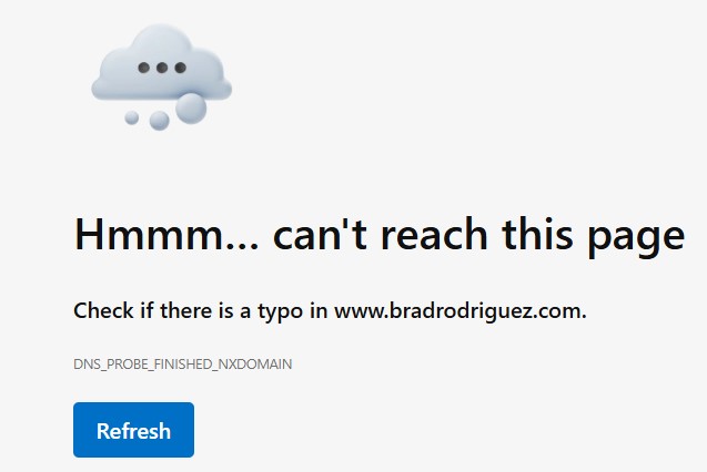

P.S. I was going to refer you to Dr. Brad's excellent articles that touch on this subject and more, but they seem to have fallen by the wayside.
Are you referring to this page?
For reasons above my paygrade, my browser tells me I can't get there from here at present:
Re: FORTH - empty stack with TOS in register(s)
I think that's just for you. Try https://browserling.com/
Interesting.  It doesn't work for me either, including on browserling.
Well that’s something I really can’t explain.
Posts: 9425
I just re-checked it and the page loaded, both with my regular browser (Seamonkey) and through Browserling.
