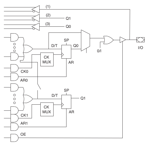

From the outside the '750 looks like a 22V10 - but under the hood there's a much bigger motor...
A complete macrocell (from <Using-ATF750C.pdf>)
To start with, there's twice as many accessible registers. This is achieved by splitting each of the 22V10s original registers into two independant Flip-Flops, and providing access to each of them via buried nodes (see table, below). Each of the F/Fs provide internal feedback, and 10 have the output drivers for driving the O/P pins. Each F/F can be individually configured as D-type or T-type (toggle) - using the terms xxx.d or xxx.t.
Note that combinatory logic still has the same large fan-in (note the switch symbol between the two F/Fs) : each half has from 4 to 8 product terms, the two sides are then summed.

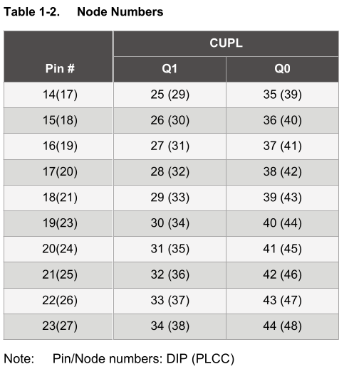

Buried node numbers (from &lt;Using-ATF750C.pdf&gt;)
Buried node numbers (from <Using-ATF750C.pdf>)
As with the 22V10, pins 14..23 on the '750 are configurable as Output or Input. Combinatory declarations will automatically configure a pin as Output, and will transparently enable the output enable term '.oe'. Registered declarations (i.e. using the F/F) can use the pin's Q0 F/F as a 'buried' node and define the pin as an input by forcing the '.oe' term to zero. It's even possible to use the pin as input AND output by careful synchronization of the register clocks and the '.oe' terms.

The next feature is that each F/F has it's own individual clock line with a selection switch to either use the 'master' clock (Pin1), or an internal signal, either a physical signal or a combinatory term. Each F/F clock can be either synchronous (by specifying '.ckmux'), or asynchronous (by specifying '.ck'). See the EX375 example, below.
And, to finish the list, each F/F has it's own Asynchronous Reset term, '.ar'.
