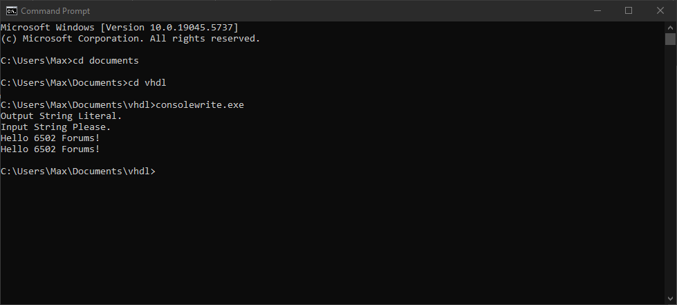

WHAT?!
-- Console Write Line program
use std.textio.all;-- Imports the standard textio package.
-- Defines a design entity, without any ports.
entity consolewrite is
end consolewrite;
architecture behaviour of consolewrite is
begin
process
variable l : line;
begin
write (l, String'("Output String Literal."));
writeline (output, l);
write (l, String'("Input String Please."));
readline (Input, l);
wait;
end process;

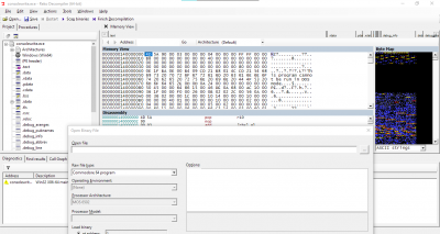

end behaviour;its fairly large, though there is way more windows code in there than vhdl, such is the beast of compiling to a modern 64b OS
here is a disassembly (of .o maybe) on dogbolt:
https://dogbolt.org/?id=fc80475a-6653-4 ... 1d0#angr=1
attached is a pic from Reko Disassembler, you can see a lot of WinFluff.
here is the intermediary code created by ghdl prior to compilation:
however, this is the .o file for that code, this is what vhdl 'compiles to',:

It is just ASCII characters, and this file, is fairly portable now. I should be usable on other platforms, though Im not 100% on that, from what Ive read, this file is the actual intermediary output. You can make text games in vhdl. If you can do that, you can do many other things. This uses about 0.5MB of resources on my laptop, +7MB of ram for the DOS window that runs it.
I have a similar ".work" file from Altera taken from edaplayground, so the level of complexity of a file, vs the output, vs how it is used is very dependent on the user
Now if we take that extra windows/64 away, its an ascii file that was compiled into something that displays a text box, gets input, and displays that input. I think porting this to 65xx, is a really cool idea. We can make a 'runner' that takes signals to and from. you can jam up any machine with any language if you try. we can Describe how we want our Hardware to work, in the Very High Speed, Integrated Circuit Language... with a simulation vs synthesis approach, and our 'os' can respond to its form of 'stdio' as we develop it to.
. Ill map the vhdl spec to 6502 operations on a spreadsheet!
(edit, replaced incorrect code file)
