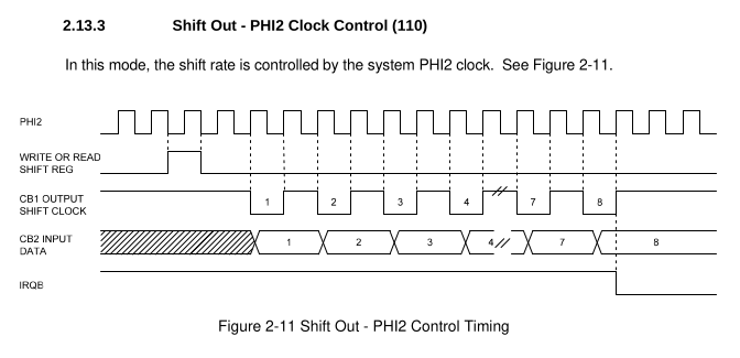

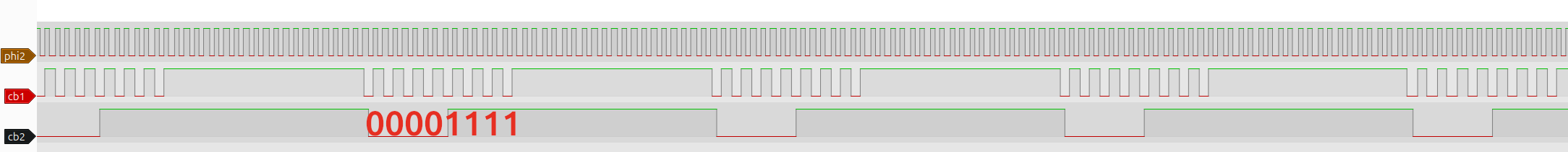

I'm attempting to understand the 65c22's shift register. In order to do so, I've written a small program to send $0F then $F0 in an endless loop through mode "110" (shift out under PHI2 clock control). However, the output (as seen on my logic analyser) isn't what I expected. I've attached both my code and the output as my understanding of the initialisation and handling of interrupt bits is probably deficient despite reading through the datasheet as best I can.
Firstly, am I right to say Fig 2.13.3 should refer to "CB2 OUTPUT DATA" and not "CB2 INPUT DATA"?
My code is here...

Using Fig 2.13.3 to compare PHI2 & CB1 - they look as I'd expect. But my interpretation of the output is that I can only see $0F being outputted. I've shown why I think this.
Any ideas as to what I'm doing wrong?
Thanks.
Dave
EDIT
Still tinkering, I tried just...
loop:
        lda #$0F
        sta SR                              ; Write to shift register.
        lda #$F0
        bra loop
And the output is better...
Yes, output.
Remember that under control of phase 2, each phase-2 cycle toggles (not cycles) the CB1 clock, meaning that a whole byte requires 16 phase-2 cycles.  Without trying it now, I suspect the problem is that you're writing to the SR while it's still busy, and the new byte gets ignored.
If you don't have the interrupt enabled, you can disregard the SR interrupt flag bit.  Edit: You could read the flag to see when the SR is ready for another byte; you don't have to explicitly clear the flag though, as that's done automatically by reading or writing the SR.
Is there a way to reset the shift register and start a new byte before the old byte has completely shifted out? (I thought that writing to SR would do this, but it seems not to.)
Re: 65C22 Shift Register - Some Guidance, Please?
I don't know, but you could try changing the SR mode before the byte is finished.
