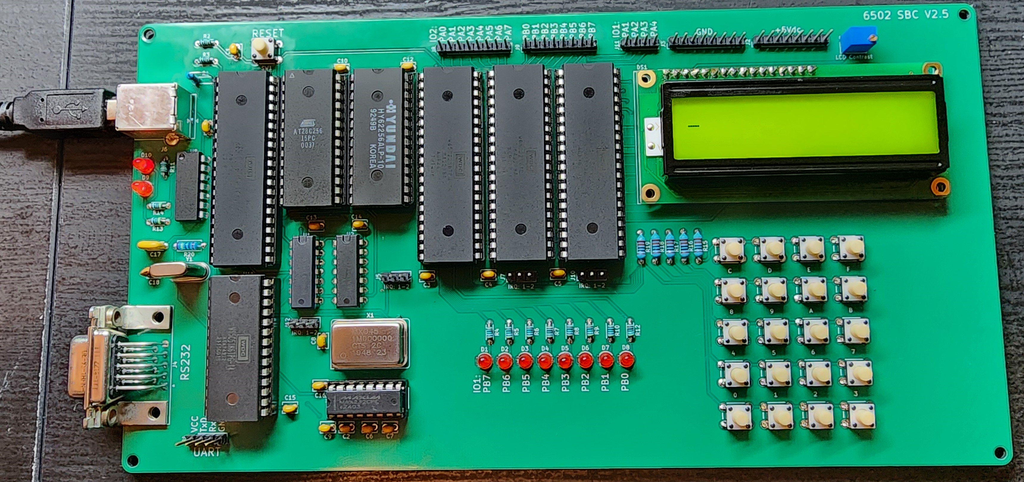

So after seeing the Ben Eater 6502 series on youtube i was hooked, and interested to learn more, designed my own board, and i am now on my 4th revision of a 65C02 SBC, being proud of my achievement, figured this would be a good place to share. I have no formal background in electronics or programming, just a hobby of mine, previously had spent a lot of time programming AVRs and Arduinos for various projects. So this tends to be setup more in that aspect. Board currently has 3 65c22s with 20 of the IO pins broken out to headers, a 65c51, 4x5 keypad, labeled 0-F for hex input, and 4 unlabeled buttons at the top , 8-leds, a 16x2 character LCD, a MAX232 for RS-232 serial and a Microchip MCP2221 for USB to Serial. Currently running software i wrote that will accept up to 2kB of code through the hex keypad(for fun) or sent over serial(much more practical), storing it to RAM and executed through a button press. I am sure my code is a mess as i am new to this hardware and fairly new to assembly, but hey it works, and it was for sure a fun learning experience!

That does look a rather nice (and traditional) board - though I wonder about the UART pins: how are they separated from the signals from the RS232 converter (or are they just for monitoring?)

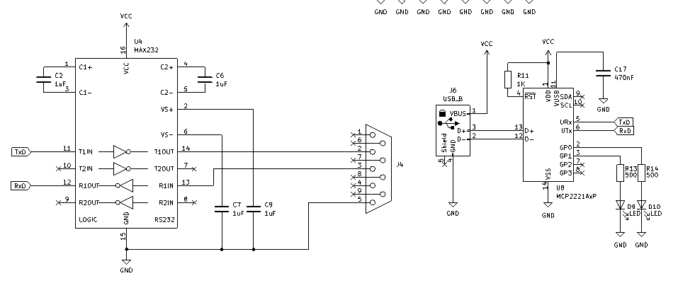

So i realized i hadn't tested the RS-232 port at the time of posting, just did and it doesnt seem to work, it worked in the previous prototype before i added the USB UART chip, i seem to have overlooked isolating the signals, probably should have added header pins and jumpers to select between USB UART and RS-232, similar to what i did with all the IRQ pins

If those uart pins are just across the TX and RX _TTL_ side of the 232 chip, they won't affect anything if they're not attached to anything else.
And the 232 chip generates the positive and negative voltages required for RS232 (if you have the right capacitors) and the CTS and RTS are pass-through (after level conversion) so they shouldn't affect anything... Worth a check that your RS232 TX line (i.e. from the board) sits idle at -3v or greater, and +5 on the TTL side.

I have -9v on the TX line, and 5v on the TTL side of the MAX232, however i think i found my issue, the -9v is on pin 2 of my DB9 connector, looks like i must have swapped the tx and rx lines at the connector. I think there was some confusion because with the USB UART the tx gets connected to RX, so i must have switched them at the DB9 connector as well
EDIT: Maybe not, looked at previous schematics and i changed nothing changed with the RS-232 circuitry, i will post schematics

According to 232 pinouts pin 3 of DB9 is TX, confirmed data at this pin with the scope, has to be something obvious i missed
EDIT: Black and white schematics

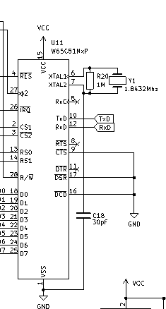

So it looks like it is wired correctly, i am seeing data at the 65c51 RX pin when transferring with both rs-232 and USB UART. However i noticed that the amplitude of the signal is lower when sending data over the rs-232, not getting pulled as close to ground as with the USB UART, so maybe it is not pulling low enough to register the bits?

The world's best 'standard' and counting... I do not believe I have got this right first time even once in the last fifty years...
DB-9 connectors for both male (DTE) and female (DCE) both use pin 3 to transmit data and pin 2 to receive. So you need a crossover cable.
But your drawing is either (a) the wrong way around or (b) requires a straight-through connector.

Ah, do you have the TXD and RXD from both IC10 and IC11 connected together? You can't do that... (my original concern) try pulling the IC11 out of the board and see if it works through IC10, or vice versa.

Got it, that makes sense, has to be the issue, i am certain that the RS-232 worked before adding the MCP2221 circuitry. I had questioned it numerous times but after i already had the board out to be made, i will test removing the MCP2221, and will most likely add pin headers/jumpers to switch them
UPDATE: Removed the MCP2221 (unfortunately was soldered in, didnt have the right socket for it when i assembled the board) and the RS-232 works correctly now. What would be the recommended way to have both of them available? The USB UART is much more convenient as it powers the board as well, something about the RS-232 port just feels official though, even though i am just using a USB RS-232 cable. If i have another board made, i might just add little dip switches, or pin headers to disconnect the MCP2221 from the UART circuit, in the mean time i think socketing the the MCP2221 (like i originally planned) and removing the chip when i want to use the RS-232 would be the easiest solution

It might be useful in the future to use a jumper block with CTS, instead of hard-wiring it to ground.  You may wish you had that arrangement the moment you speed up the interface past 9600 bpS and RxD overruns start to become a nuisance.  “Soft” flow control above 9600 is usually unreliable, especially with a UART with no RxD FIFO.

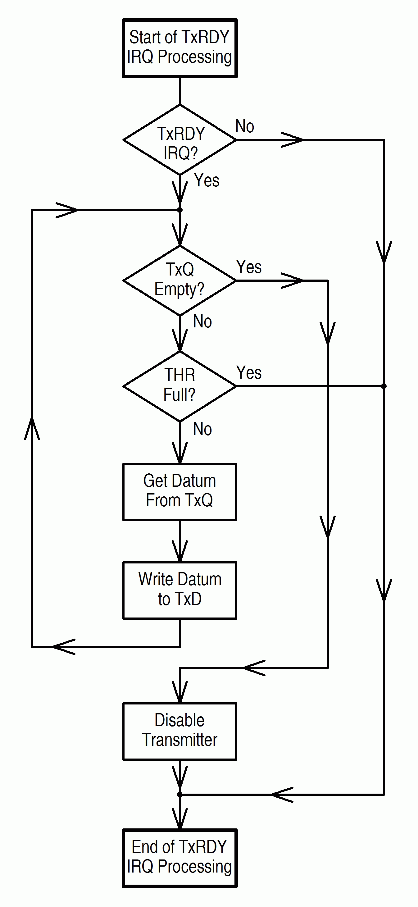

At the risk of being Captain Obvious, the first step is to understand the task to be carried out.  This is especially true when writing a device driver—a potentially-complex undertaking, which is what you are doing with the 6551.  In the case of a device driver, you should fully read and understand the data sheet (especially the “gotchas”), and perhaps post questions here if something in the data sheet isn’t clear—data sheets vary widely in lucidity and accuracy.  :?
Once you understand (or think you understand :D) what has to be done and also understand the device to be driven, the next step is not to write the code, but to write a narrative that explains how your code is going to work.  The narrative should be phrased as though you are explaining your program’s operation to someone who is not familiar with the task at hand.  As Garth has often noted, doing so helps you define the program flow, especially the difficult parts of an algorithm.  I always go through this process before I write the first line of code—it has never failed me.  In a few instances, I’ve drawn a flowchart to clarify my thoughts and help me understand the require workflow, e.g.:
26C92/28L92 TxD Interrupt Service Flow Chart
I drew the above when I was developing the device driver for the NXP 26C92 dual UART (DUART) in my POC V1.1 unit.  The challenge was in writing code that could work with the device’s transmitter FIFOs so as to reduce the frequency of interrupts, while also using a minimum number of instructions to get the job done.  Also, being a dual UART, there were two channels to be serviced, which, of course, complicated things.
Working on the theory that one picture was worth a thousand words, flowcharting the process proved to be the quickest way to develop a workable algorithm.  The driver worked on the first try, which was a good thing—debugging a misbehaving interrupt handler can be quite a challenge.  :evil:
