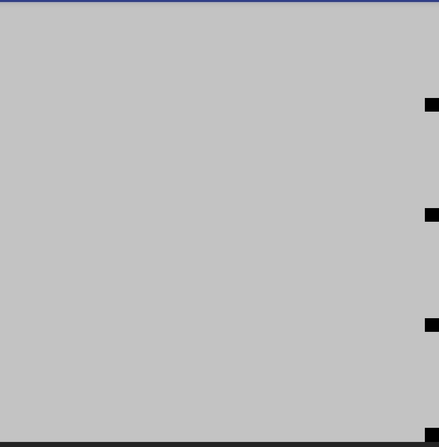

I am new to 6502 programming. I wanted to make a game using this assembly language. My first program fills the whole display with white pixels.
ldx #$ff
lda #$01
drawPixel:
    dex
    cpx #$00
    sta $0200,x
    sta $0300,x
    sta $0400,x
    sta $0500,x
    bne drawPixel
    brk
However it is not doing it correctly. It stops before the last pixel so it doesn't fill some pixels. How do I make it fill every single pixel?
Result
Result

Can you see why your code doesn't work? It's worth spending a little time walking through it yourself instruction by instruction to see exactly what it's doing, and think about how that differs from what you expected.
Spoilers below:
I assume you have a 32x32 display, with each pixel being represented by one byte in the range $0200 - $05FF. To clear it, you want to write to every byte in this range. You're counting down to 0, which is an idiomatic thing to do on the 6502 as many instructions automatically set the Z flag. So you want the first bytes to be written at $02FF, $03FF, $04FF, and $05FF.
Your code loads X with $FF, which you'd think would be right. But the first thing it does is decrement it, so the first time through the loop it's actually writing to $02FE, $03FE, $04FE, and $05FE. What you want is for X to be $FF after that first decrement. Loading it with $00 will do that.
I said before that many 6502 instructions automatically set the Z flag. DEX is one of them, so you don't need the CPX #$00 after it. It's not wrong to leave it in, but idiomatic 6502 code will omit it. It's worth noting that STA doesn't change the flags, so although separating the branch from the instruction that sets the flag makes me nervous, there's nothing wrong with it.
This code should work:
ldx #$ff
lda #$00                             ; changed $ff to $00 so the first writes are to $xxff
drawPixel:
    dex
                                          ; removed cpx #$00 as it is redundant
    sta $0200,x
    sta $0300,x
    sta $0400,x
    sta $0500,x
    bne drawPixel
    brk

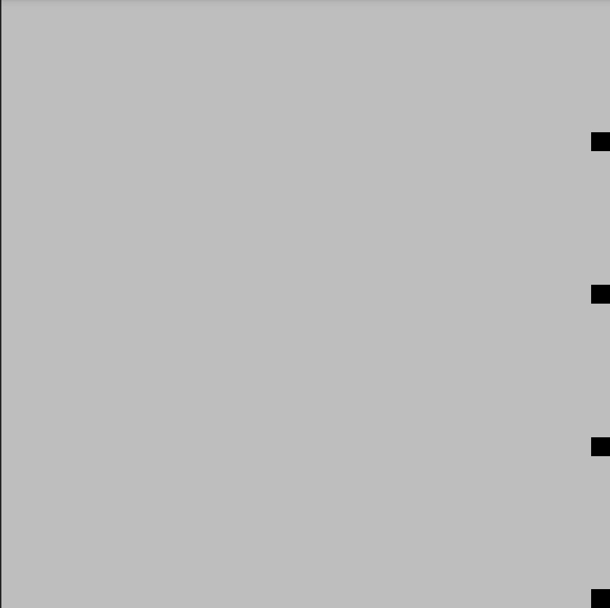

Well first I did check multiple times what happened its just the same result everytime. I did notice that the DEX decrements it and makes it 2FE 3FE... But shifting the position of DEX makes it end before a pixel. Using your code the same result happened it still started after a pixel.
New result
New result

I think John's code has an issue in that he changed the value of A to $00 instead of X - this should have been changed to $00.

Ok I fixed somethings and it's now fixed. Basically your code is almost correct but the problem is that your setting the LDA to $00 instead of LDX I mean the LDA is used for setting the pixel color and setting it to $00 dosent change anything because the position (LDX) is still $ff. I did a idiotic thing trying to count down from $ff so now I fixed it and it now counts from $00. Thank you for your code it works :D .
