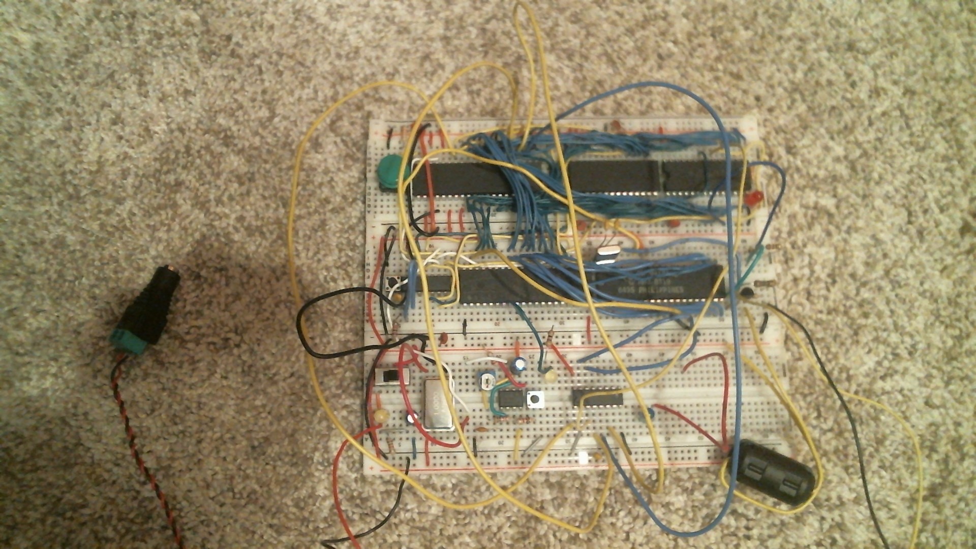

Here is an image of the board so far (ill probably get it all soldered when this issue is resolved)
The board
The board
Btw im using an sn74hct138N for memory decoding wired as so to the 65C02:
Enable pins:
G1 -- A14
G2AB (low-enable) -- A15
G2BB (low-enable) -- A13
Decoding pins:
A -- RW pin on 6502
B -- gnd
C -- delayed signal from WR pin (same as from Ben Eater's RW signal delay through nand gate for interfacing to ram chip.
Output pins are Y0 and Y1 which go to the tms9918a's write and read pins 14 and 15.
I am almost done with the basic wiring schematics for this build, and the everything else seems to be working while outputting patterns to the 6522 output
Thx for your input :wink:

I finally figured it out- other than all the other chips on the board the tms9918a used quite a bit of power and thus needed a more direct way of obtaining it then being hooked on multiple power lines above and below it. After adding a ground and power jumper to make it more directly attached to a non-fluctuating power source it is now working properly. Thank you all for trying to help me when this was something I should have tried long ago :D
Re: Help with Tms9918anl losing signal when background chang
I doubt that the problem has to do with power consumption, but that adding power and ground connections reduced the high-frequency impedance of the signals' return paths from one IC to another.  Please see the AC-performance page of the 6502 primer, particularly from the paragraph immediately above the first picture to the three paragraphs following that picture for an explanation.  (Actually, I would encourage you to go through the entire 6502 primer.  It was written to answer questions and problems that kept coming up on the forum, and has 22 logically organized pages, so it's good to go through them in order, as earlier pages generally lay the foundation for later ones.  Updates are applied frequently.)
