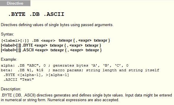

I use the interactive help Kowalski provides in the right pane. For example, if I cursor near a .BYTE directive in my source:

Re: Need help with Kowalski assembler syntax
What version of the Kowalski assembler are you using?
Also, are you sure your ORG statement is $0400 vs 0400?
I created this source:
And the disassembly was correct.
This is on the latest version from my website -> https://sbc.rictor.org/kowalski.html
Cheers!
