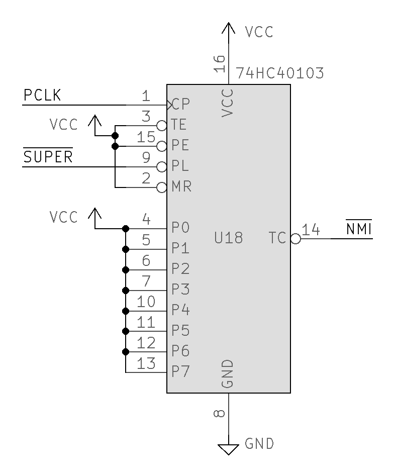

I thought about some amendments based on the discussion and bugs in the old circuit. I think I can fix the following fairly easily:
  • Make activating super mode depend on reading PID rather than writing it
  • Make the top bit of the pagetable control writability, so that shared pages can be read-only
  • Add missing NMI-driving circuit
Using the top bit of the pagetable for writability means there are only seven bits left, enough for 128 physical pages; and as each process requires at least one page, that means the effective number of processes is reduced compared to the previous design. The only way around that would be to have a wider pagetable. I seem to remember that Andre's MMU, for example, had 12 bits of storage, which was handy for this (he had more permission bits, things like non-execute pages). It also means we can only address 512K of RAM now, unless other things in the system are changed (larger pages).
The old logic to drive the two RAMCS signals, the RAMWE signal, and the PIDWE signal, was as follows:
I can replace that entire IC with a 138 and do it like this instead - sacrificing the two banks, and using the PTD7 signal (high bit of pagetable) to disable writes to pages that are mapped read-only:
Note that RAMCS is active high.
In this scheme, if PTD7 is low then the page is read-only - in that case the '138 is disabled and nothing is selected for read or write. This is only intended to be applied to the paged RAM, but will also affect the PID register as a side effect - so I will need to ensure that PTD7 is set correctly on the logical page that the PID register falls in. That's irritating but not hard to initialise on system startup.
I've had to add a RAMOE signal there that wasn't in the original schematic - this is so that, when writes are inhibited, the RAM does not fall back to driving the data bus, conflicting with the CPU that's trying to execute its write operation.
The new PIDOE signal can now be used to trigger the exit from supervisor mode, with a delay until the next SYNC, just like I did before using PIDWE. The exit code will now look something like this:
    sta PIDREG  ; set user's process ID
    pla         ; restore user's A value
    bit PIDREG  ; trigger exit from supervisor mode after next instruction fetch
    rti         ; switch to user mode, pop flags and program counter from stack
The corresponding entry code at the start of the interrupt handler can be just:
    pha         ; push A to user's stack
    stz PIDREG  ; switch paging to kernel's process
with no effect on the SUPER flag, which was already set by the vector pull.
I've also thought a bit about the watchdog-style timer for enforcing premptive multitasking - I think it can be this simple:
This will count down from a chosen value and trigger NMI. Entry into supervisor mode will hold the counter at its preset value, preventing NMIs while in supervisor mode. The clock source could be PHI2, but that might interrupt processes too often. It could be SYNC instead, or I could just use an independent clock source like a horizontal or vertical sync pulse, or a slow crystal oscillator.
I was concerned about what would happen if the count expired during an interrupt sequence, before the SUPER flag is set. There's an interesting thread about that here from over a decade ago, with a visual6502 test case that I've adapted here. This in particular executes a BRK instruction, and arranges NMI to briefly go low at a certain point so we can check the effect. NMI is only recognized if it goes low in the second half of the cycle (PHI2 high) - according to the 6502 datasheet I believe it is being sampled at the falling edge of PHI2. So for our purposes here we need to set odd values for "nmi0=" in the URL and the next even value up for "nmi1=" to turn it off again.
The point I've set it in the link above triggers NMI at the latest point where it will redirect the BRK into being an NMI (changing the fetched vector). Any later and the NMI is ignored completely, unless it occurs at the end of the second vector fetch, in which case it is recognized and triggers on the next instruction instead. I don't want this to happen in my case, but that's OK because as soon as the vector fetch begins, the SUPER flag gets set, and the 40103 downcounter will be reset, so the NMI won't occur that late.
There is a problem here though because if the NMI takes over the BRK instruction, the BRK is not executed at all - I believe this is a well-known NMOS bug. This is because the BRK incremented the program counter during its first two cycles. I believe this is fixed in the 65C02, but it highlights that this investigation in visual6502 might not be the same with the newer CPU, so it probably needs some practical testing with hardware in controlled circumstances. I'd love to hear if anybody has already done this.

gfoot wrote:
The JMP in RAM is tricky because if that RAM is paged then changing the PID will change which RAM is visible there.
I see you've moved on with ingenious ideas, but just to backtrack for a second, I don't quite see a problem here: the temporary JMP could be in supervisor space, as it doesn't have any effect until executed, and then it's done with. Changing the RAM mapping on the next sync doesn't hurt (I think!)
Re: Fairly complete multiprocess computer design
Posted: Tue Dec 05, 2023 12:38 pm
by gfoot
Ah yes I think it would work if I made it apply at the start of the next sync - I initially thought it wouldn't though because currently it applies it at the end of the sync, which would be after reading the JMP opcode but before reading the operand.
