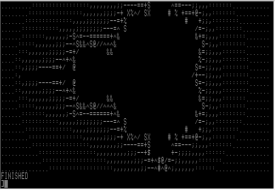

WOZ BASIC errored out almost immediately with your modification, but was able to render a less accurate version of Gordon's original in about 696 seconds @ 1 MHz:
  100 REM PR#3 FROM > PROMPT FIRST!
  105 PRINT "MANDELBROT - WOZ BASIC"
  110 PRINT "START"
  130 DIM Z$(17):Z$=".:,;-=+^/%&S$X#@ "
  140 F=50
  150 FOR Y=-12 TO 12
  160 FOR X=-49 TO 29
  170 C=X*229/100
  180 D=Y*416/100
  190 A=C:B=D:I=1
  200 Q=B/F:S=B-Q*F
  210 T=(A*A-B*B)/F+C
  220 B=2*(A*Q+A*S/F)+D
  230 A=T:P=A/F:Q=B/F
  240 IF P*P+Q*Q>4 THEN 280
  250 I=I+1: IF I<17 THEN 200
  280 PRINT Z$(I,I);: NEXT X
  300 PRINT : NEXT Y
  330 PRINT "FINISHED";
  350 END

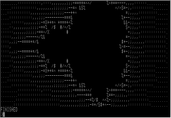

Applesoft renders a much better image, but takes about 860 seconds @ 1 MHz:
100  REM PR#3 FROM ] PROMPT FIRST!
105  PRINT "MANDELBROT - APPLESOFT"
110  PRINT "START"
130 Z$ = ".:,;-=+^/%&S$X#@ "
140 F = 50
150  FOR Y =  - 12 TO 12
160  FOR X =  - 49 TO 29
170 C = X * 229 / 100
180 D = Y * 416 / 100
190 A = C:B = D:I = 1
200 Q = B / F:S = B - Q * F
210 T = (A * A - B * B) / F + C
220 B = 2 * (A * Q + A * S / F) + D
230 A = T:P = A / F:Q = B / F
240  IF P * P + Q * Q > 4 THEN 280
250 I = I + 1: IF I < 17 THEN 200
280  PRINT  MID$ (Z$,I,1);: NEXT X
300  PRINT : NEXT Y
350  END

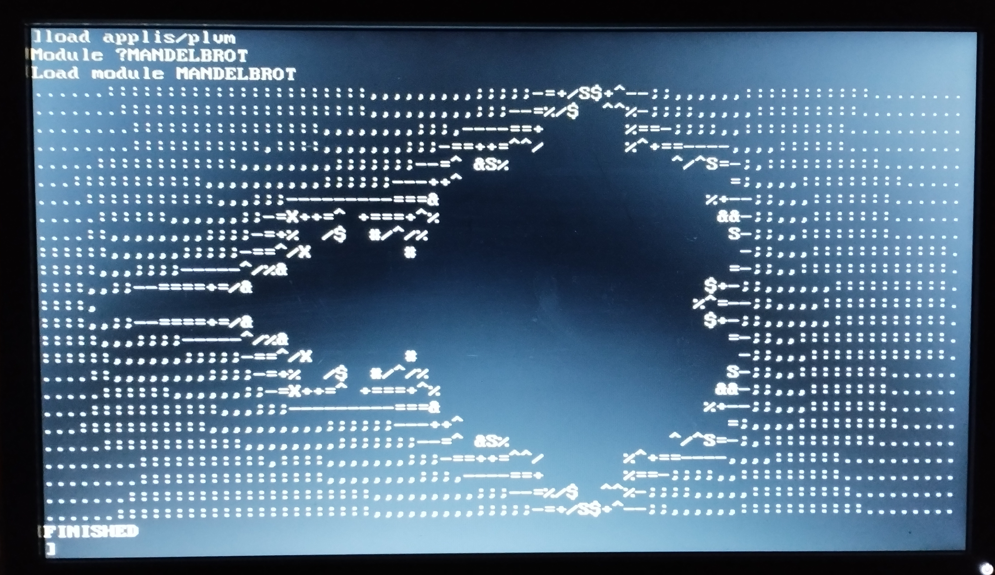

I was looking for something simple to try out with my rather cumbersome (*) but all the same operational PLASMA Virtual Machine running on the Pico6502. I chose to adapt the Apple][ version that appears above. So the code becomes
[edit] BTW "word" in PLASMA means a 16-bit object.

If I run it through the 6502 VM, I get this picture
Picot_6502 Mandelbrot
(*) I can't give any timing for the moment, because the "Pico6502" VM is, in fact, the linux version pushed through cc65 - with stdio and all the rest of it - and it spends 80% of it's time messing around with the C stack and only 20% doing any real work. More news soon on a more "native" 6502 version.

Hi all,
I have now successfully ported the PLASMA VM to the RP6502 "Picocomputer" in native ASM + Plasma.
It's probably because you're all so far away that I couldn't hear all of the "HOURRAA"s
Anyway, the above code completes in the native VM (bytecode interpreter) in 21.73 seconds. The 65C02 is being clocked at 7.5MHz, 'cos I'm getting fileIO errors at 8MHz. *AND* I had to cheat with the timing, the API entry for reading clock ticks doesn't work currently...
Have a great Sunday y'all.
