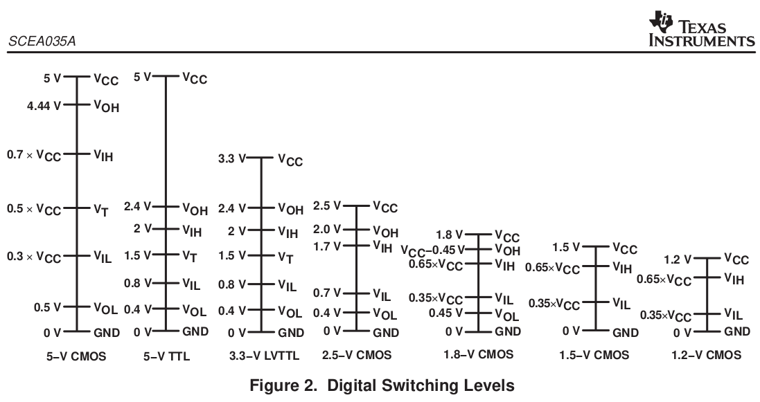

To finish-off this diagram, from the TI document "Selecting the Right Level-Translation Solution" posted by Dr J, shows the trend :
Digital Switching Levels Compared
... and from the same document, this little snippet :

I've ordered a few different memory ICs, more news when my WBC is wired-up.

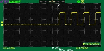

Time for some examples I guess.
viewtopic.php?f=3&t=5728 It the write up of the Atom build I did, you'll note from the first board there's an Alliance AS6C62256 32k ram on there with an older 10MHz W65C02. The date code of the ram isn't clear, but it's 1127.
I've put the older video card on the backplane, with nothing else fitted and checked the outputs on a scope. In this case the memory is the smaller AS6C6264 8k device, date code 1249. Slightly newer but not ecaxtly new.
AS6C6264 date code 1249 D0 output
That't driving to the rail.
For reference the MC6847 doesn't drive quite so hard, but still a respectable 4v+

I come from a Z80 background, and the CMSO Z80 is TTL compatible, when it came to buiding the Atom build, the only ram chips "in stock" were the AS6C type. To be honest I didn't even check the specs at that time, I just used what I had.
That said neither board pushes the ram past it's limits in terms of loading, access times etc. the signals do have to to estsblish themselves. The CY7C and even newer AS6C may be totally different construction and might give different results.
The chips I have, they've not let me down so far.
