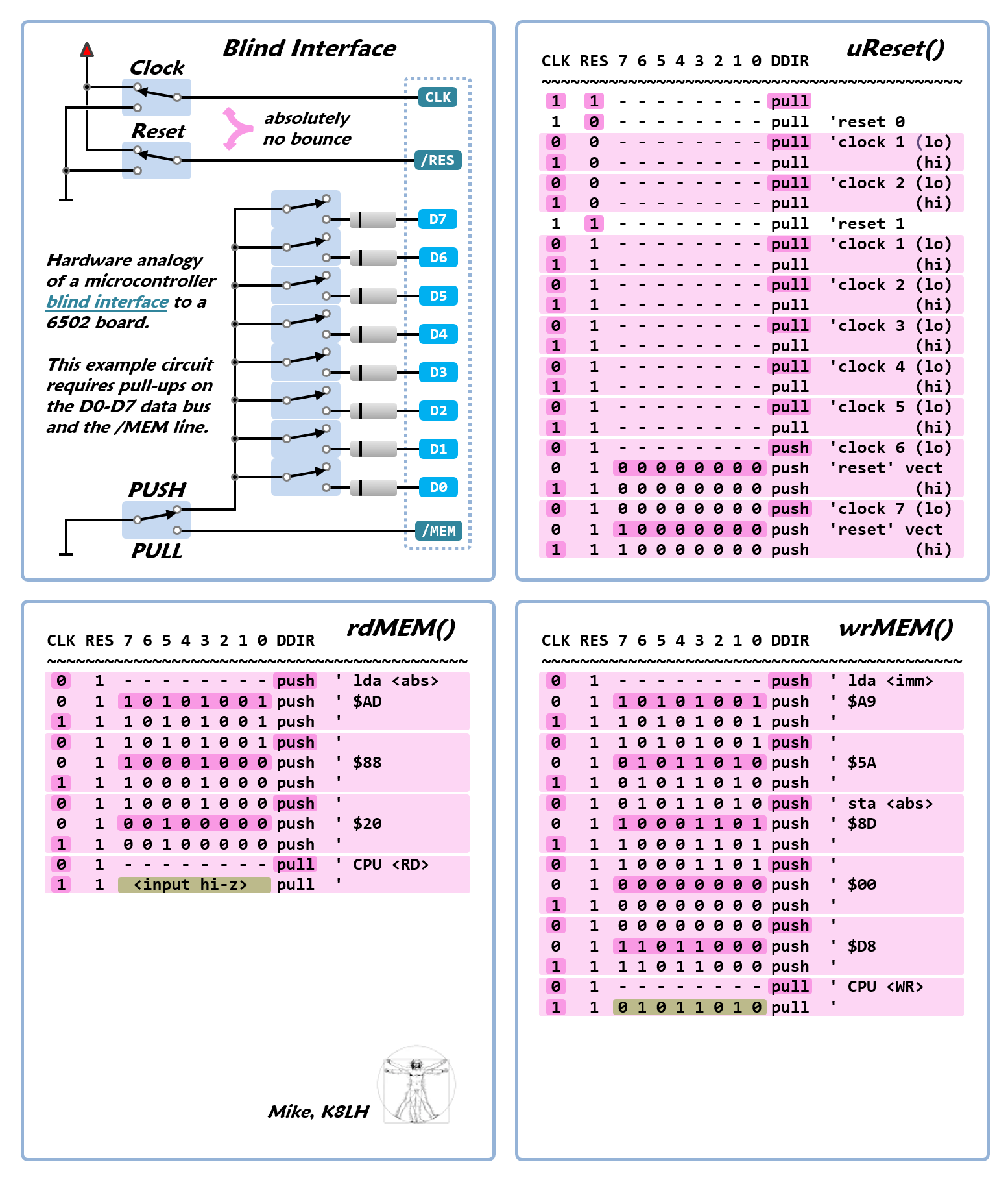

I noticed one anomaly (or feature?) while manually clocking a 6502 through the reset sequence using a microcontroller with a "blind interface" to the 6502. When I accidentally started the reset sequence with CLK lo instead of hi, effectively issuing 1½ clocks instead of 2 full clocks while RESET was lo, I needed 8 clocks instead of 7 clocks to load the reset vector after setting the RESET pin hi. Knowing exactly how many clocks is important for synchronizing the uC "blind interface" functions to the CPU.
