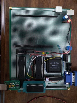

And here are some photos of the prototype.
This is the top of the board (component side):
Prototype board, component side
This is the mess of wires on the bottom (along with SMD caps and resistors)
Prototype board, wiring side

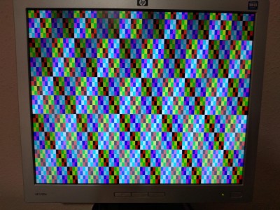

This is the test pattern the video controller displays before the processor starts running:
Video controller test pattern

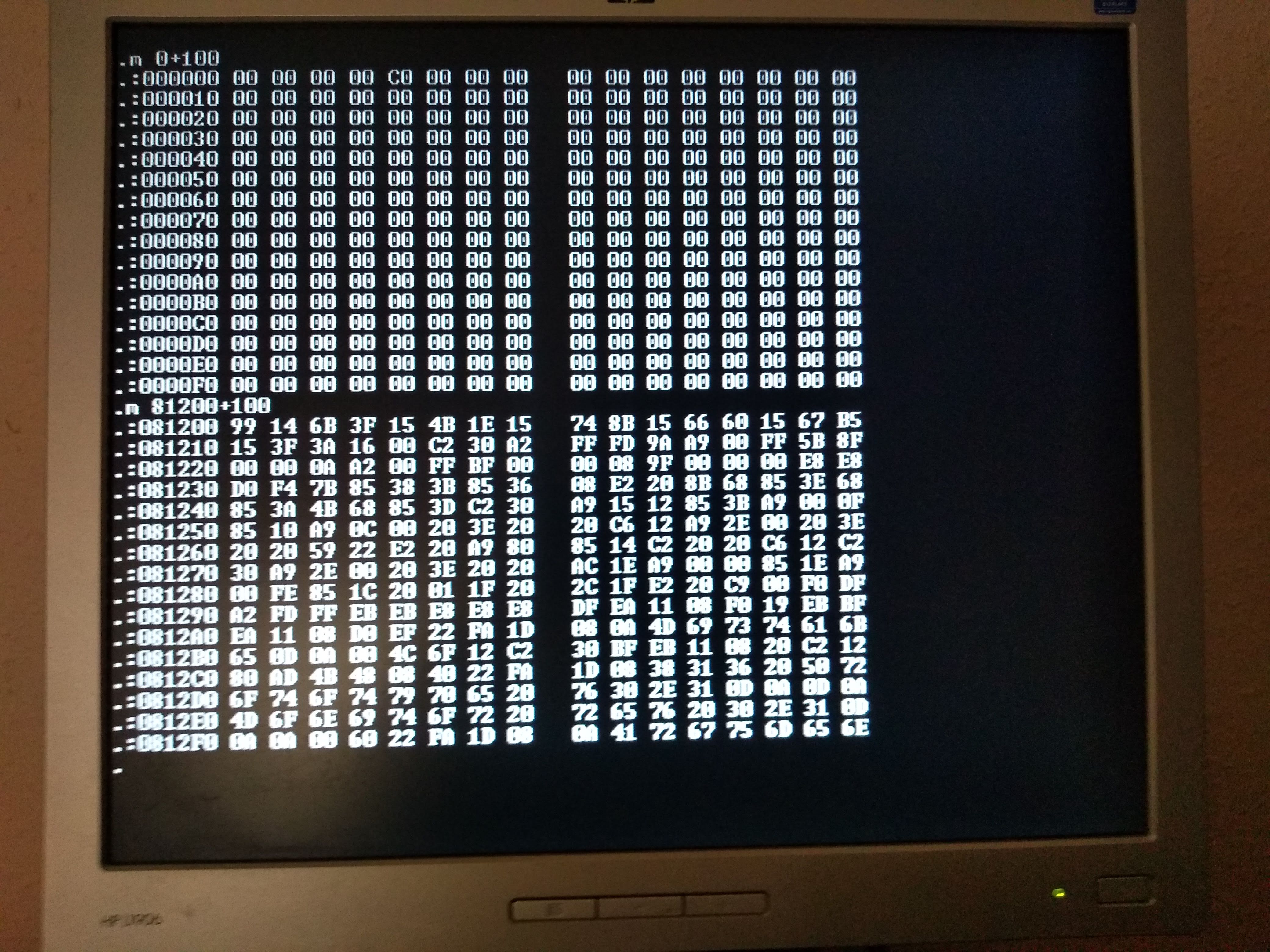

This is a memory dump from the system boot monitor on the video display:
Black & white text
Black & white text

Like this design a lot. I have 6502 sharing the memory with video at 12.5mhz, but 65816 certainly provides more memory for the graphic. I have used FT240 in one of my designs and really like the high speed transfer and simplicity of the interface. I think it is an excellent choice for data intensive graphic hardware.

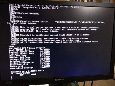

I've now got a rudimentary port of BBC BASIC v2 running on the board. It's the full interpreter as found on the BBC Micro, but lots of the MOS features are currently missing.
ClockSp runs and gives the correct result for a system running at 12.5MHz.

Got BASIC v4 running at last, and as expected the floating point is considerably faster - the trig/log test is just over twice as fast.
The list of things which needed to be changed was as follows:
  • 1. Two instances of JMP ($020E) needed to be changed to JMP OSWRCH since my MOS implementation doesn't have OSWRCH vectored through page 2
    2. All uses of TXS replaced with calls to a routine which performs S = $0100|X
    3. The Basic4 floating point code relies on the fact that the zp,X addressing mode calculates the effective address modulo 256 on the 65C02 - if the sum of zp and X exceeds 255, it wraps within page zero. On the 65C816 it doesn't do that - it produces an effective address in page 1. The wrapping behaviour allowed some loops to be coded starting with a negative value of X and incrementing towards zero, using the zero flag as a loop termination indicator. I had to change these loops to increment upward from 0 and add a CPX instruction to test for the end point.
    4. Items 2 and 3 above increased the code size above 16KB. The last page of the Basic4 ROM image contains a table of floating point constants used to evaluate transcendental functions. The code assumes that this entire table fits into a single page - it refers to the constants with 8 bit addresses and assumes all the addresses have the same top 8 bits. The increase in code side meant that didn't work any more, so I had to relocate the table to nearer the beginning of the ROM and ensure it was all in one page.
