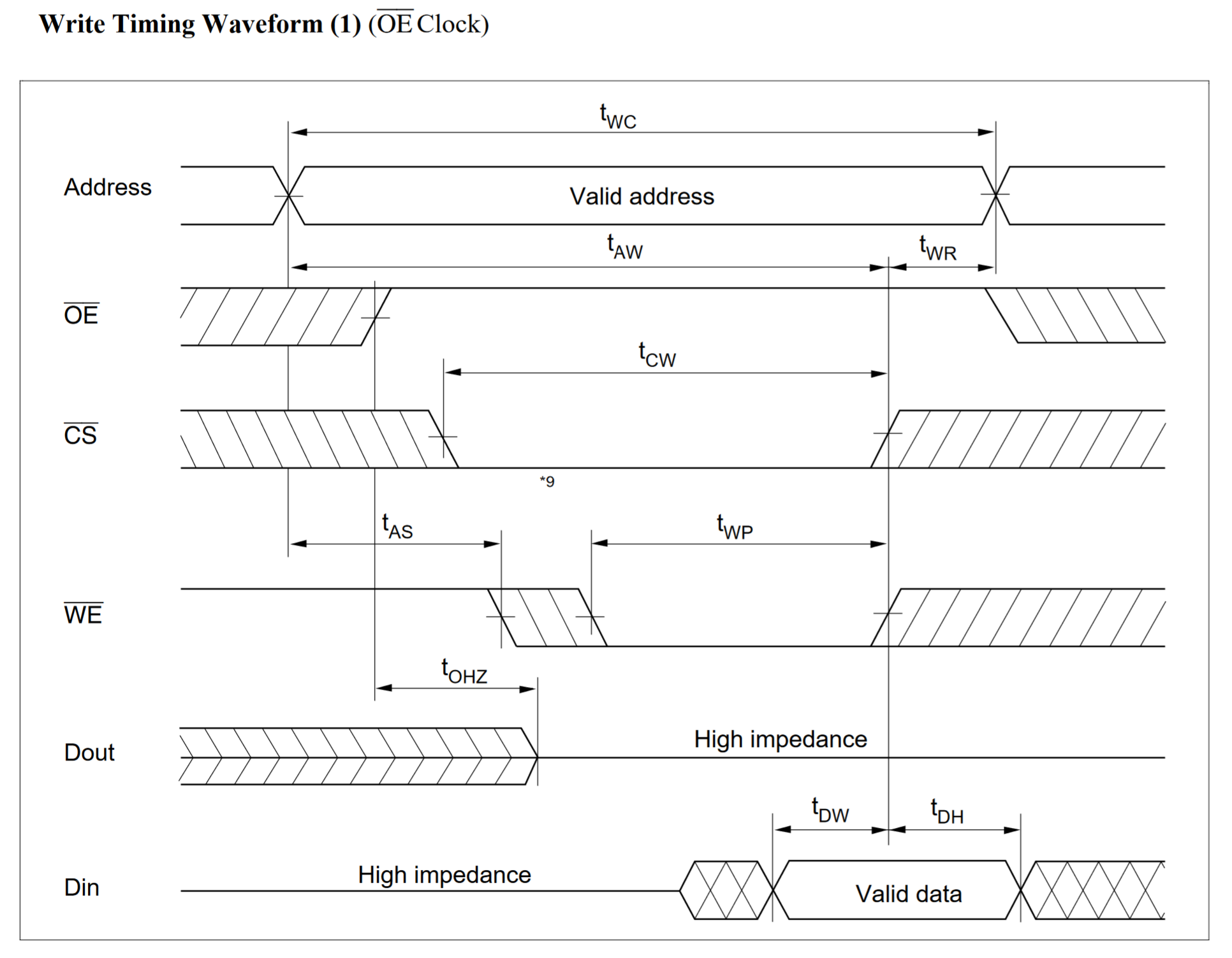

Also, the datasheet for my RAM has this note about the write operation:
9. If CS goes low simultaneously with WE going low or after WE going low, the outputs remain in the high impedance state.
I initially thought this means that if R/W somehow wins the race and goes low before or at the same time as CE, that the write operation won't work, but Ben Eater built his computer with R/W going straight to WE seemingly without any issues. So, what does this actually mean?
Timing diagram it refers to:
RAM Write Timing Diagram
  • 9. If CS goes low simultaneously with WE going low or after WE going low, the outputs remain in the high impedance state.
It depends on the SRAM you’re using. Some are fussy about the order in which the control inputs are asserted and others are not.
In my POC unit, I use an ISSI 128KB SRAM, whose data sheet doesn’t give any exact description of what will happen if /CE is asserted after /OE or /WE has been asserted. However, the timing diagrams indicate that response to /OE or /WE is faster if preceded by chip select. Ergo the technique of gating chip select with Ø2 will slow the device’s response, especially if /CE is continuously asserted, as I’ve seen in some circuits.
Bottom line, best performance will be seen by not using Ø2 to qualify chip selects. This will be especially important as you work toward higher clock speeds, since you are already on the path to a lot of prop delay in your glue logic. Instead, qualify /WE with Ø2 in a 65C02 system, and also qualify /OE with Ø2 in a 65C816 system. Qualifying /OE with Ø2 in a 65C02 system is optional, but won't hurt performance if done right.
By the way, all control inputs to 65xx devices (6520, 6522, etc.) must be stable prior to the rise of Ø2. These devices will not operate if you gate any of their control signals (RWB, CS1, etc.) with Ø2.
It's not a race; it just means that while both WE\ and CS\ are low, the outputs won't be enabled, regardless of the state of OE\. If you do have OE\ low, and then take CS\ low before WE\, there will be that short time that it tries to put something on the bus, and there will be that short time of bus contention if the processor is also driving it, whether either one has arrived at a valid value to drive or not. Note that there's no txx specification for a relationship between CS\ and WE\, or between CS\ and OE\, or between OE\ and WE\.
Well, it won’t be very speedy. :D
That was my first thought when he said he wanted to use a 74HC682; but I had to remind myself he said "I intend to use 5V at 1 MHz."
