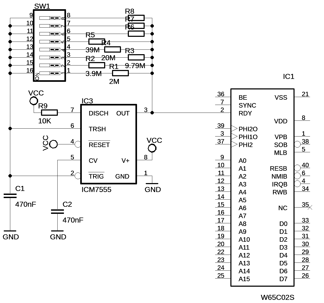

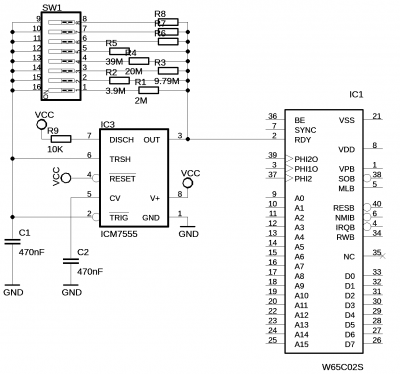

Just to add a small note:
I recently used a 7555 timer (ICM7555IPAZ-ND) that uses just a few microamps of power.
If you want a circuit with an external timer to punch the 65C02 RDY signal, this nicely lines up with WAI to reduce the total system power usage.
You may want to remove the microswitches below, but then again you may want to keep them to adjust timings during development:
