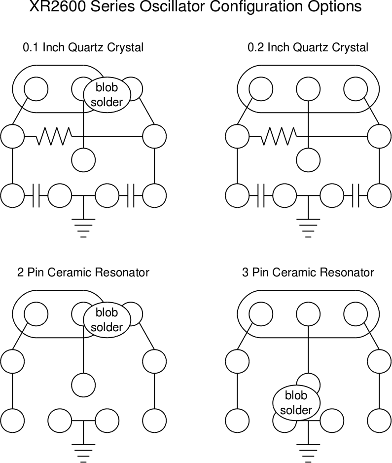

Sheep20 suggested that I should create a daft image for the 20th anniversary. I thought that it would be much more appropriate to design a circuit board which divides pulses by 2^26 in the highly not recommended daisy-chain configuration and displays the values 0-20 in binary. If you prefer, it should be possible to display 0-19 or 1-20. The upper limit is partially determined with one NAND gate in a manner similar to many video circuits described on the 6502 Forum. Furthermore, this leaves a sufficient number of NAND gates to implement GARTHWILSON's preferred address decode scheme.
I designed the 100mm diameter board with many other doohickeys with the intention that boards manufactured in multiples can be used for unrelated purposes. This is very much in the spirit of the Radio Shack X-in-1 electronic experiment kits where X was 15, 50, 150, 160, 200 and probably other values - although, sadly, without the child safe spring terminals. I've included idiot proof indicator lights, LED matrix, H-bridge, inductive loop and capacitive touch panel. The KiCAD 5.x files contain my idiot proofed power connector footprint and my suggested configuration for oscillator which should work with 2 pin ceramic resonator, 3 pin ceramic resonator, 0.1 inch crystal, 0.2 inch crystal or the two most popular sizes of can oscillator.
