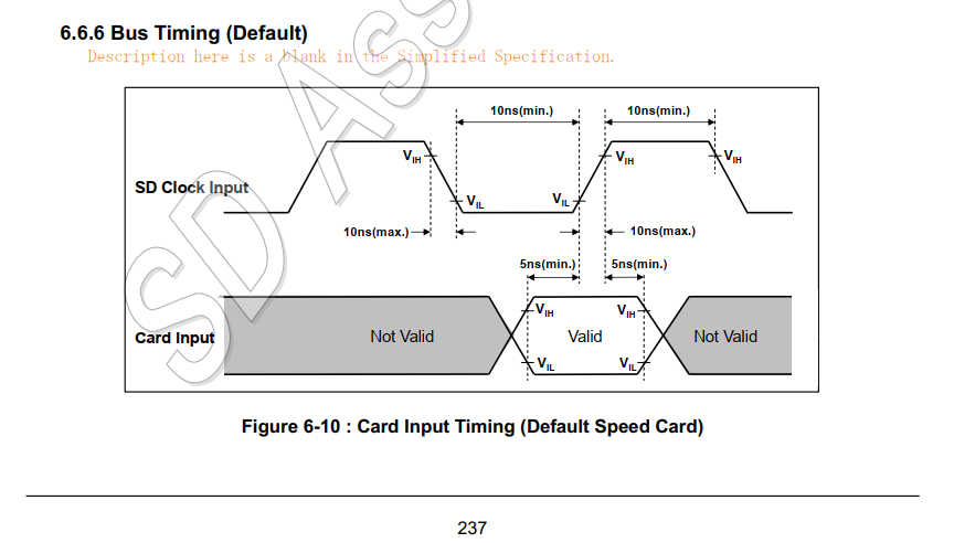

Sometimes I worry about myself. I could have just been normal and used an SD card in SPI mode like everyone. But, no, I had to be special and try to use an SD card in SD mode. Unlike every. single. other. person who has ever posted anything about using SD cards.
So this post falls somewhere between a plea for help and a tutorial on how to use an SD card in SD mode.
The first problem I ran into (apart from nobody at all posting anything about SD mode) is that there are a dozen conflicting datasheets over about two decades; none of which contained the whole story. You might expect the SD card association would be the place to start but the Simplified Physical Layer Specification is three hundred pages. And unless you already know what you're looking for it is almost impossible to find anything in it.
For example: When is data on the CMD line read by the card? Is it when the CLK transitions high-to-low or low-to-high? Or something else? It's on page 273 under bus timings. Like. I. just... Aaaagh
I only found that after a muddy version in a twenty year old SanDisk datasheet that clued me in on what to search for.
Incidentally, the answer is low-to-high. The SD card reads data on the CMD line when the CLK goes low-to-high. And the host must similarly read data on the CMD line (presented by the card) when the CLK goes low-to-high.
