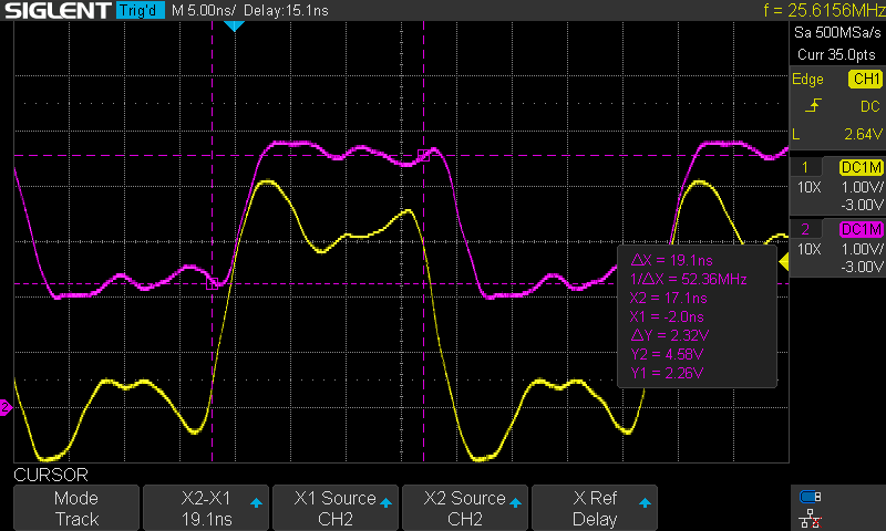

I cannot make it work :(

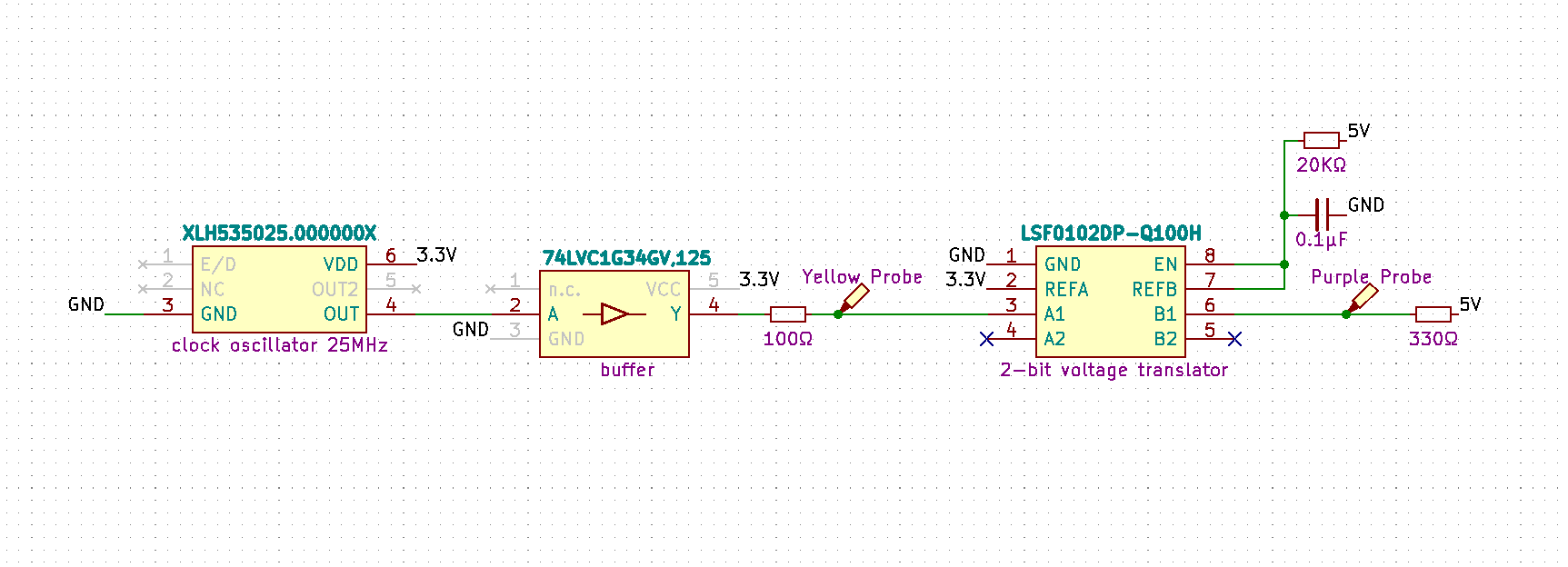

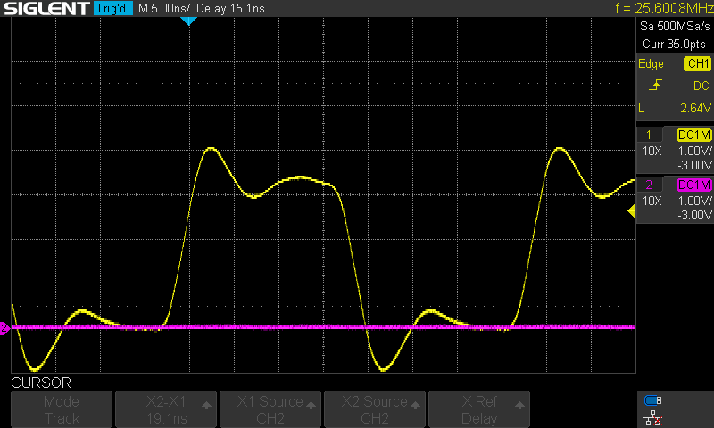

I have a 25MHz clock driving an 'LVC1G34 buffer / line driver jobbie whose output is fed into the LSF0102. That seems a reasonable approximation of what ICs I might really use.
It does terrible things to my 0V line and *still* has a slow rise time.
I mean I can kinda see it trying but I guess the 'LVC1G34 just cannot supply enough current for the 330Ohm pull-up resistor on the output side of the '0102. It does make it all the way up to 4.5V before getting driven back down the logical 'low' of 1.4V.

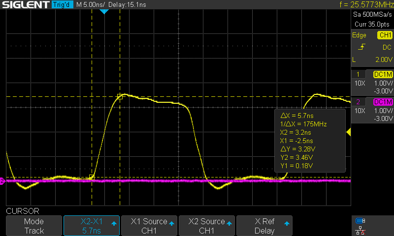

With the 'LSF disconnect I get a pretty decent 25MHz signal from the '34. The slightly slow rise time you see is because the probe is after a 100Ohm resistor that limits current slightly and stops the '0102 (or at least its pull resistor) from flattening the signal completely.
Am I using the wrong device for the job? Can 3.3V to 5V translation with decent rise times be done using LSF ICs? They work fine for slower (sub-1MHz) signals for things like the SNES controllers but it doesn't seem they should be anywhere near LVC circuits...

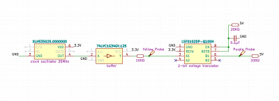

(below the schematic and circuit).

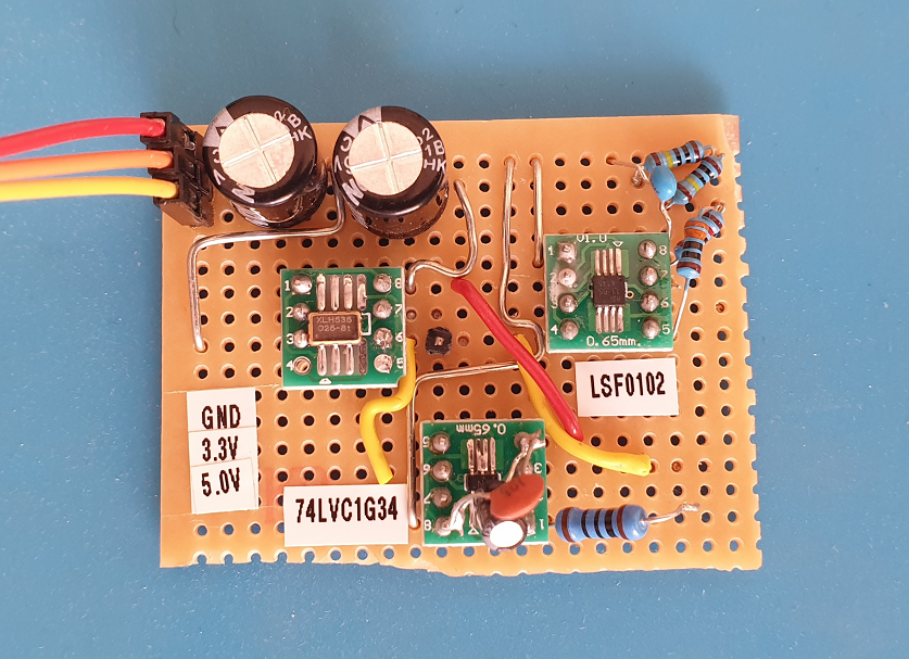

I wonder if those long leads are causing the problem.

Howdy! Assuming the schematic is correct, why do you have Vrefb going through a 20k resistor to +5V? Won't that limit the amount of current that the LSF0102 can drive on its output?
I don't know but I don't thinks so. I originally built this on a breadboard and a got a *very* similar signal that at the time I thought was because of the breadboard and jumper wires. Just to prove I was right and it was the breadboard I then built it on the strip-board you see. But I was wrong. It wasn't the breadboard. This is why I have a gut feeling it's not wire length or the circuit build but something I am either a) misunderstanding or b) that I am using the wrong component for the job.
For what it's worth, I notice TI has a series of videos dealing specifically with these products.

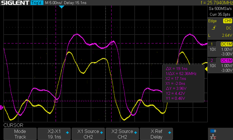

Now this was interesting. I was using a 20K because I found some random circuit on the interwebs that suggested a 20K resistor and a 0.1uF capacitor for the enable Bias circuit.
Watching the the videos Dr Jefyll suggested they really stress that getting the bias circuit right is important (probably why it is now built into the '0204). I swapped the 20K out for the suggest 200K and got this:
Still not great in terms of rise time but notice that the yellow probe low level voltage has dropped from 1.4V to 0.7ishV. I want to use that yellow signal in other LVC devices and if you sort of squint 0.7V is okay.
I think the actual solution is to use a 74LVC4245 3.3V to 5V up translator and put all my signals through it to keep the timings similar. It's basically the '816 and a bunch of 5V tolerant LVC circuitry after the '4245 so in terms of timing and not mucking around with LSF devices this is my best choice. And the '4245 is the same price as the LSF0102 anyway

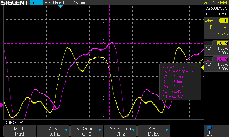

Nope, this is the same circuit as before but with the yellow probe connected to the clock output (and the purple probe disconnected because it was distracting).

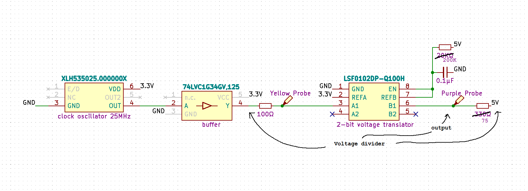

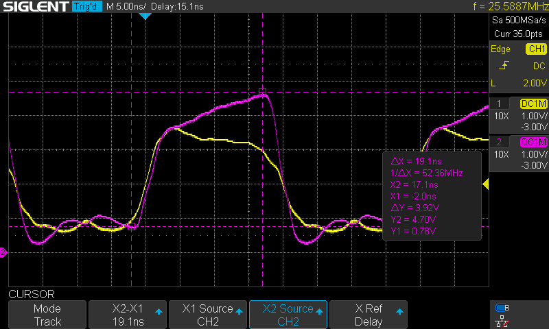

I then fiddled a bit more and had an epiphany. I replaced the 330Ω pull-up resistor with a 75Ω one and got the signals below (yellow is still the same probe on the clock output).
I'm basically creating a voltage divider using the 100Ω and 75Ω resistors (with the potential difference between 5V and whatever the '34 is outputting). The LSF0102 is barely even involved anymore.
I think the lesson here is that anything with pull resistors should not be used with high frequency signals*.
*[EDIT]To clarify a bit. It seems to me that signals through large resistors will change too slowly to be useful and small resistors will stomp all over the small current (LVC) ICs can drive.

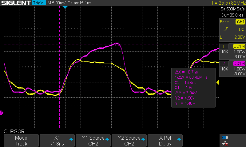

Yup, after a few snags * here are the traces with:
No 100Ω resistor (output of the '34 straight into the LSF0102) and a 330Ω pull-up on the output of the LSF0102.
No 100Ω resistor and a 75Ω pull-up on the output of the LSF0102.
