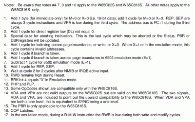

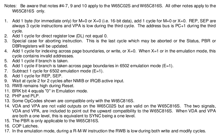

When I started out with the 65C02 I never knew this existed, but Table 5-7 of the WDC 65816 datasheet lists what is on the address and data buses during each clock cycle. I've found this helpful in understanding what's going on as each instruction is executed. I don't think it's fully applicable to the 65C02, but I've used the 8-bit cycles from this table in working with the 65C02 more recently. The 65816 does differ from the 65C02 in cycle timing so this probably isn't perfect in all cases.
If anyone knows of a similar table specific for the 65C02, I'd appreciate a link.
I've been able to get most of the information I needed from the footnotes and the later section on caveats.  At the beginning of the footnotes, it says, "Be aware that notes #4-7, 9 and 10 apply to the W65C02S and W65C816S.  All other notes apply to the W65C816S only."

When I started out with the 65C02 I never knew this existed, but Table 5-7 of the WDC 65816 datasheet lists what is on the address and data buses during each clock cycle....
I don't know of one for the 65C02 offhand, but MOS supplied something similar for the 6502 in the original in Appendix E of the 1976 MCS6500 Microcomputer Family Programming Manual.
