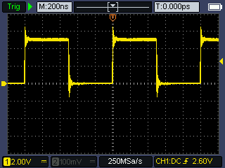

I have a 1mhz can oscillator. On the bench (not in circuit) the square wave signal looks like image 1. If I extend the output pin with a 6 inch piece of wire, it looks like image2.
I'm sure the ringing (is that the correct term?) must matter. How do I clean this signal up?

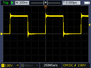

- IMAGE2.png (3.29 KiB) Viewed 3569 times

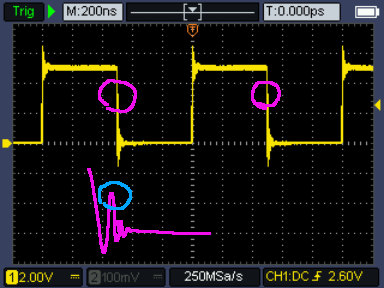

This part here might be concerning, as it's bouncing enough to change states again, long before the processor or something like a VIA would be ready for the next edge:
(The purple squiggle blow is my guess at an expanded view of that ringing edge.) Can you post a photo of the board that produced this?

It'd be worth zooming in to see if that really is happening. But if it is, it is indeed worth doing something about.
Slowing down the edges will help, as will having good ground return.
Note that what you see on a scope isn't what's happening - the scope has limited bandwidth, the probe has its own characteristics, and the ground path you put in place for the probe will also have a big effect. Make sure you've adjusted your probes correctly ("compensated" or "calibrated" them) and consider using the twirly spring tactic for grounding the probe.
https://electronics.stackexchange.com/q ... und-spring
Also, it will matter what the clock is driving - what kind of load. Your clock driver should be appropriately sized for the load, so the edges are adequately fast for correct operation but not as fast as possible.
You probably won't need to add resistors at the near end or the far end, but "terminating the line" is a term that you might come across.

One thing that might be helpful is to tell us why you’re asking. The ringing you see could just be an artifact of the way you’re measuring it (as Garth mentioned), and so it isn’t necessarily something worth worrying about unless it’s causing problems.

I saw no mention of the presence or absence of a bypass capacitor at the VCC and ground pins of the oscillator. I also didn’t see anything describing the robustness of the VCC and ground connections. Also, how about loading? All of these are factors that will affect signal quality, or lack thereof.
As the others implied, you may be seeing a problem that doesn’t actually exist.

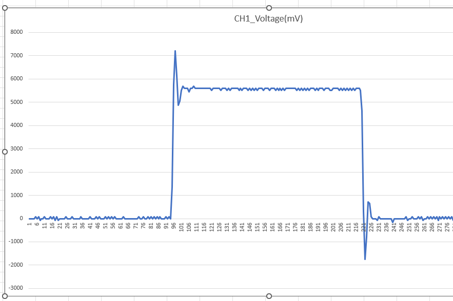

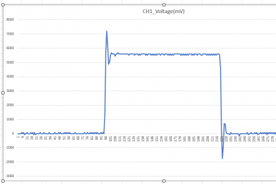

Here is a zoomed in graph (Sorry, I pressed the wrong button on my scope and got an excel file - so I graphed it). Perhaps I am indeed worrying too much - it probably isn't bad enough to change states. Do you agree?
By the way, there is no board that produced this graph. The can is on the bench (okay, kitchen table!) with +5v, GND, and the scope probe attached - and I have checked the calibration of my probe.
I ask because I have been having problems with the SBC that this oscillator is normally part of. (See: viewtopic.php?f=4&t=2029). Before I take it all apart and start again I was casting around for other possible causes of the wierdness I am getting with interrupts. I decided to start a newbie thread as a) I am a newbie in this area (analogue electronics) and b) I thought it sufficiently off topic to start another thread.
BigEd, please could you explain in a bit more detail (remember - analogue electronics dummy here) what you mean.
"Slowing down the edges" How?
"What its driving". It isn't driving anything as per the graphs above - the can is powered and has a scope lead on the output - it normally drives a 65C02, 65C22 and 65C51.
"You probably won't need to add resistors..." I read an exchange between someone here and an expert (I forget the name) that went into series resistors but firstly, I didn't fully understand a lot of it and secondly, they didn't go into a lot of explanation. Could you explain how its done and why please.

...it's bouncing enough to change states again, long before the processor or something like a VIA would be ready for the next edge:

My understanding is what drives a lot of noise and ringing in digital signals is the rate at which a line switches from one state to another—that is, the slope of the transition edge—independent of the clock at which the circuit is running. This topic has been covered extensively in the forums, and so you can find a tonne of information just looking around (for example, that URL you posted above). You can slow the edge (that is, decrease the slew rate) by adding a resistor in series between the clock circuit and the load; however, you want to be careful not to violate the CPU's maxima. FWIW, in my very limited time playing around with the 6502, I've never had this problem even at much higher speeds, and I'd be surprised, based on what I've read, if this were the cause of the problem you're experiencing. Here's a thread on StackExchange where this is explained.
The thing is, I think most of these answers are based on addressing the behaviour of the clock signal in circuit, which is really not the condition you're testing under… so I suspect you may be going down a bit of a rabbit hole
I hope this helps (and is not too wrong). Cheers!

The kind of "ringing" you are seeing on the clock transitions can be caused by a long scope lead ground and the lack of supply bypassing. You need to understand that there is a lot going on here that might not meet the eye. For instance, the can oscillator might only be a 1MHz frequency, but that is just the clock rate. The leading and trailing edges of the pulses rise and fall at a rate that could represent frequencies in the 100s of MHz range. Further, being able to switch that fast means there will be a considerable spike in current draw when the transitions occur. These will need some local energy store to satisfy. We refer to this as bypassing the supply and it's normally done with one or more small capacitors (~0.1uF). So, adding a bypass capacitor and shortening the ground lead on the scope wire (do you have a whisker ground lead?) will go a long way to cleaning up the signal.
