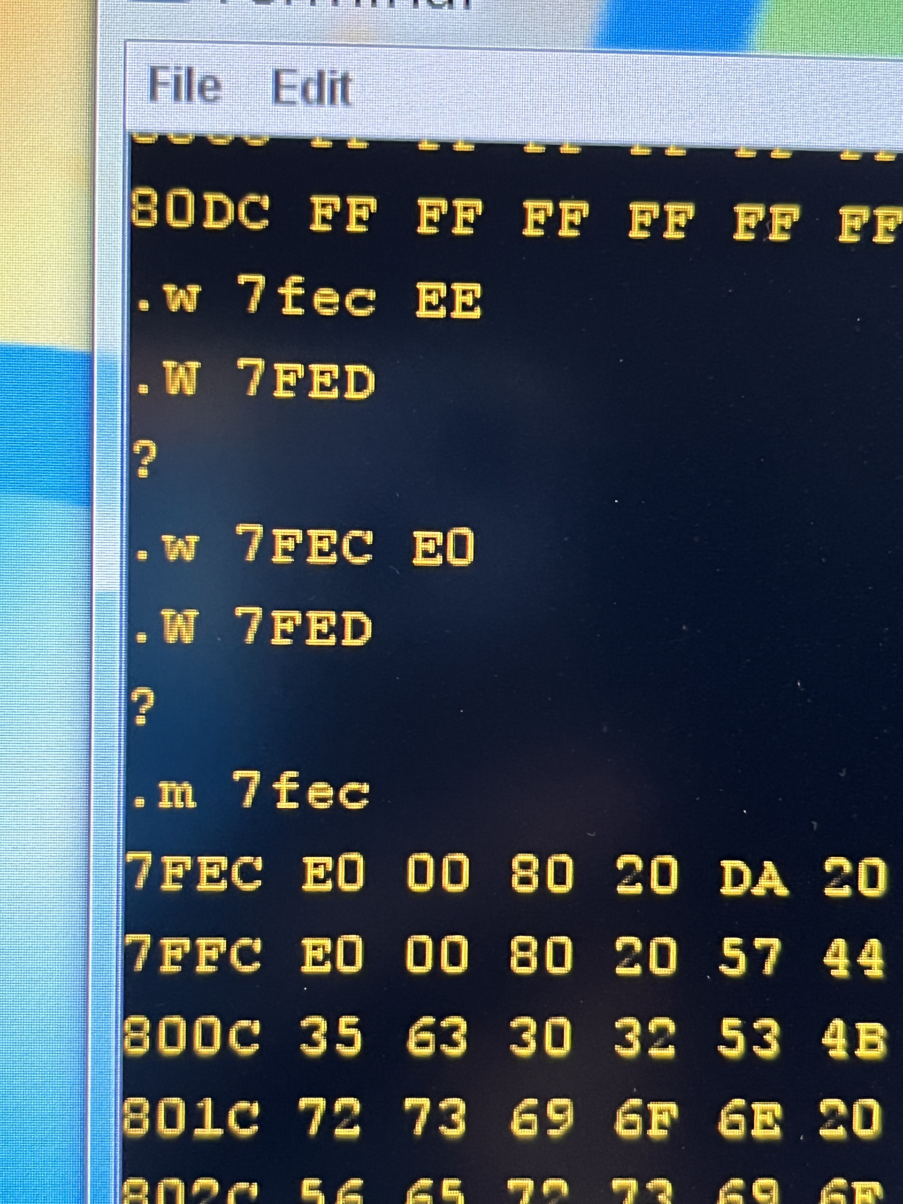

Page 13 has the tables. It looks like your 7 needs to be an E in the most-significant digit.
Re: 6522 Peripheral Control Register - setting CA2 and CB2 h
What a newbie mistake LOL, I mixed up 0111 with 1110.
Anyway even after using the correct values, I still didn't get any response, at least not with the LEDs.
The monitor did show the memory location was changed.
Experimenting with this board really is not simple...

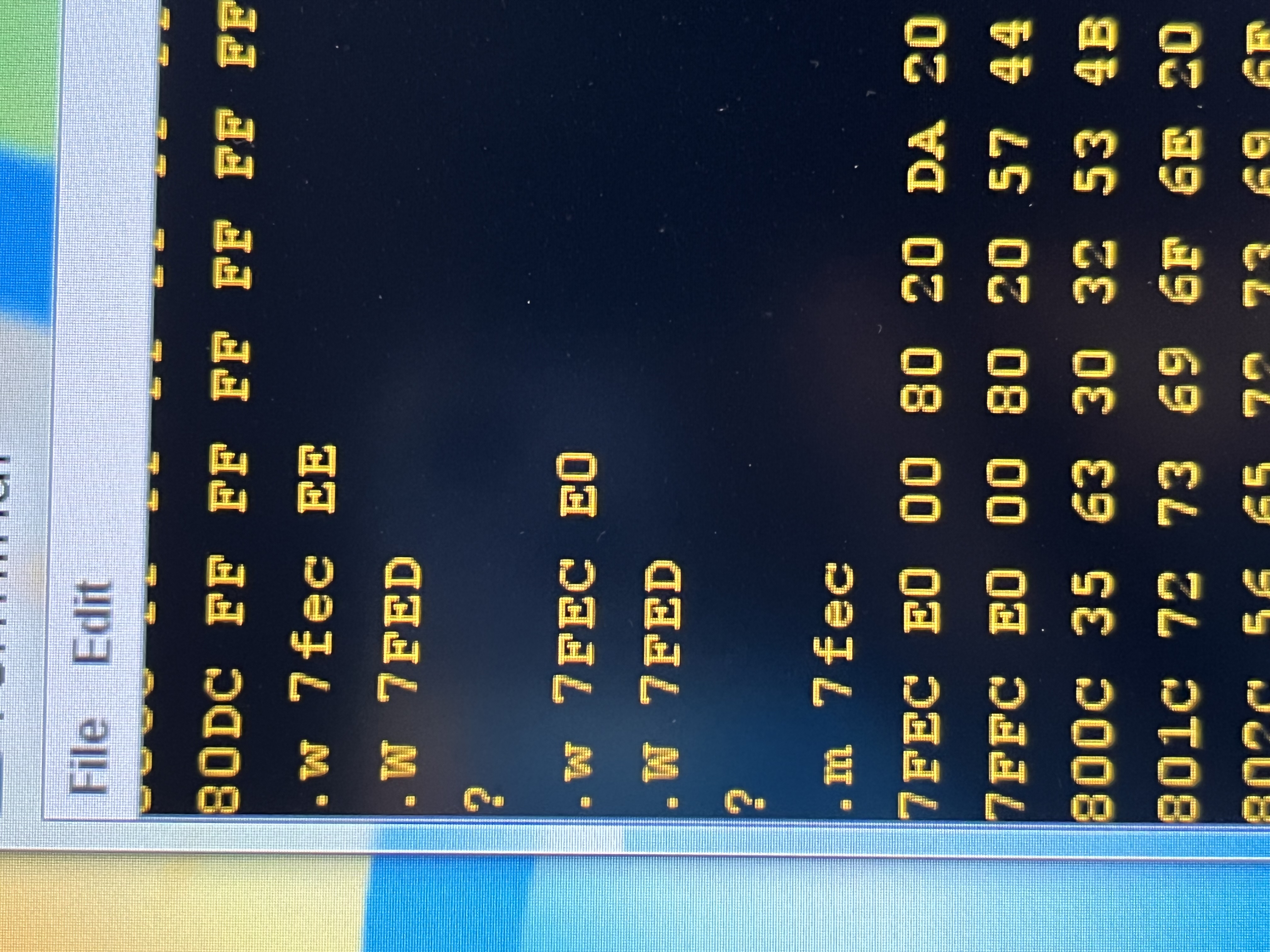

(I don't know why the JPEG is always posted sideways, I had already tried different ways of holding my phone, or editing the file afterwards. I can't take screenshots using the OS because my Windows 7 install is locked down for safety, no network, nothing).
(if you have a simple tool to edit the photo, try rotating 4 times and re-saving.)
(WOOT!! Haha! Did it with Preview on the Mac).
Anyway, no action on the VIA_TIDE.
I was thinking of various possibilities:
1) the board has a problem (i.e., mine has a manufacturing problem, but probably unlikely)
2) there is something wrong with the Java monitor I am using (although the memory locations seem to be edited properly, and I could write a simple program to load the Accumulator).
3) I need to test using the OTHER 65c22.

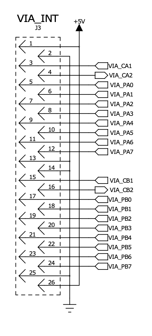

For testing the other VIA, called VIA Port, I need to have some feedback. Since I can't trust the on-board LEDs now, I want to check the pins. The second VIA's pins are exposed via a connector. (The VIA_TIDE has no such access, so I could only hope for the on-board LEDs action.)
I attach the relevant parts from the schematics.
However, for CA2 and CB2, does the rightward-pointing "thingie" mean VIA_CA2 and VIA_CB2 are hardwired to be inputs only? Pins 4 and 16 on the connector schematics for VIA_INT
