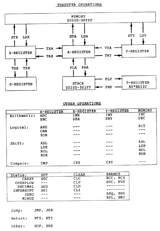

Added to that conversation, a pointer to this neat diagram by Bob Sander-Cederlof entitled "The 6502 Programming Model"
Edit: see below for an ascii version, and see also here for an update and here for a 65c02 version

That's a good way to diagram the loads, stores, and transfers.

I liked Bob's diagram so much I re-entered it:
                         TRANSFER OPERATIONS
 |                             MEMORY                              |
 |                           $0000-$FFFF                           |
     STX  LDX                 STA  LDA                 STY  LDY
      |    V                   |    V                   |    V
 |              |---TXA-->|              |<--TYA---|               |
 |  X-REGISTER  |         |  A-REGISTER  |         |  Y-REGISTER   |
 |              |<--TAX---|              |---TAY-->|               |
     TXS  TSX                 PLA  PHA
      V    |                   |    V
 |              |         |              |---PLP-->|               |
 |  S-REGISTER  |         |    STACK     |         |  P-REGISTER   |
 |              |         | $0100-$01FF  |<--PHP---|   NV*BDIZC    |
                           OTHER OPERATIONS
 |               A-REGISTER    X-REGISTER    Y-REGISTER    MEMORY  |
 |  Arithmetic:  ADC           INX           INY           INC     |
 |               SBC           DEX           DEY           DEC     |
 |  Logical:     AND           ---           ---           BIT     |
 |               ORA           ---           ---           ---     |
 |               EOR           ---           ---           ---     |
 |  Shift:       ASL           ---           ---           ASL     |
 |               LSR           ---           ---           LSR     |
 |               ROL           ---           ---           ROL     |
 |               ROR           ---           ---           ROR     |
 |  Compare:     CMP           CPX           CPY           ---     |
 |  Status:      SET           CLEAR         BRANCH   |
 |       CARRY   SEC           CLC           BCC, BCS |
 |    OVERFLOW   ---           CLV           BVC, BVS |
 |     DECIMAL   SED           CLD           -------- |
 |   INTERRUPT   SEI           CLI           -------- |
 |        ZERO   ---           ---           BEQ, BNE |
 |       MINUS   ---           ---           BPL, BMI |
    Jump:     JMP, JSR   -------------------------------------------
                         6502 Programming Model, Bob Sander-Cederlof
    Return:   RTS, RTI          Apple Assembly Line, May 1981
                         http://txbobsc.com/aal/1981/aal8105.html#a4
    Other:    NOP, BRK   -------------------------------------------
