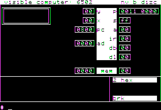

Looking into ways to respond to this unanswered question, I spun this up(*) in KEGS, which is a IIgs emulator.
As a teaching tool and document, I think it's well done. It takes things slowly: by page 40 you're stepping through
  LDA #$33
in the individual actions of
Fetch: PC -> AD
           Read
           DL -> IR
LDR Immed: INC PC
                     PC -> AD
                     Read
                     DL -> A
                     Cond Flags
                     INC PC
but it does start off at a gentle pace - the opposite of Ron's Assembly in One Step which doesn't slow down to explain the reasons for registers or memory. Also, there's the obligatory chapter on hex. So page 40 isn't so far in.
(Those individual actions are not, in reality, sequential. As groups of actions they don't correspond to clock cycles. But the educational value is there: I'm sure seasoned educators know when they need to be technically 'wrong' in order to get the lesson 'right')
It's unfortunate, in this case, that the KEGS emulation is so accurate that the hi-res graphics have the green and magenta pixels faithfully reproduced - it doesn't help the clarity.
(*) At one point, I ran up the 32-bit windows executable in WINE on my 64-bit linux. That's 2 emulation layers(**), with both the intel and 65816 processors working in backwards compatible modes. In fact ... this is a BASIC program, which means there's an interpreter too.
(**) Not 3, because WINE is not emulating program code, only OS calls.
On an actual IIgs there's a way to make hi-res graphics monochrome. I don't remember exactly how you do it (nor do I have a IIgs accessible at the moment to experiment), but you could try this (all writes are in 8-bit mode):
LDA #$20
TSB $C029
(You can undo that with TRB). You may need to do this too (I seem to recall this being a two step process):
STZ $C05E
(It does not matter what value you write. Use STZ $C05F to undo.)
A quick look at the IIgs softswitches (i.e. I/O locations) suggests this:
LDA #$80
TSB $C021
...but that doesn't look right/familiar to me. Anyway, you could try various combinations and see what happens.
This was a little-known/little-used feature, so an emulator may or may not support it.

Ah, top tip!
It seems that KEGS does know about that. I have no way to poke any locations or any easy way to take control, since this program runs from a boot disk. But it turns out that kegs can be invoked in '-bw' mode which does the trick:
Much more readable!
I was considering trying to take a memory dump from KEGS and seeing if I could feed it into this javascript apple2 emulator, but I can stop thinking about that now!
