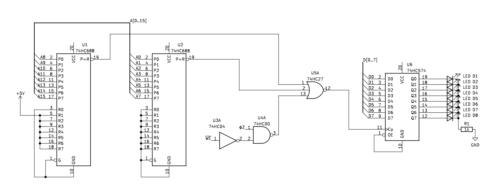

Here, the outputs of U1 and U2 will both be low when you read or write to $FE00. When /WE is low and ɸ2 is high, the output of U4A will also be low. Feed everything into U5A, and it will output a high when you try to write to $FE00, which will latch your '574 to pick up data from the bus. (Please note: I'm very much a newbie, and this is untested, so it might not be right
Another option is to use a 6522; this is more expensive than a handful of discrete logic chips, but it'll be much easier to wire up. At some point or other, you will probably want to use a 6522 to handle I/O in your design anyway, so you might as well get a leg up on figuring out how it works.
HTH!
—Marco
Edit: I had U1 and U2 wired backwards to the bus. Fixed!

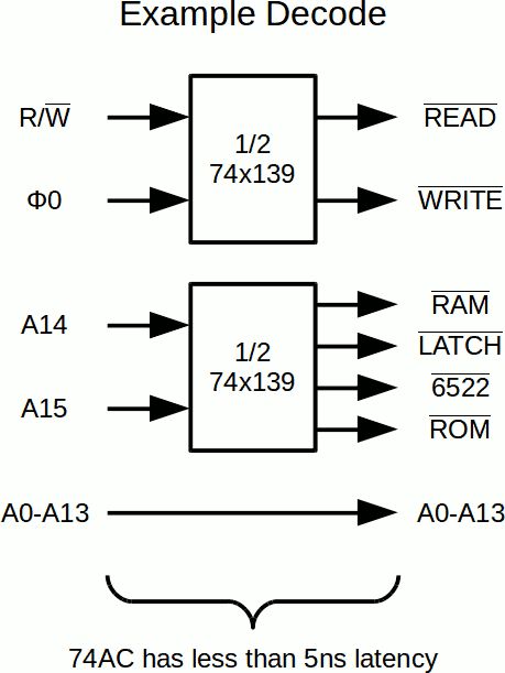

After you have taken 6502 from your NOP test breadboard, it is possible to make a very flexible memory map using one 74HC139. One half of the 74HC139 may provide read/write signals suitable for Output Enable/Write Enable signals of RAM or ROM. The other half of the 74HC139 may provide 4*16KB address decode. For your experimentation, this may be 16KB RAM, 16KB for one or more output latches, 16KB for one or more 6522 chips and 16KB ROM. (This arrangement may be expanded or quickened with minor substitutions.)
If you don't mind bus contention, it is possible to place multiple 65xx peripheral chips within one I/O segment. To achieve this, connect all 6522 active low chip selects to output 2 of the 74HC139. Then connect A4, A5 and suchlike to individual 6522 active high chip selects. Within 16KB I/O segment, it is possible to connect up to 10 6522 chips with no further hardware. (Yes, this is 200 GPIO.)
When your experimentation has progressed, you may substitute your output latch with more RAM. In this case, your memory map would be 16KB RAM, 16KB more RAM, 16KB for one or more 6522 and 16KB ROM.
