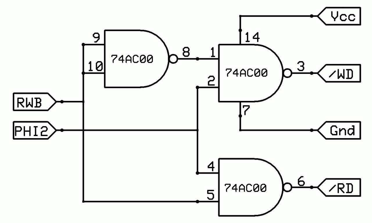

So, how in the world does one properly set up /OE, /CE, and /RW for, say, a bank of 32K of ram (70ns or 55ns, for example) - just as an example?

But, what wires connect to /OE and /CE (or /CS) on the chip? I.e., what wires get connected to Output Enable, Chip Enable, and, I guess, /RW?

Okay, but I can’t propose anything until I have some idea as to what I’m to connect to /OE, /CE, and /RW. That is still unclear. Once I have that piece, I can draw-out the rest. J

So, typical SRAM chips have /OE (which is Output Enable), /CE (which is Chip Enable) and /WE (which is Write Enable). There is no /RW in general, but the 65XX CPUs have a R/W, which is single line which is High when in Read and Low when in Write mode. BDD has given you the classic schematic for generating qualified /Read and /Write signals from the single R/W and Ph2 clock lines.
So, /OE is reading from memory, /WE is writing to memory and /CE is selecting the memory chip.
/RD gets tied to /OE
/WD gets tied to /WE
your address decoding select output gets tied to /CE

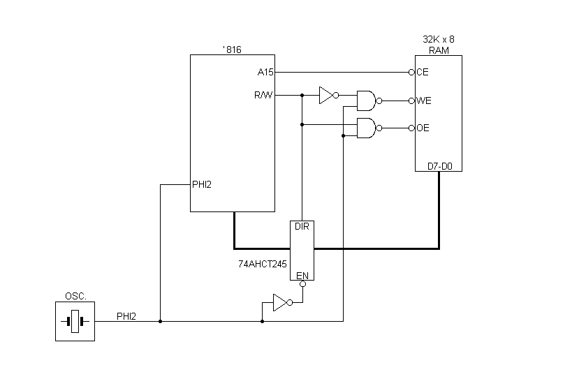

Alright, here's a bare-bones schematic, based on the discussion above.
I've added a '245 transceiver, which is optional in this case but still recommended. Because the '245 is only enabled during Phi-2 high, it satisfies the requirement I mentioned earlier about no external devices driving the 816's data bus during the Phi-2 low time. That requirement is also satisfied in this case by the "glue" -- notably the way /OE on the RAM never goes low except during Phi2 low, so in that sense the '245 is redundant, but it earns its keep in other ways, making for a more forgiving and easy to get working system (especially when ROM and I/O are considered).
basic 816 glue_.png (5.06 KiB) Viewed 3660 times
Edit to the diagram: remove inverter between A15 and /CE,
Sorry for the earlier terse post. My wife called me to dinner right as I was posting and around here, a juicy chuck roast with corn-on-the-cob has priority over computers. :D
Kevin explained what /RD and /WD in the read/write generator do, so I don't need to add anymore to that. The illustrated circuit is what I have used in my POC units up through V1.3. Using it with your SRAM and ROM will assure that those devices don't attempt to drive the data bus during Ø2 low when the 65C816 is emitting the bank bits.
Also, Ed pointed you to Jeff's timing tutorial, which can go a long way in shedding light on how clock performance can affect overall system performance.
I see Jeff sneaked in while I was posting. :D Note that in his circuit the 'B' pins of the transceiver must "face" the MPU. The transceiver will help with bus contention, as well as efface some of the effects of bus capacitance. Plus if you use a 74xCT type transceiver, it will act as a level converter, accommodating typical SRAMs, which have TTL-level outputs.

Alright, here's a bare-bones schematic, based on the discussion above...
I'm a little confused. If SRAM is to be selected in the range of $0000-$7FFF, there wouldn't be a need for the inverter connected to the RAM's /CE input, correct?
Posts: 3526
Re: Simple Question: 65c816 Memory Decode Logic
You're not confused -- I am. Distracted posting. My bad. I'll fix it. :oops:
Posts: 9428
