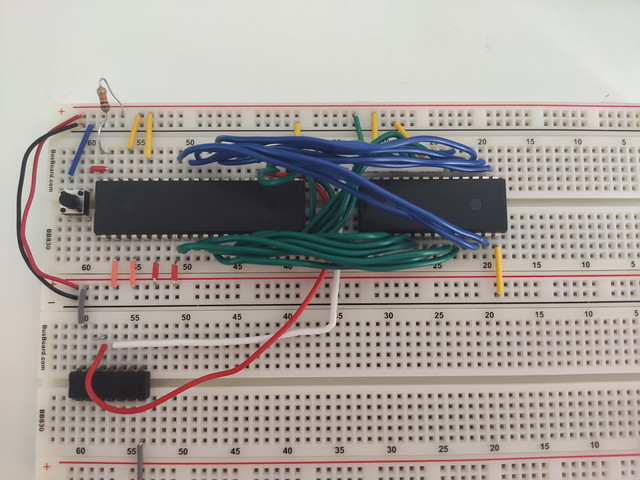

I'm currently following Ben Eater's tutorial on 6502 Hello world programming and I'm facing an issue with the STA instruction
It seems that sometimes, the STA doesn't execute itself and I don't know why!
This is the kind of output I get:

Any idea how I can debug this?
Edit: I'll add a picture of my setup, even though it's not very tidy
