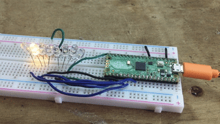

I recently received a few raspberry pi picos!
My original idea was to use one of them as a VGA output for my 6502 computer, but that did not really work out.
So I took a different tack about what to do with them and decided to run a 6502 emulator. The I/O is very simple and goes through the Pico's USB to serial capability.
For the emulation code, I started out with this and added support for 65C02 instructions to be able to run Taliforth on it. You can also choose to run it in 6502 mode by changing one #define statement.
It passes all of Klaus Dorman's 65C02 test suite.
I then added 6522 support from this repository.
And putting it on a breadboard, we get some blinkenlights !
While running the tests, I get about 3.1 MHz of emulated speed if I overclock the Pico to 280 Mhz. That seems fairly slow, so I've been looking at Daryl's code for an ARM assembly 6502 emulator. I have absolutely no experience in ARM assembly though, so it will be a while before I can try and rewrite the emulator in ARM assembly that is compatible with the RP2040 microcontroller... If we go by Daryl's result (ARM: 900 MHz -> 6502: 97MHz) I should be able get more than 25 MHz 6502 emulated speed out of the Pico!
Here is the github repo if anyone is interested : https://github.com/jfoucher/pico-6502

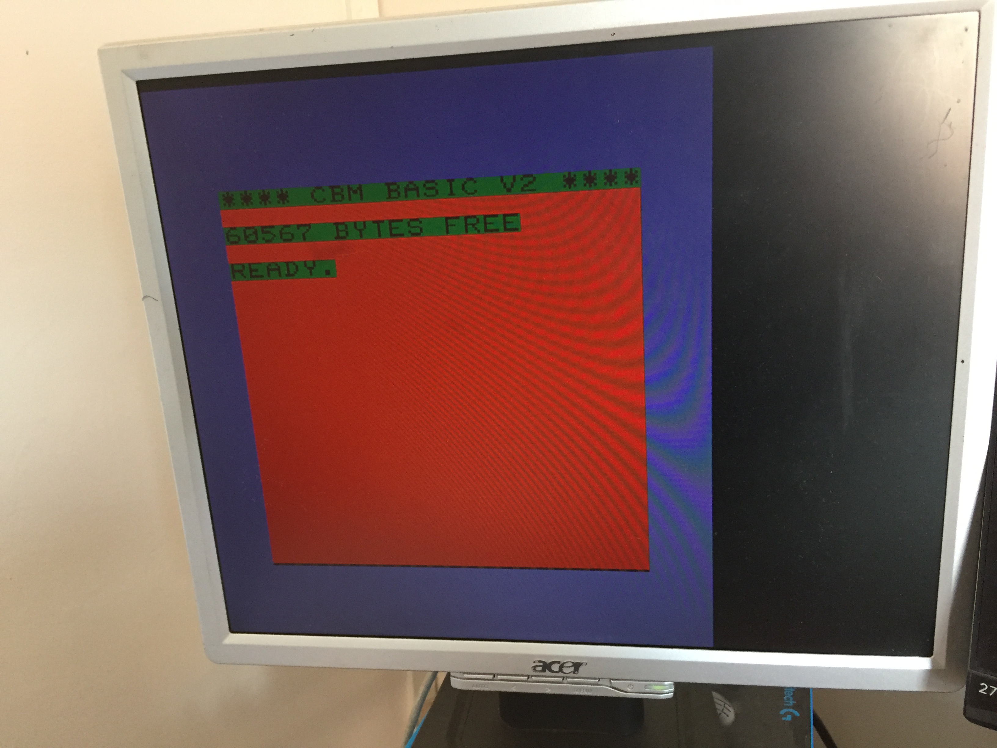

I have changed many things on what I do on the pico, it now runs a simplified VIc-20 emulator using Dominic’s 6502 core. The Vic chip is extremely simplified and most registers don’t do anything. The vias are not emulated. All this in the interest of speed and laziness. ATM it runs at around 3-4 MHz
Also the colors and the screen scaling are all wrong but at least it runs basic!
